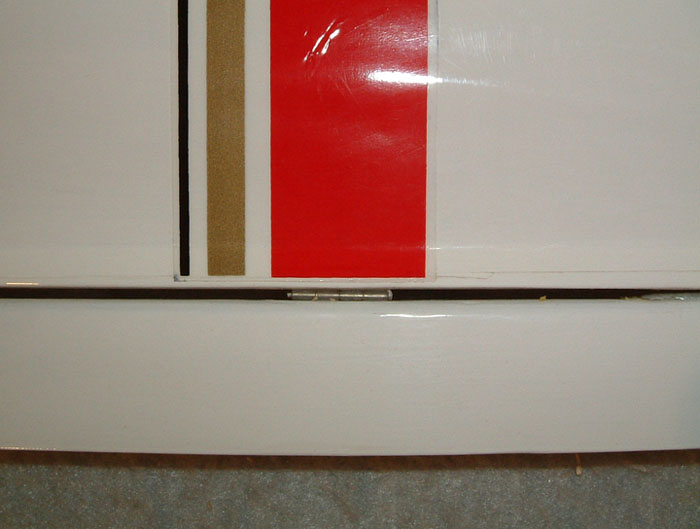

need advice fellow modelers,
i know i have seen it here before but cant find it. currently finnishing aw edge 29%, one of the aeilerons has a slight gap between t.e. of wing and aeileron, i was thinking of just sealing the hinge gap rather than trying to cut out the
already installed hinges. need tips on how to seal hinge gap.
the gap i am speaking of is about 1/4".
thanks in advance!!!

Beckerfly, a 1/4 inch is more that a "slight" gap. I would recommend redoing the hinges. You can use a variety of materials to seal the gap including Scotch tape, Monokote and it's variants and several companies make specific hinge/gap sealing tape (although names escape me). But do it over...you'll feel better in the long run. Then seal the gaps anyway.

thanks for the reply, not what i wanted to hear but kind of what i thought, is there an easy way of re-doing this??? i am using the dubro heavy duty hinges.

Well if the hinges are CA type simply slice thru them, make new slots nearby and reinstall new ones. Pinned hinges will be more difficult to remove. You will need a saw blade thin enough to fit in the gap and saw the hinges out. Sand smooth any protrusions left from the cut and install new ones 1/2 inch or so away. It won't take too much longer than sealing the gap. Take your time and be careful, it's really not a big deal.

thanks for the replys, last night i took a new exacto blade and ran down adjacent to either side of the hinges and was able to remove them. opening the slot for the hinge only slightly. now with the pacer hinge glue i am using do you think i can go back into the same slot??? i am using the dubro h.d. hinges.

Are the new Dubro hinges a snug dry-fit in the existing slots? If not, make new slots. Do NOT expect excess glue to compensate for oversize slots.

As Vinnie says, if they fit well, you can use the existing slots. I strongly recommend you "pin" the hinges in place with 1/8" dowel (or two toothpicks) on the wing and on the control surface. They will ensure the hinges will not pull out.

I don't know why you want to mess with the old hinges just cut them off and get rid off as much as you can and start installing hinges next to the old ones. I highly recommend Robard point hinges specially for a 1/4 scale plane , definately not CA hinges. I lost a plane when in a DuBro type hinge the center pin worked itself out INFLIGHT due to vibration. If you ever use this type of hinge make sure to check them before each flight.

foxx and cafeenman thanks for the replys after spending 2 1/2 months of building i sure dont want to loose a plane over a stinking hinge. i will purchase the robarts tomorrow, cant do anything about the elevator which is already done but the aeilerons and rudder is still in progress. plane is already covered are the robarts difficult to install???

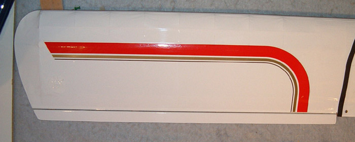

I read a lot about it in this forum but i never seen any picture and this is only my second kit i build. I have included a picture of my work. Can anybody tell me if the gap is too large. I don't know if it's ok or if it should be sealed ??
This is a wing of Mid-Star 40 from SIG.
If anybody can post a picture of sealed hinge with monokote that would be nice.

Bidule - that gap isn't horrible, but it's not great either. You should seal it to make the surface more efficient and also to help prevent flutter.
Whatever you do, make sure that the linkage can't flex at all.
Check out this page. The flaperon hinges are actually Oracover, but it would look the same if there were "real" hinges underneath.
http://www.airfieldmodels.com/great_gonzo.htm
To seal the hinge, remove the linkage, move the control surface to a full up position and then iron a piece of 1" wide or so monokote (or other film) to the wing and the aileron. Takes all of 15 minutes for both surfaces.

Bidule, if you want to see what a difference sealing the gaps would make, take some clear tape (like scotch or packing tape)and seal the length of the ailerons and the elevators, then go fly it. If you like the new responsiveness, then seal them as the others have prescribed. Sealing those gaps make a difference even on trainers.

when sealing the gap after cutting film to proper length and width do you crease it long ways down the center then iron?? i appreciate the pictures but dont see how the control surface will deflect if done on both sides, or do you just seal one side??

Bidule, cut your film to the correct length, then crease it lengthways. Lay the film into the gap and flex the control surface the opposite direction (remove the linkage for maximum deflection). Iron the film into the gap (I usually do the fixed portion side first and then the control surface).
You can seal both sides of the gap, but usually only one side is neccessary, ie., you can seal the bottom side and get most of the effect. If you do both sides, the second side is generally for cosmetic purpose (hides the gaps and hinges). Hope this helps.
A lot of guys here have the procedure illustrated, (I know Minnflyer did) and you can do a search for sealing hinge gaps.
