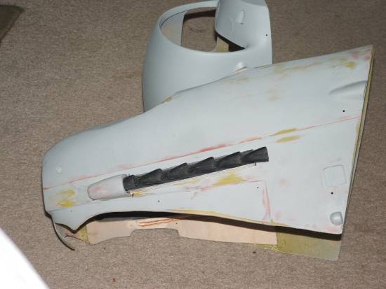

I made these bumps/blisters from balsa, then glassed them.
ID:	698664   Click image for larger version
ID:	698665   Click image for larger version
