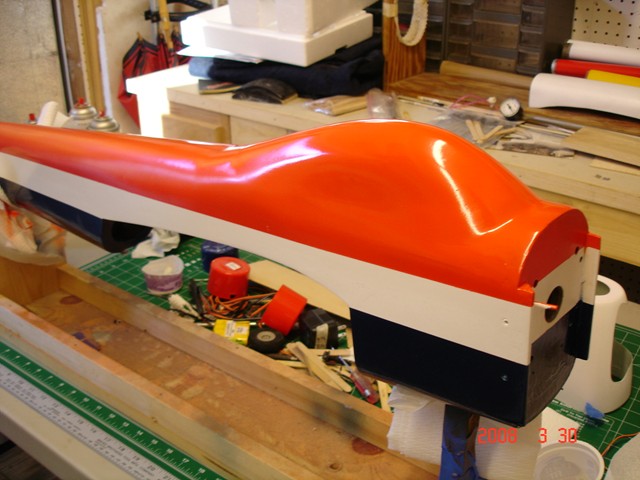

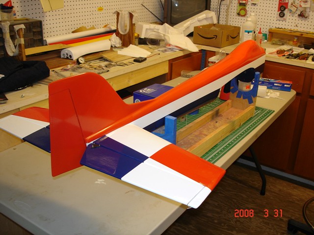

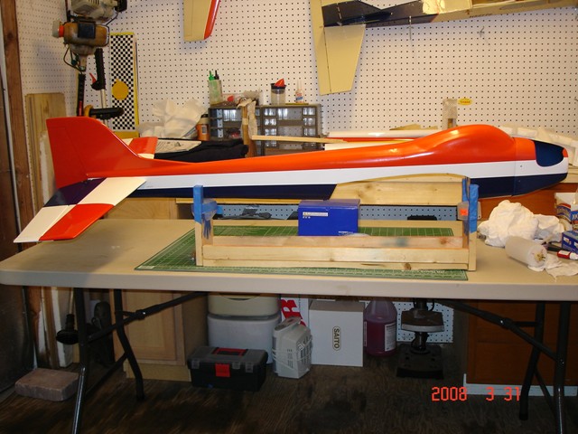

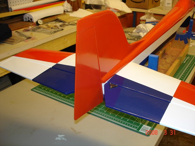

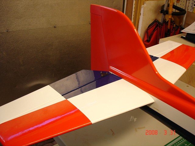

You guy's are painting in too much humidity. I am in south Florida, the humidity capital of the world. I use Lustr-Coat and do have the same problems. It has to be good warm sunny day, best aroud 2:00 PM. Good prep, and only spray on light coats to finish.
You can go heavy on the last coat. When you get the blush, which is the white talked about, let it dry. Wet sand this with #2000, then hit is with clear coat. Do not get in a hurry with this type of paint. One area to pay attention to, is to let the can's sit outside in the sun for about an hour before painting. If you are taking the cans from an air-conditioned room, then outside to spray, that is a problem. Get the cans up to temp, same as the outside. Attached a few pictures of Lustre-Coat painting.
The wing and stab in this Intruder is MonoKote.
