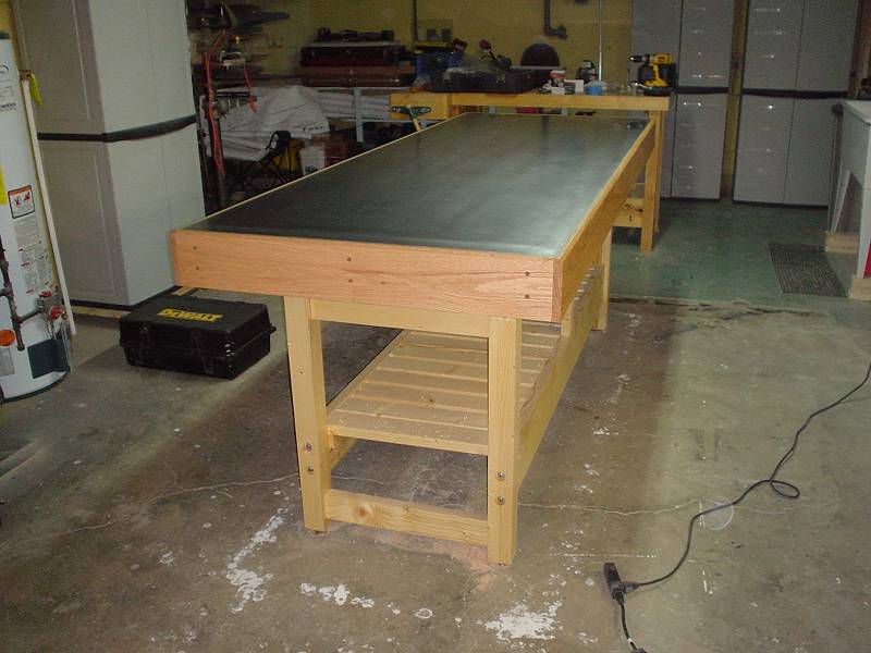

As referred to in my other thread, [link=http://www.rcuniverse.com/forum/m_6400470/tm.htm]Lazy mans large, portable building table[/link] I have made some decent progress in making my magnetic building system.
The blue top on the building table is a piece of 22 gauge steel, primered and painted with Rustoleum spray enamel. (Safety Blue)
The metal top was pretty straightforward, I rounded the corners, deburred the edges, and spraypainted. I coated the underside of the metal with marine grade upholstery vinyl to protect the table surface from scuffing. I used 3M 77 adhesive.
I have finally finished making the wood for the fixtures, as seen in the second Photo. I have not assembled the magnets yet. This is an example of the types I made. As you can see, along with the standard 4 magnet fixtures, I branched out and made some two magnet fixtures to fit into tighter areas. These things are a pain to make, so I made a BUNCH since I had all the setups and jigs made and ready. I don't want to go back and have to make some extras later.
The third photo shows the full amount of fixtures made. Not all will be assembled, as some are for spares.

Nice job on the table. You'll love the magnets!
I built mine about a year and a half ago, full torsion box, but yours looks just a strong. Building is so much easier now. I also installed a metal strip to the bottom of a joist at theend of the table. I use it for a magnetic laser that I hang inverted. Shooting the laser down the centerline on a fuse is a great way to insure a straight layup.
The last picture is a 40% Pitts model 12 I'mworking on. Overall table size is 3' x 8'

Here is an update on the table.
The 22 gauge steel held the magnets pretty well, but I found out it was not real stable. It developed a wave in it that I could not get out. Bummer after all the work prepping and painting it.
Anyway, I went back to the metal supplier and had them shear a piece of 16 gauge 400 series magnetic stainless steel. Cost was $115.00 for the entire 4 X 8 sheet and shearing. The stuff is MUCH cheaper than other grades of stainless (since it does not contain nickle). The others run around $300 for a 4 X 8 sheet. I took it home and deburred the edges with a smooth file, and left the corners 90 degrees.
It is working out real well. Narry a wave to be found. The magnets hold well enough. I used a trigger scale on a magnet and tried it on the stainless and the mild steel, and got a couple of grams more hold on the stainless.
I have found the steel weighs close to 40 lbs, but that is still within the area of me being able to lift without strain. I just use work gloves to protect the hands.
The only problem is keeping brushed stainless clean looking. I feel like I have a Delorean to clean. I will be using plan saver plastic on it. Here's some pics.

After 4 1/2 years of use for modeliing and various woodworking stuff, the table is still flat as the proverbial pancake. Heavy items such as spindle sanders, drill press, several large boxes of books, etc get left on it to sit for up to several weeks at times. It has never changed in stability. It also spends time leaned against the wall out of the way. No effect.
This design works perfectly.
I did find that going to the local fabric store and buying blue upholstry vinyl was a perfect cover for the stainless steel when I work on other projects or anytime I am not actively building with magnets.
