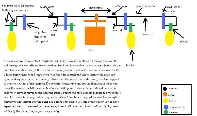

people have been asking me for my set-up for my planes with 4 bombs and i decided to sketch my design i also listed it in building forum any questions e-mail me
