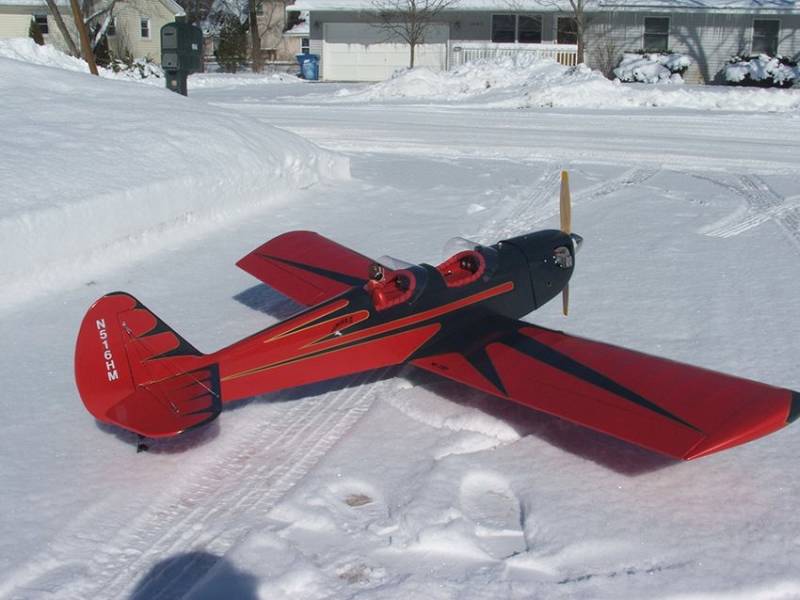

I used paint from Nelson Hobby Specialties, http://www.nelsonhobby.com/, on my Spacewalker II. I sprayed mine, but it is a brushable product.
It dries quickly, with water clean up.

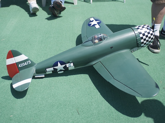

no one has mentioned www.warbirdcolors.com paint its water based which works well if you kow how to use it, hardly any smell, plenty of colors, and it really is durrable, its a catalized urathane,and cleans up with water.
I dont know if you have used the preval sprayer, but in general they suck, I have sold many of them,generally mixed to poor results,I worked in a paint store for 3.5yrs and have been painting for a couple of decades,
you might as well buy a inexpensive airbrush and save yourself the headache, you can also use it for many other projects in the future, than a one shot device that can be troublesome at best,and expensive after you buy the air canisters.
after doing several models using regular latex and WBC paints I am over the stinky,toxic thinners, and disposal issues, that come with the other types of model paints out there.
a couple of water based projects done with a airbrush, including the glassing with WB Varathane WB polyurathane it does work.
