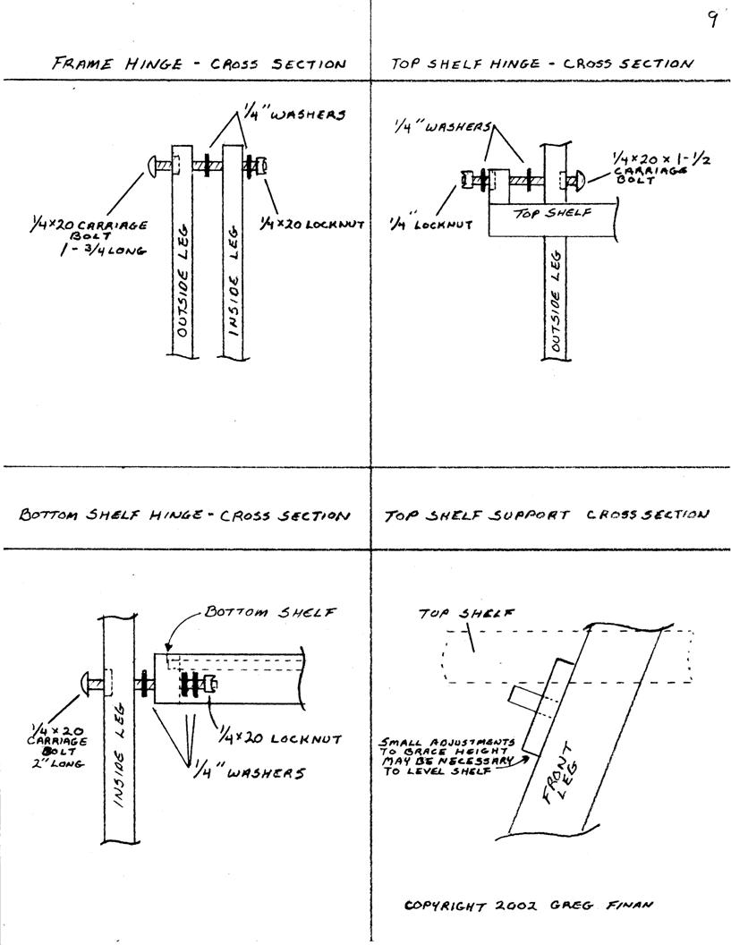

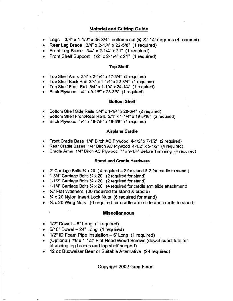

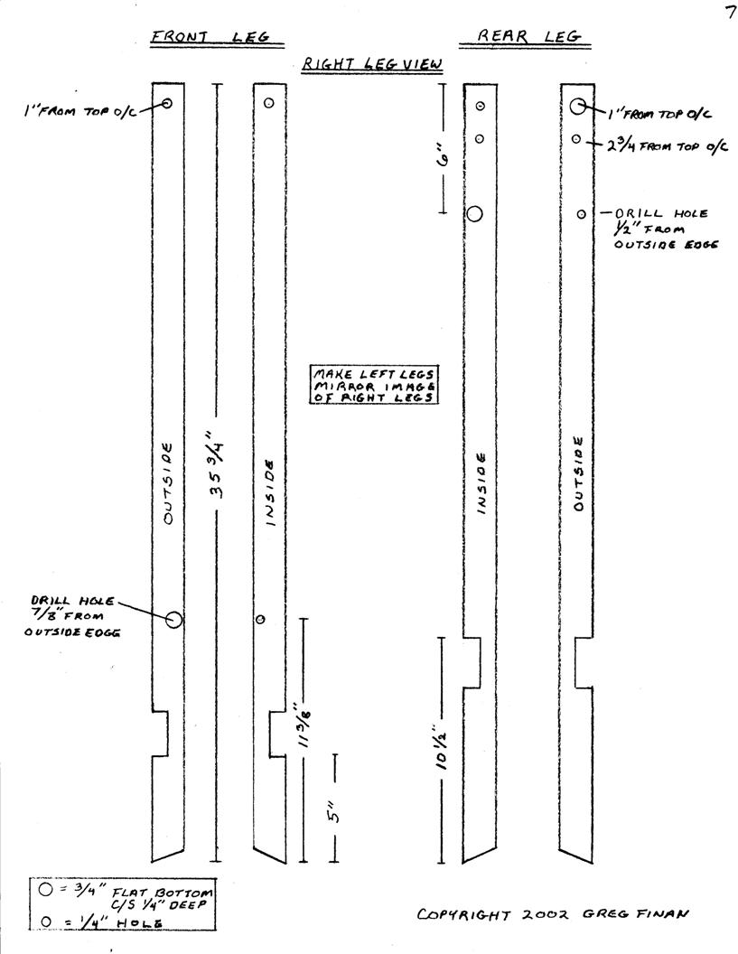

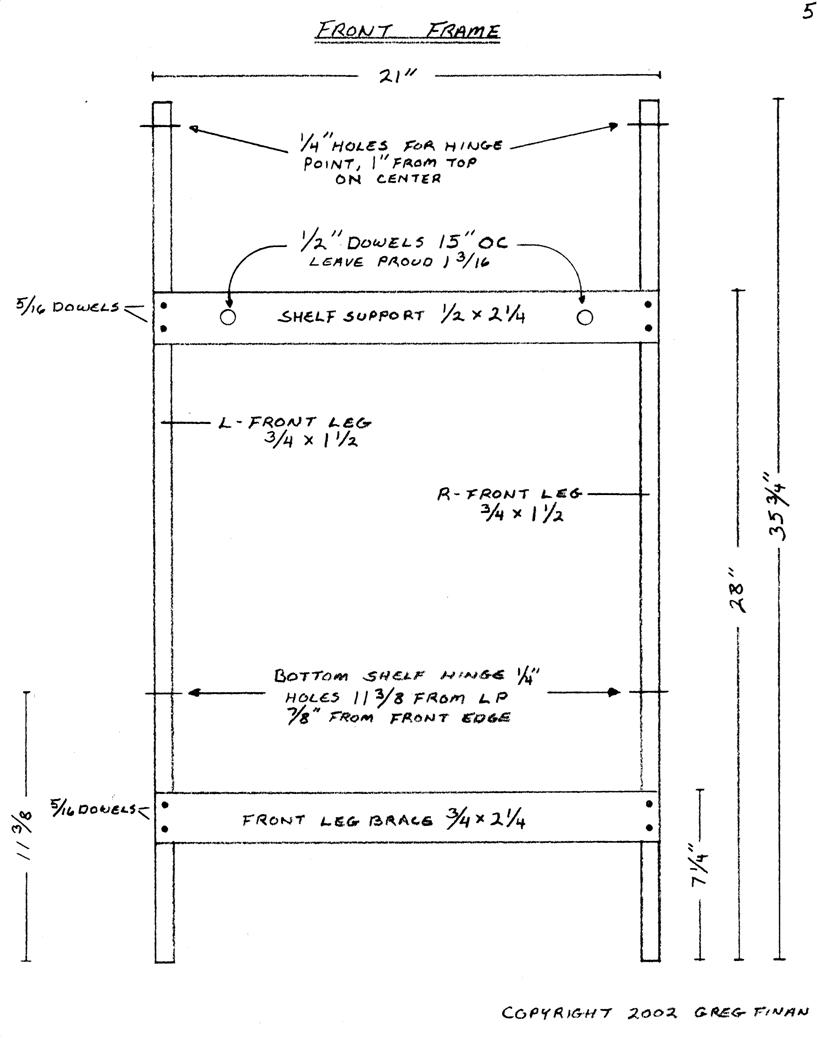

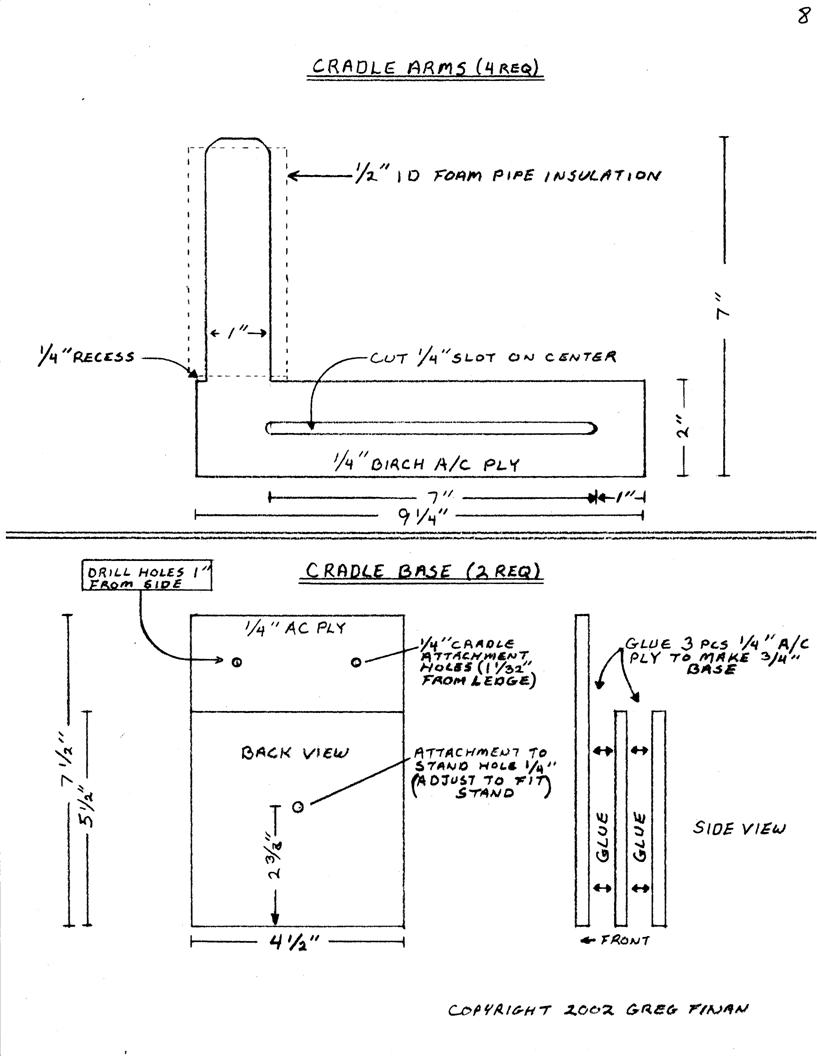

Old 05-05-2010 | 11:18 AM
My Feedback: (25)
Posts: 577
From: Elizabethtown, KY
Default RE: Folding field table
Let's see if these loaded...

ORIGINAL: Jonathan Ott
Wow.. the table is nice.. but I'm much more impressed but the apparent cleanliness and organization of your shop shown in that one small pic.. sweet indeed!
