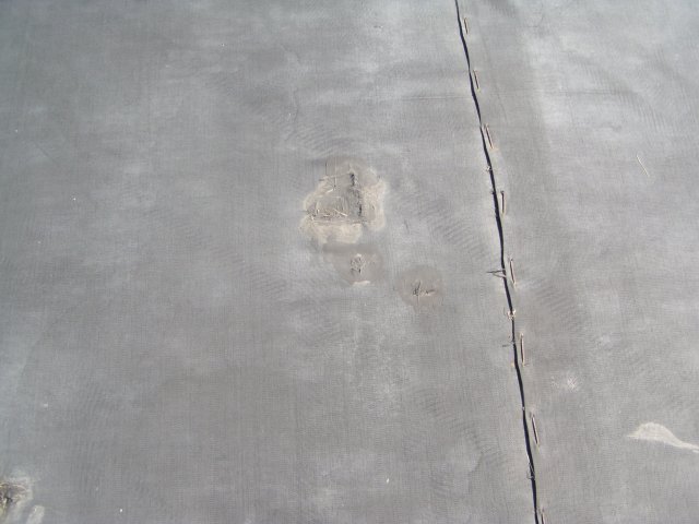

Old 05-29-2010 | 08:15 AM
Joined: Apr 2005
Posts: 205
From: Cedar Falls, IA
Default RE: Petromat Runways
Jim,
Our club uses black silicone caulk and small swatches of petromat material to patch the runway. We just glue the swatch on the backside of the runway and smooth the silicone over the hole with a putty knife. Works well.
Stan

Old 05-31-2010 | 07:48 PM
Joined: Apr 2005
Posts: 205
GarySS,
I got some pictures for you at the field today. We aren't sure off the top of our heads how long the Petromat has been down. We did it in three sections. I went to the oldest area and took the photos. I would estimate the patches at between 6 to 8 years old. I also took a photo of the black silicone seal we are using.
The patches hold up well.
Stan
