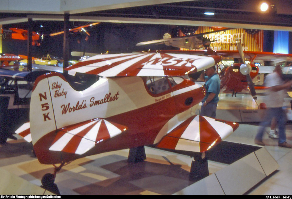

I am in the process of building a 1/2 scale stits sky baby over in the scratch build formums and I need suggestions as to how to paint the N number on the top wing. I think if I just went for it and started masking things off and painting them and then remasking the other half of things and painting some more that I could eventually get it to look the way it should in the pictures below (sorry these are the best ones I could find right now). I was just wondering if someone else had experience in painting a wing similar to this and could tell me what steps and in what order would be best or simplist way to paint it.

I was thinking about masking off the sunburst pattern and probably get some kind of stencil for the numbers. I usually do my painting with a spray gun unless there is some reason I cant or shouldnt.

I make my own stencils. I've been doing this for years.
1. Get a piece of wax paper of the appropriate size.
2. Use 2 inch painters ,(blue) masking tape and cover the wax
paper overlapping the seams by 1 inch. check for air bubbles.
3. Use a Sharpie on the tape to trace whatever pattern you want.
4. Use #11 blade to cut out pattern.
5. Carefully remove wax paper.
6. You now have a stencil that can be used multiple times if your
carefull.
What you've really done is made your own frisket paper.

My method is similar to Roby's, but I use shelve paper. I use Roby's method except instead of removing all the paper backing, I carefully cut the backing about 1/4 inch away from the stencil outline. This is the area that I stick to the surface I'm going to paint. If you remove all the backing, the shelf paper is almost impossible to remove; too much surface area is stuck to the airplane surface. Be sure to seal the outline with a light coating of the base color to prevent paint from seeping under the shelf paper.

But as far as what parts to paint first would you start (with a white wing) and put the N5K positive area stencil on the wing first, tape off the sunburst pattern and paint the red sunbursts (then remove all the tape). Then I am thinking I should take the negative outline of the N5K stencil and put it in place where it will be painted and tape off the white sunburst pattern only where the leters are. Then of course the rest of the wing will just be masked off so nothing else gets painted. I am thinking If I mask all that off it should just reveal the "to be painted red portions" of the letters in the white sunburst area. So then I would paint those areas red and peel off all the tape again and it should be done.
If you can understand what Im trying to say above, is that what you would do?

Your method will work, but it's going to be a little tedious. I would paint the sunburst without any numbers. Then lay out the numbers as one stencil. Then tape and mask the stencil to paint the two colors one at a time using the previously painted sunburst as your guide. In other words, lay the stencil down. Tape and mask the red portion and paint the white. Then tape and mask the white and paint the red. Then remove the entire stencil. Be sure you let the wing cure completely before putting the stencil down. Don't want to pull up the sunburst with the stencil. I use a heat gun on low setting to loosen the glue on the stencil and pull very slowly.

ya, thats what im looking for, whats the best method to paint this number over a starburst pattern. Your method sounds alot easier than mine, like I said I could eventually get it to look the way it should but i know someone else would have a more defined and simpler way to do it.

Painting white over red may not work well. In dope the white won't cover well.
I saw a full scale guy do it this way.
1) Paint it white
2) get a sign shop to make a stencel that has both positive and negative images (just cut out the letters)
3) put the stencel on the wing and layout the starburst patern.
4) cut the stencel where the starburst patern intersects and peel off all of the stencel that needs to be painted red.
5) Mask off the rest of the white starburst.
6) Shoot the red..... DONE
