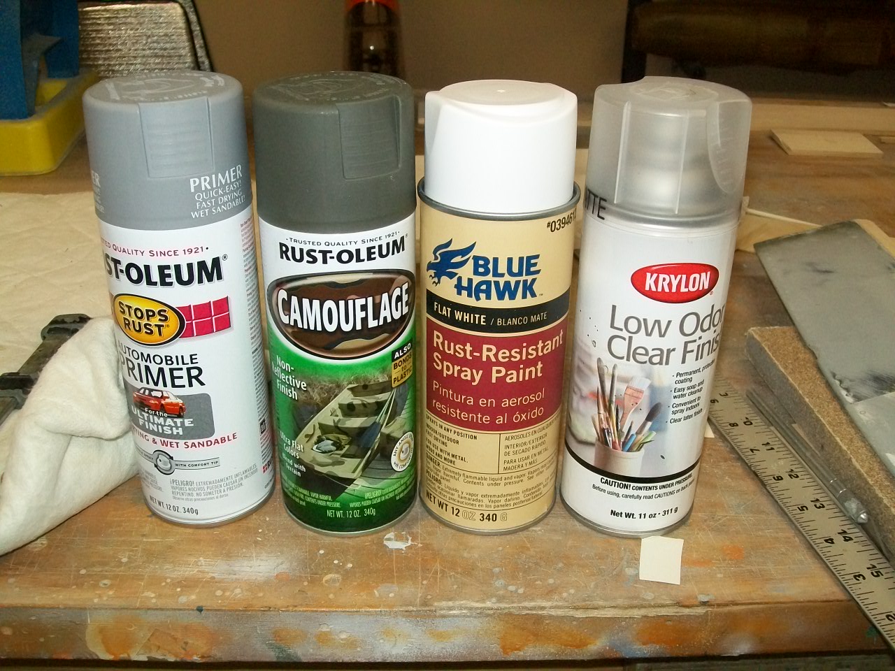

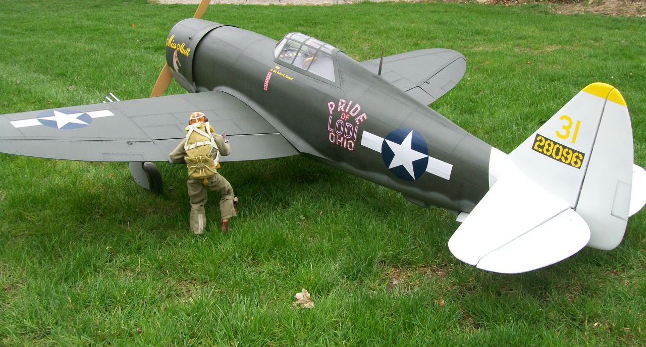

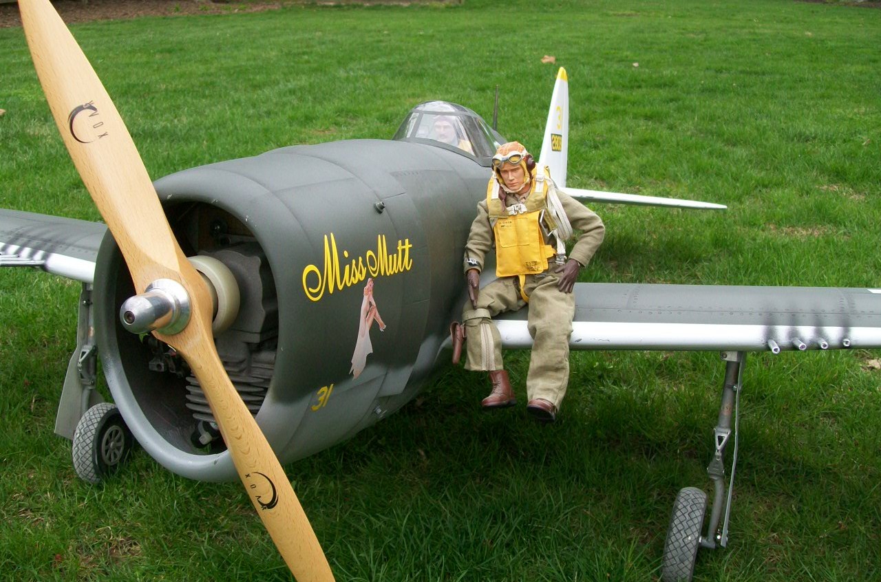

I buy my Rustoleum in quart cans, and spray it with my HVLP gun, using my 6 hp, 60 gallon compressor.
I find that Rustoleum provides a realistic gloss finish, for my scale models. The paint is easily accessable, and is user friendly.
These models were all painted with Rustoleum.

TomCrump 04-26-2015 04:01 AM
3 Attachment(s)
My gun was half the price you mention, and I purchased it a reputable source, not HF. I consider myself to be a "casual painter". I paint a few models every year. I'm certainly no professional painter.
Botching up a paint job on a cowl is no big deal. I use solvent to remove the paint. It's much easier than sanding.

This model was painted using Rustoleum aerosol cans.

Good results can be had with rustoleum,, Yes as a cabinet maker I have been spraying with pricey HVLP equipment for over 20 years, so I do know the tricks,,, It can be a challenge for new guys but I agree with Tom. IMO The work and learning curve is worth the effort in the satisfaction that you have built a one of a kind model.
My recent Rattle can renovation,, with a little help from an airbrush set up,, to get a finer over spray line at the green over grey bottom, I sprayed the paint into a paper funnel, let it drip into the airbrush cup, then sprayed that to get a finer line. I've used that same technique with Lusercote because it sometimes sprays so crappy out of the can
