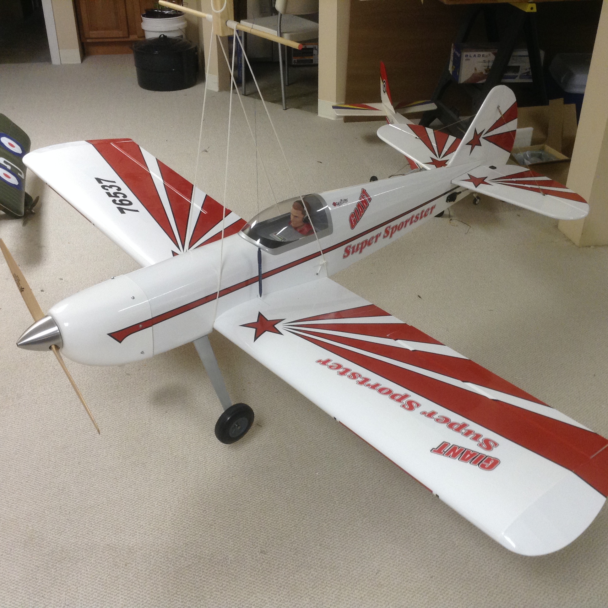

2 Attachment(s)
http://www.rcuniverse.com/forum/atta...mentid=2203805
So I'm having some trouble. I'm having a hard time getting the adjustment dowel parallel to the wing spar and the plane sits crooked laterally. Anybody see anything obvious or do I just need to keep tweaking it to get it right?
Tom Nied 03-03-2017 04:51 PM
I'm wondering if I have the line that holds the airplane (around the fuselage method) too long? I know if the dowel isn't parallel to the wing spar, the plumb is probably off. I might put one on both sides.
ETpilot 03-03-2017 05:57 PM
Tom, you have to make sure the plane is centered in each loop. If it is centered off the dowel will be off. Also, I can't tell from the picture if you are using 2 lines or one line for the loops. I just use the one line. If using two lines I believe the loops have to be equal in size. Can't really recall on that.
I believe I see a problem in your set up but not too clear from the picture. The loops going around the dowels must be in the same direction on each side. I believe you may have it opposite on each side. I set up my plane with the rear loop first. Then I form my dowel 3-4 loops going in the same direction and then do the front aircraft loop. So the inside of the dowel loops go to the rear and the outside loops go to the front.
See post 12 and 13 and see the loops around the dowel. That is pictured wrong and may be the way you have it. I think. Anyway hope this helps.
Tom Nied 03-03-2017 06:34 PM
"centered in each loop", good chance I'm not quite right. I'm using the one big loop of line that goes around the fuselage. This was the first hanging and I'm thinking by this time in the day my accuracy is not as good as it could be.
Loop direction, pretty sure I've got this right. Turning the dowel and on both sides either the nose goes up or down. No opposing forces. Although, I do have 7 wraps, maybe I should go down to 5 for easier re-positioning. I will recheck this.
Thanks ET for taking a look at it. I'll recheck my work this weekend. If preliminary indications are even close, my CG is not too bad, which is remarkable. The problem with the Giant Super Sporster is, is that it is so damn big (14.2 lbs) from what I'm use to, it turns into a wrestling match.
Tom Nied 03-03-2017 06:51 PM
Wait a minute, you're telling me post 12 & 13 are wrong? That is exactly how my line loops around the dowel. When I turn the dowel, both lines on each side move in the same direction moving the nose either up or down.
ETpilot 03-03-2017 06:57 PM
One more thing I might add. I don't favor the plumb bob being on the side on the dowel. If the dowel alignment is off a bit you will get an incorrect reading. I placed my plumb bob centered on the Tee. So from the ceiling to the tip on the plumb bob is one straight line. I have it where I can easily adjust it for height. For my type of airplanes that has not been a problem. Having a plane like your Super Sportster I will have to take a reading over the canopy. I will come up with something when the time comes.
ETpilot 03-03-2017 07:04 PM
It seems to me that with that setup you would get a twisting motion. IIRC correctly this was discussed in this thread. I will check that out on my rig tomorrow and let you know what I find. Will see if I find it in the thread. That setup pictured makes no sense to me. It may be part of the problem with the dowel alignment. Having it as I described I get an easy nose up or nose down motion.
ETpilot 03-03-2017 07:28 PM
My apology Tom. The picture is correct it was the drawing in post 4 that was incorrect. However, I do not like the way the loops were made in the picture. I believe that setup may give you an issue with centering the airplane and maybe with the dowel being out of alignment. I, from the start, wrapped the loops so the inside loops go in the same direction as well as the outside loops. In the picture they are correct but not balanced as I describe. Hope this makes sense.
Anyway, I will play with all this tomorrow and see what I find.
Tom Nied 03-03-2017 07:40 PM
Yes, I'm thankful for a second pair of eyes looking at this. I think once I get used to it, play around with the tweaking, I'll have a better understanding on how to set this up. The system and its science is sound. But if things like the dowel rod not running parallel to the wing spar, its easy to get a misreading. I love the science how this works, but it's important to get things right in order for correct readings. I bet in the end, I'll pull out the Great Planes CoG machine, just to check my work. The GSS is just a monster to wrestle with. I accept the challenge. Thanks ET.
