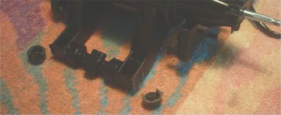

I have not locked the front diff, the former owner had done the work .. The rear is already locked by the company ..
I opened the diff ..
REAR DIFF ..
This gear has two small plastic bearing, I will instead set up two metal / bearing ..
FRONT DIFF ...
I opened the diff .. I put some flat washer (spacer) to remove some loose gears .. FRONT and REAR ..
FRONT DIFF ...
Everything is ready to receive the metal / bearing
(4) little metal/bearing 3x8x3 ..
(10) big metal/bearing/6x12x4mm ..
I start the installation of metal/bearing ..
The 4 large bearing is not difficult to install in each diff ..
..BEFORE ..
..AFTER ..
I also enlarges the center of this small gear, with a little grater .. The 2 small bearing, were placed without difficulty ..
I greased the main parties, and close the diff / rear ..
I then cut the surplus pivot / axis ..
I lubricate the parts and reinstall the diff / rear ..
In a few days, I'll do the same work on the front/diff ..
These metal/bearing, certainly help to slow the wear of these shaft/axis ..

Remove this big body, had a ((BIG))job ..
I fixed this problem by installing plastic rods (solid plastic hanger) ..
The body slips into its old anchors, and it remains in place ..
It is set at the front and rear ..
FRONT ..
REAR ..
The center of the body, has (2) anchors .. I'll screw a long screw (by cutting off his head) as anchors, and once inserted into its hole, I'll screw (2) nuts/ears by the underside of the frame ..
The body is very solid, and the time to remove it will be shorter .. and less stressful ..
