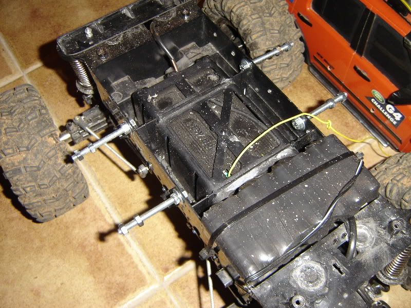

Hi guys... today i solved the issue of thetricky process to remove and install the stock LR3 body to chassis. Really hated trying to reach out for the small screws. Saw this idea on someone else's NB...i guess it was yakos and gave it a try. Nothing major and was ready in minutes... just four 2inch long bolts, bolted to chassis sides, which then go through body. Now body can be removed in seconds...just unscrew the 4 outer nuts. Probably i will cut off the extra length off. Body is even approx. 7mm lower than standard height...just enough to clear the battery.
here are some pics...

how did you put those links on the side
Old 06-03-2009, 01:02 PM
  #39
adrians3109
Join Date: Mar 2009
Location: Mosta, MALTA
Posts: 134
Default RE: 1:10 New Bright Land Rover Mods
ORIGINAL: rcToyotaman
i guess you mean the axle links eh? ...with a little bit of trial and error LOL ...did various attempts, with different bends till i got it right....I used a threaded rod
Thing is i didnt want to fabricate new brackets, because otherwise they would have come better.
Still i cant complain...i've got full articulation as before with the axles now more stable in place.

adrians3109 ..
These ((TRACK-BAR)) are very well installed .. They secure the axles ..
Your pine-doors, are a very good idea ..

thanks texx
had second thoughts and i will not cut extra length just in case i get another body, which might be wider than the LR3
