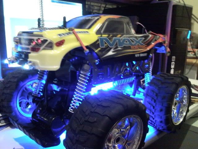

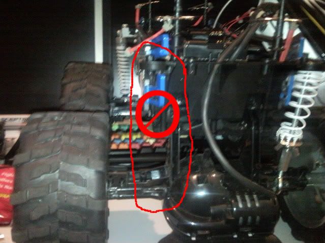

Here's a crash course/quick refresher tutorial to add DuraTrax shocks to a New Bright...

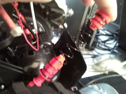

REMOVE SPRING SHOCKS:
ACQUIRE REAL (OIL) SHOCKS:
POP OUT 3mm BEARING IN OIL SHOCKS, you won't need it for the application:

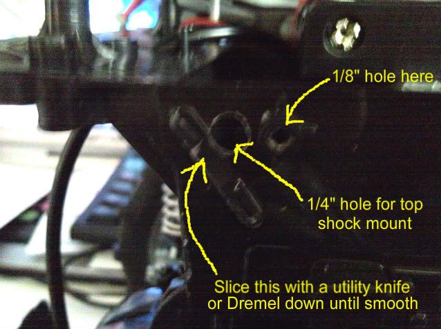

CUT BOTTOM MOUNTING POST T-BARS:
GET APPEARANCE TO THIS:

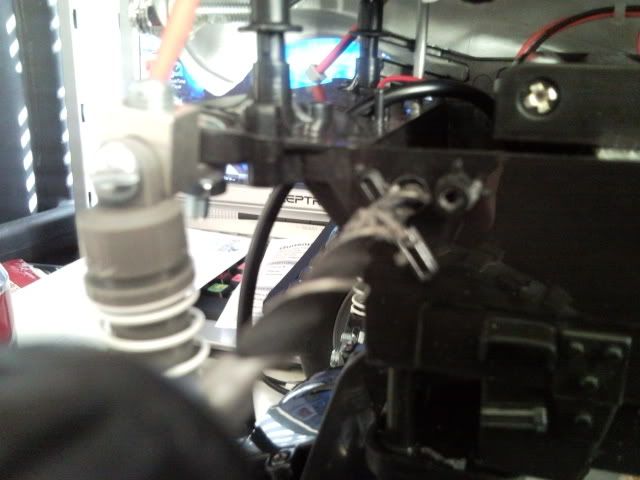

DRILL YOUR HOLES... don't bother with the one for the MAX plate (the 1/8" hole), it's model specific:

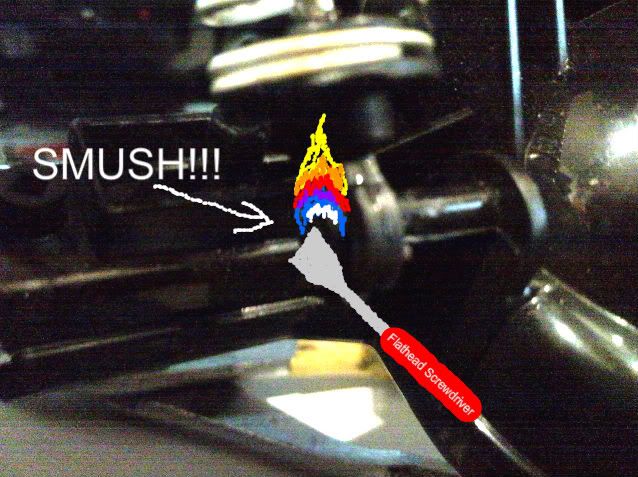

SWING YOUR SHOCK ONTO THE BOTTOM POST AND SECURE WITH FLAME RIVETING:

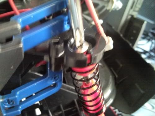

SECURE THE UPPER MOUNT OF THE SHOCK TO THE TUB:
...AND YOU'RE DONE!!!
ONE, CUSTOM KE4QPF BLUE STREAK MONSTER TRUCK.
