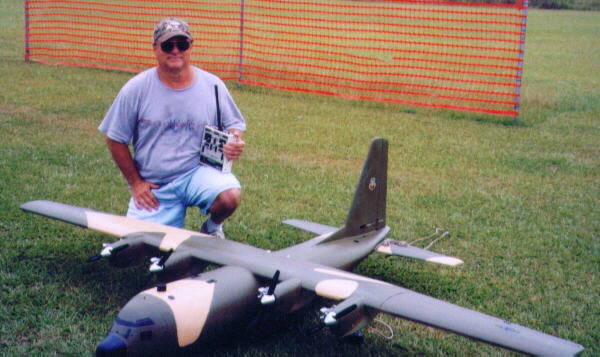

I hope to be able to lay some paint on mine in the next couple weeks, probably over the holidays. I have the wing, stab and control surfaces primed and ready, now working on the fuse with some details like gun ports, IR, LLTV stuff and the side looking radar domes. I'm also adding a RAM rotating beacon and landing lights to mine. I'm really hoping to keep it at about 17-18#. I guess we'll see.

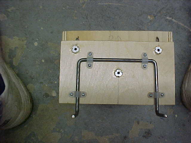

I am not big on 3 blade props because the 2 blade is more efficient. However if your engine spacing requires a larger prop than you planned, the 3 blade is an option. If you use a 10x6 prop and go to 3 blade,, start with 9x5 3 blade.
I noticed in the landing gear, you built it exactly like the "plan". I made that part removable. My Main gear bolts to the square box f/glassed to the fuse. belly. I used 6 4x40 socket head screws and blind nuts. This makes the plate removable for repairs/upgrades. The belly of your plane looks about the right height. Mine was lower and on grass that was a problem.
One small point,, I used 5/32 wire for the gear, and then put hardwood landing gear blocks over the struts to make the wheels more rigid. Prior to that the wires were bending on landings.

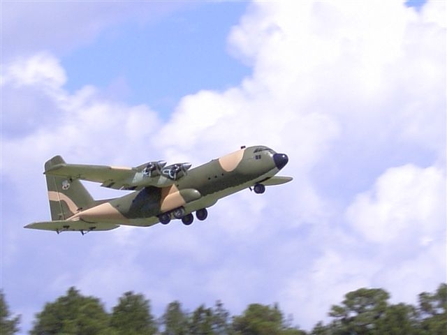

You are right the real herk takes off with 50% flaps. I have over 1000 hrs as Pilot and Instructor Pilot, However the model only has .30 4 strokes and not 30,000 SHP Pratts with Hamilton Standard props. The 1/2 flaps (about 25 degrees) will work but the take off is not as spectacular nor as steep. Just looks really cool with the steep take off. WARNING.. IF you lose an engine on the steep take off,,,, you might lose the bird. If you lose an engine,, go to idle and land as well as you can.
Mine came in at 23.5 #'s and flies well. Lazy me I haven't fixed the stab yet,, but today started on another "big bird",,
Wife saw it and [:'(], Told me I have to repaint the door,, fix tv cabinet and [>:][>:][>:]
However,, I do have the wing layed out and ready to glue..
My flaps are est:
1/2 25 degrees
Full 45 degrees
I use 2 panels on the main wing only. I did not put them on the removable panels.
I will post pic since previous thread was apparently deleted. Jim
