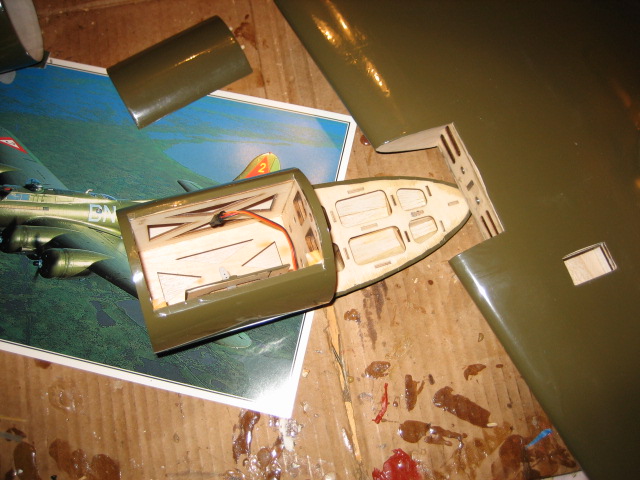

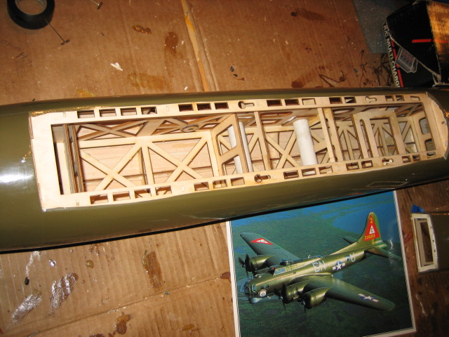

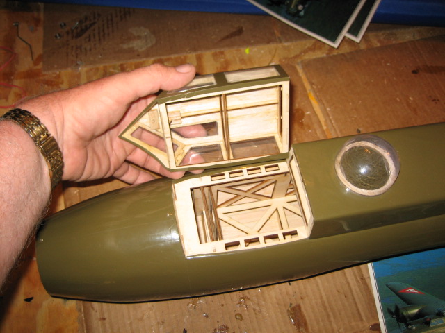

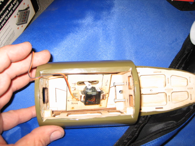

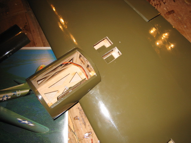

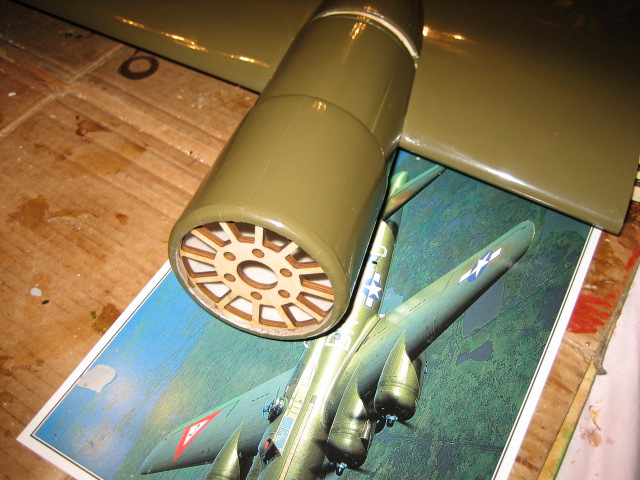

Ok, the production one's are on the boat. Neil has given me the final copy for production to do the build and review the instructions.
Neil has gone through FIVE prototypes to try to get this right and yes, I have complained on certain points also, but he listened. The picture in the site is three prototype back.
Enclosed is the final version and I took the pictures over the picture of the real plane.
Features of it include in nacell fuel tanks, a separt module for the tail wheel. The separate module was the easiest way to handle the messy linkage, as the tail wheel is not in line with the rudder. A special hatch inside the nacell that WILL clear the fuel tanks for the throtte servo. The 82" wing is now a two piece for easier transportation.
You can look for yourself inside the fuse. Yes, you see TWO wing tubes.
More as the build begins.
Twinman
PS I did notice the overhead machine gun turrent is too far back. Cedar Notified

Definitely much better looking.

I'll have to agree with Kmot it defenately is better. The windshield could use a little dressing with an egsacto knife to make them bigger. But the rest look a lot better than what the box shows. Howd they do on the engine cowels? That to me was another issue that I thought just didn't quite do the plane justice.

You're right! This version IS much better. And breaking the wing in two for transportation and storage is the best idea yet for this model. OK, I'll be paying better attention to this project from now on.
