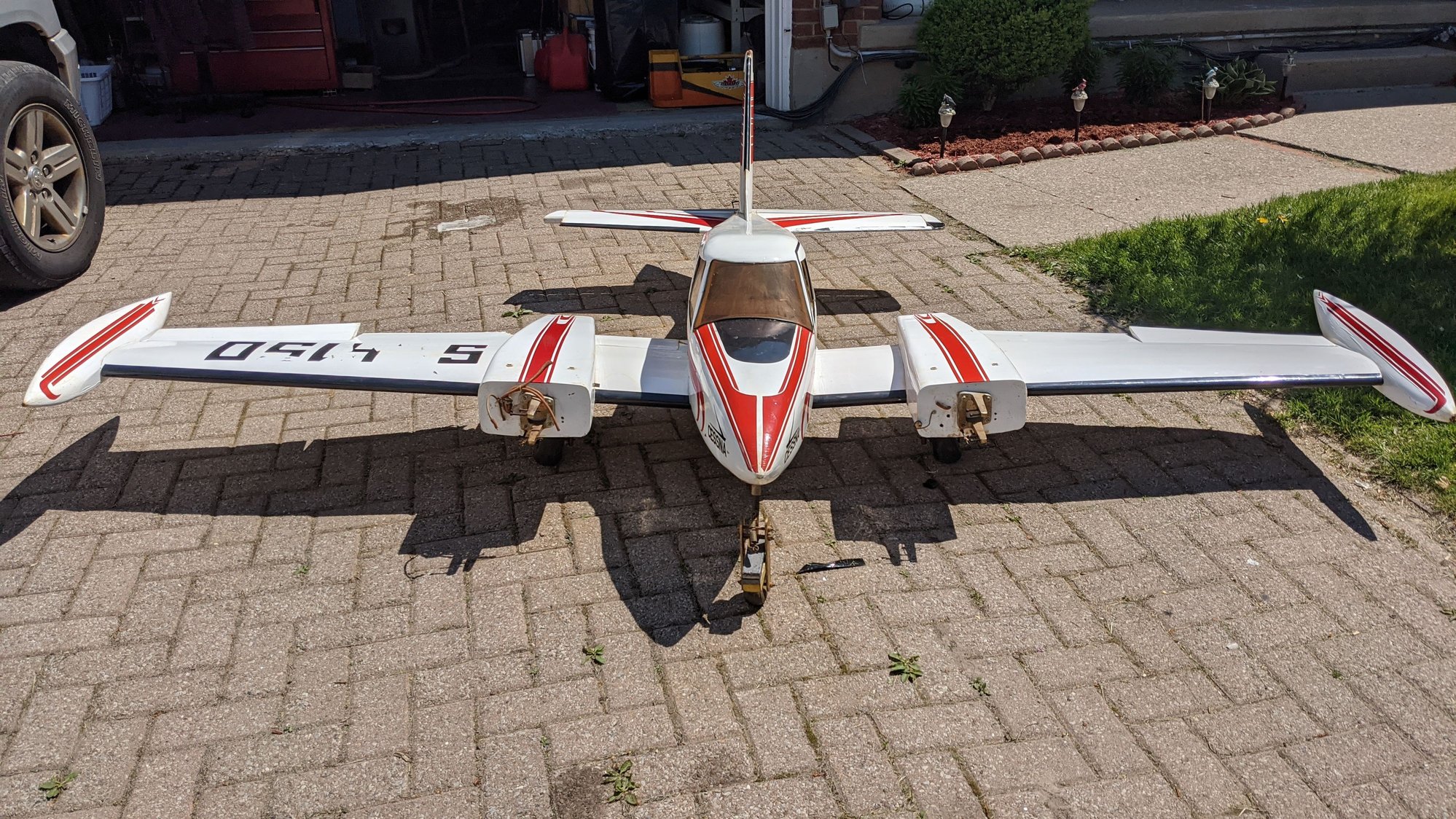

I had to go back and look at my old posts.. and WOW.. over 10 years has gone by.. Well I am retired now and have been catching up on some long waiting projects.. And now my nosen is on the work bench. I think back to how many planes have come and gone on the bench.. not to mention the spilled beer 😁 and the beer that has been drank..👍
It took me about 2 hours with a pail and sponge to clean the airframe.. She originally weighed in at 35 lbs with the Enya 1.20 engines.. After stripping the old hardware off , and those gaudy looking landing gear.. but I manage to strip her down to 20 lbs bare airframe.. I have a pair of 30cc RCGF engines and new retracts to go in.. With the new hardware it looks like I will be adding about 10 lbs... she should come out around 30 total..
Some how.. in the history of this plane and the numerous people who have owned it.. but I have original pictures that the builder took some 25 to 30 years ago.. the pics have followed along with the plane over all those years.. so I had a pretty good idea of what was inside the center section. In these pics you can see how I have opened up the wing to install the new retracts. The flap servo has to be re-located as well as one wing tube.
This would have been a lot easier during the original build..

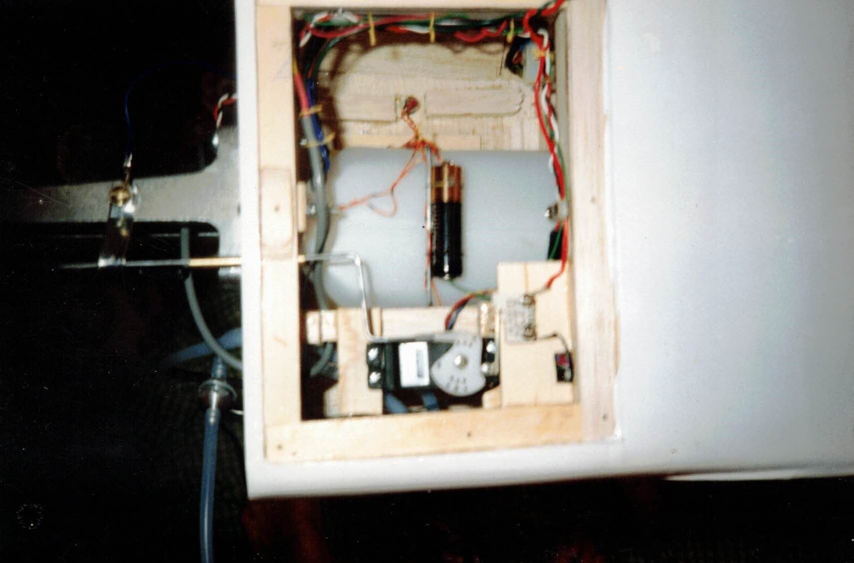

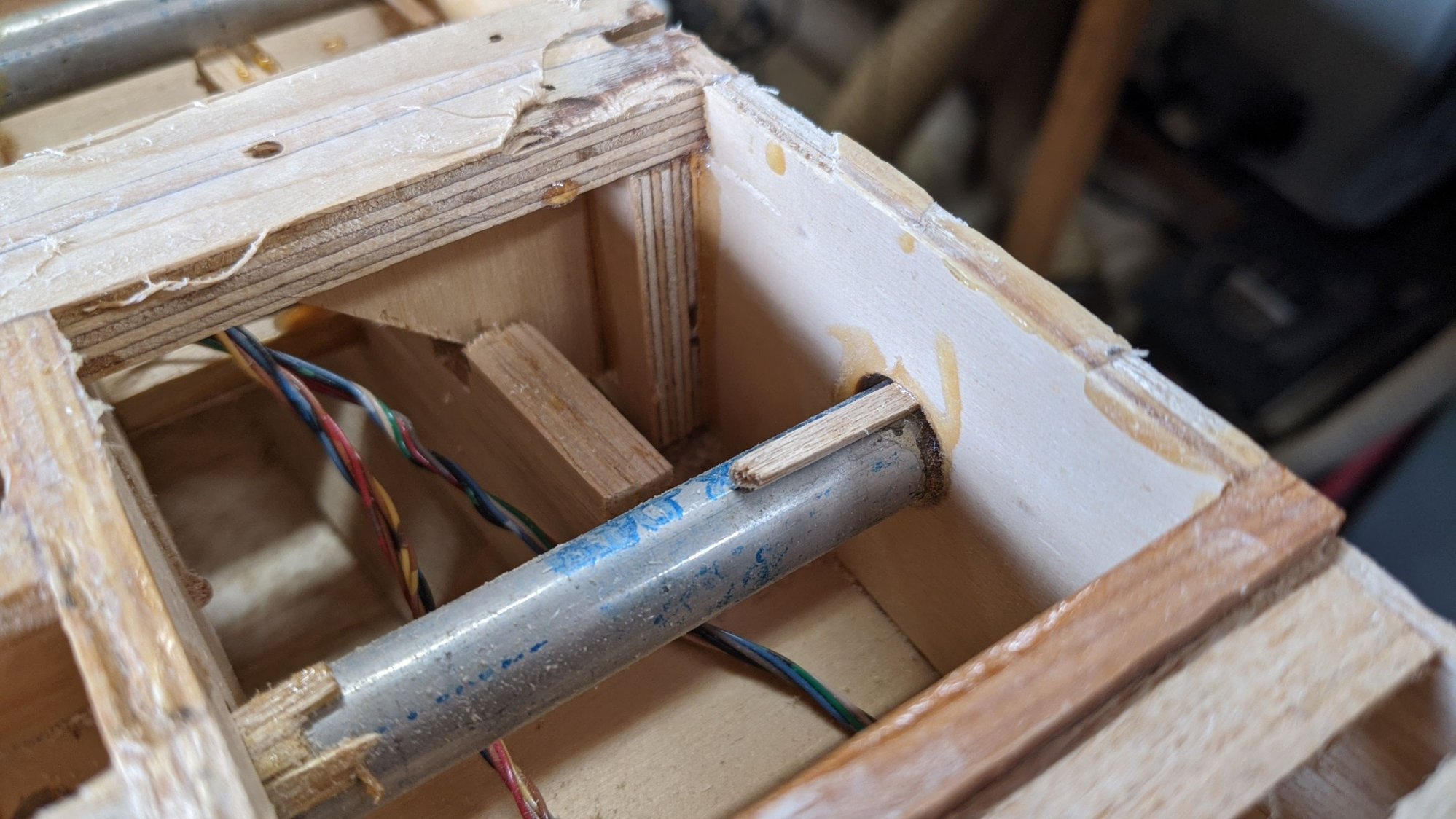

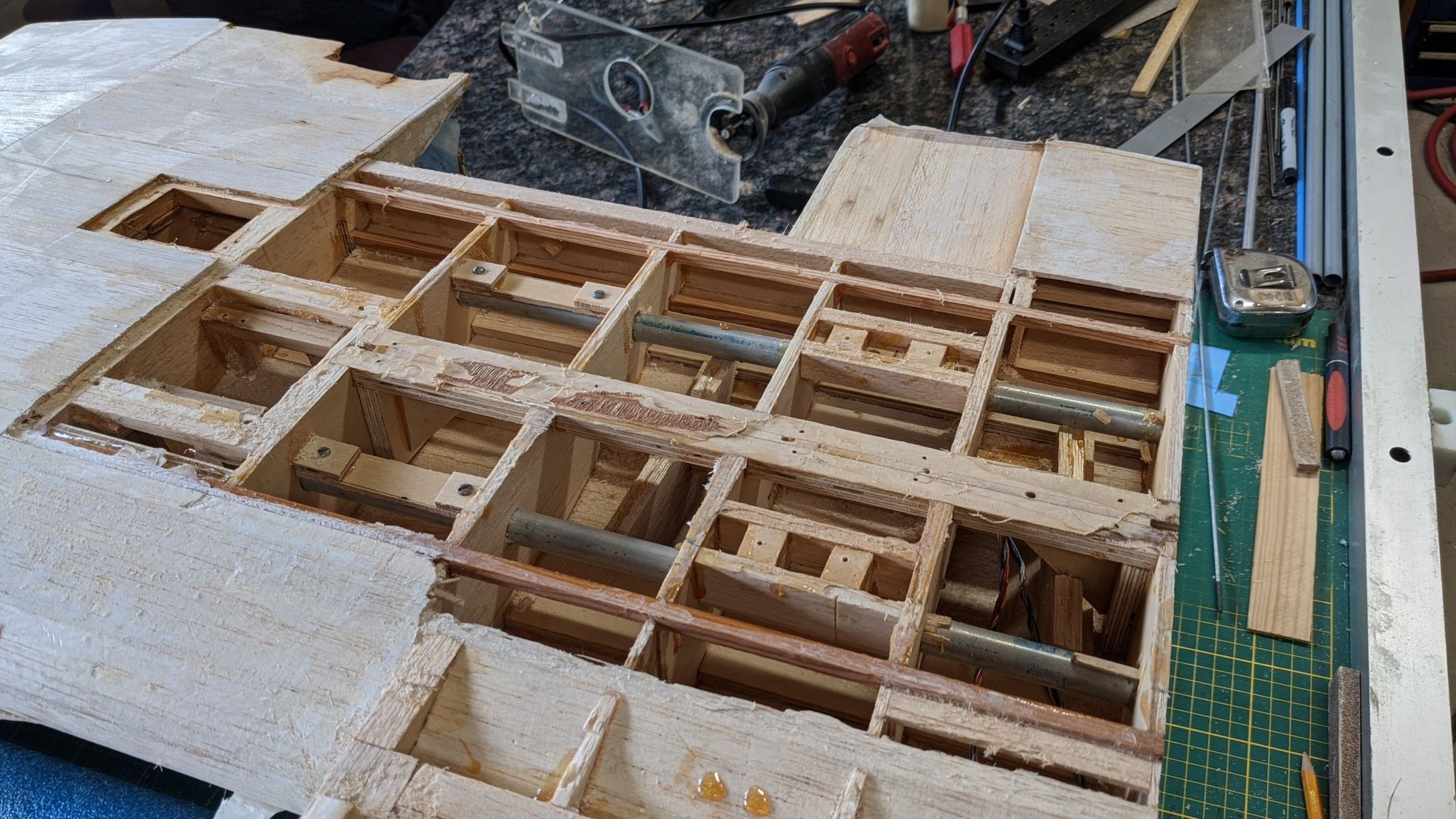

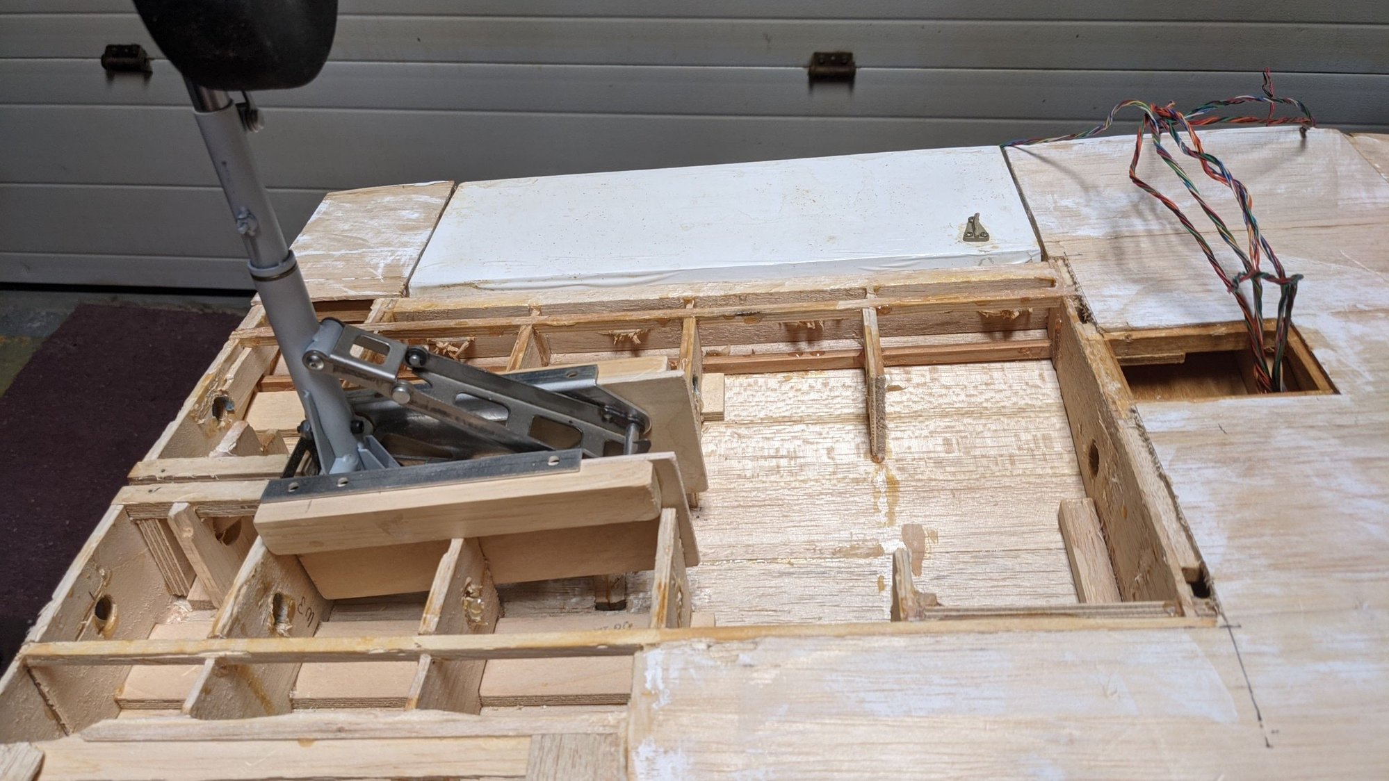

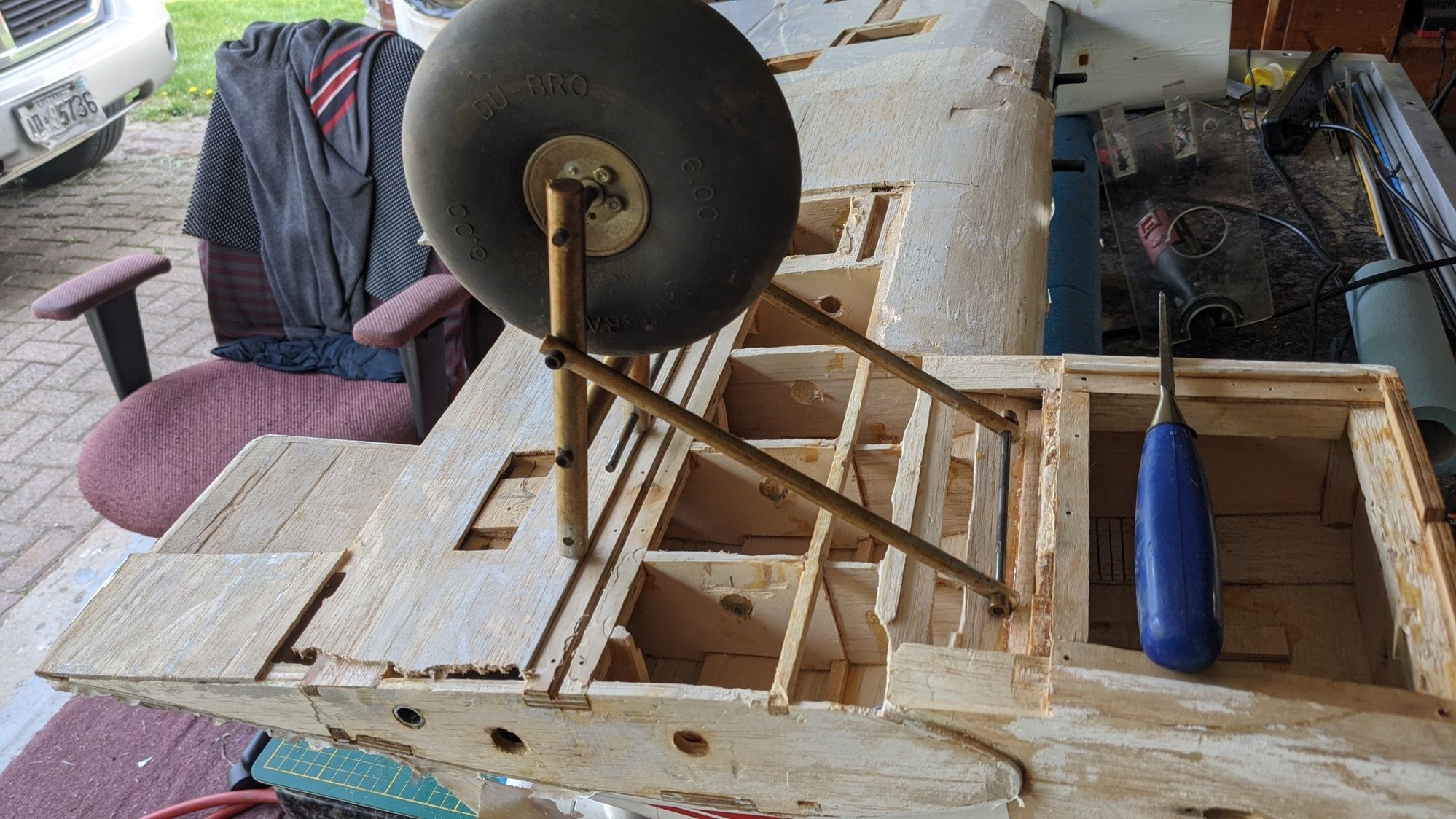

Well just sitting having my coffee and thought I would put in a couple more pics.. the first one is what the nacelle looked like originally .. the battery was for an onboard glow heater that worked off the throttle servo to a micro switch.
I finally got the right side wing opened up and got everything ready for the retracts to be installed.. you can see in the pics a bar between the gear. I machined a squared face at each end , and then tapped a hole ,, this allowed me to bolt the gear to the rod and hold everything in alignment during the install..
The original wing tubes where removed and new CF ones are ordered.. The original ones had way too much slop in them for my liking .. seemed like she might fly with the wings flapping like a bird.. Ran into a buddy who gave me a lead to some new tubes.. here is the link.. https://zyhobby.com/
Original nacelle
Wing finally opened up
A little surprised to find bits of balsa holding the tubes in place
Nightmarish wiring
Jig to hold the gear in alignment

Looks like a very serious rebuild, I think you are going to like the final outcome of your project,
a Cessna 310 without retracts just doesn't look right. Wish I were a few years younger, I think
I would tackle another Nosen 310, but unfortunately I no longer have the room for anything this
large. I really enjoyed building the last one I had several years back, all balsa with the G & L
Hobbies wing tip tanks and engine cowls on it. Keep up the great work you have going on here,
I'll look in every now and then to check out your progress.
Bill D.
