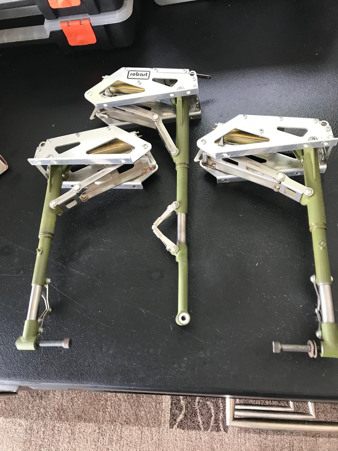

Old 07-09-2021, 10:28 AM
  #1657
Toolman-RCU
My Feedback: (10)
Join Date: Jun 2002
Location: Boca Raton, FL,
Posts: 86
Picked these up at an estate sale on Ebay for $225, I had been searching for over a year! The seller really didn't know what he had, in fact he described the main gear as 90 degree rotating. I looked at all the photos closely before purchasing. I was correct in determining these were 158 and 152. Looks like only the right main was mounted temporarily.
Old 07-09-2021, 10:33 AM
  #1658
waldo3690
Join Date: Apr 2006
Location: Champaign, IL
Posts: 33
Kudos, great find well worth the wait, congrats

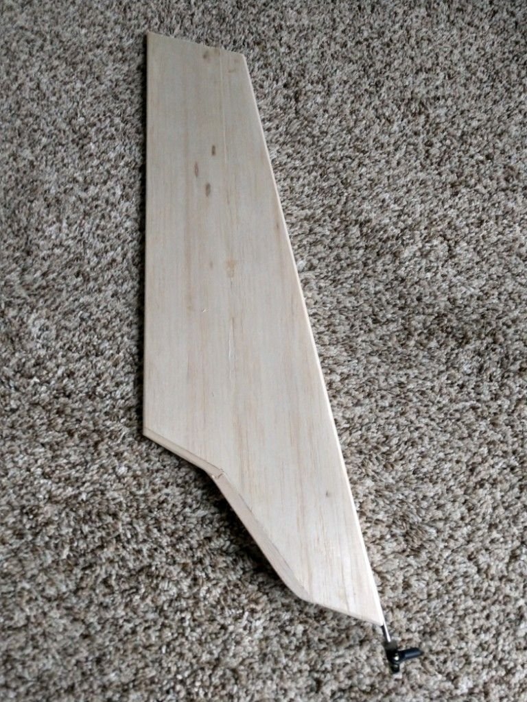

So...here we are again. I have got some photos of the wing. The flaps and ailerons have internal linkages. I may change those...not sure.
I laid up the rudder this morning. I need to construct the top out of 1/8" balsa sheet so I don't have to carve out the wooden block.

Hey all,
I made a little more progress. I built a rudder the other day and was over zealous. I forgot the hard points for hinges and the plywood block for my control horn. Besides that, I did not look at the plan close enough and built it too small. Oh Boy!!
Today I managed to build my rudder control rod and new rudder. Much better now. All it needs is the top piece added on. I have been away from it too long and almost forgot how to build.
I'm going to have a million ??? for you guys with experience. I think I have forgotten more than I knew.
Here is one now...The plan shows the trailing edge of the vertical stab and the leading edge of the rudder as flat. Will the hinges provide enough clearance or should the rudder have a slight taper on the leading edge?
Also...Bill...I have the template sheet you sent me many moons ago. Do those drawings compensate for the fiberglass parts?

Old 07-19-2021, 03:36 AM
  #1668
waldo3690
Join Date: Apr 2006
Posts: 33
My plans show a taper on the rudder see attached picture. I also put a 10 degree taper on the trailing edge of the horizontal stab along with the elevator. When I do the trailing edge of vertical stab I will add a small taper on it as well.
Old 07-19-2021, 03:42 AM
  #1669
Bill Diedrich
Bill Diedrich's Avatar
Join Date: Jul 2006
Location: Ventress, LA
Posts: 1,536
Received 12 Likes on 12 Posts
(Here is one now...The plan shows the trailing edge of the vertical stab and the leading edge of the rudder as flat. Will the hinges provide enough clearance or should the rudder have a slight taper on the leading edge?
Also...Bill...I have the template sheet you sent me many moons ago. Do those drawings compensate for the fiberglass parts?)
I would put a slight taper on the rudder, so as to let it move in both directions without binding, look at the drawing for the fin and
rudder on the plans sheet.
The template sheet is for the kit formers, not for the fiberglass fuselage 310.
