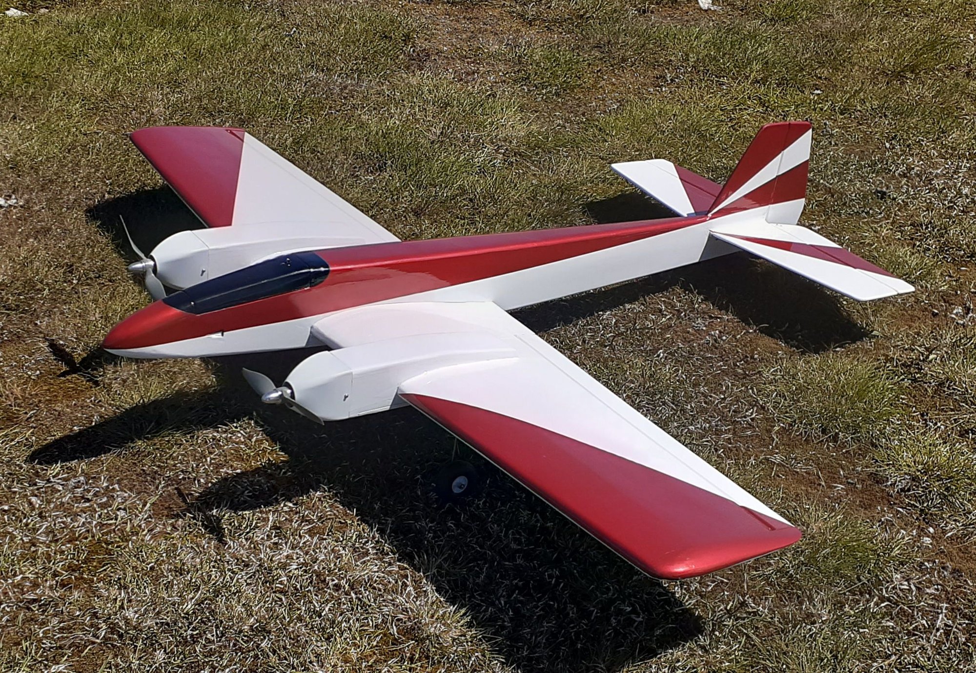

Creative RC 09-02-2022 03:01 PM
Fifty Caliber Conversion to Electric
I acquired from a club-mate ( CF105 ) a Fifty Caliber. I have been posting in RC Goups under the title Fifty Caliber Conversion to Electric should you wish to follow the progress there.
He did a great job refinishing and converting it to electric power and it is without doubt a great flying plane. Not only does it fly well, its rolls are perfectly axial with aileron input only. Intend to keep it a very long time.
In keeping with it's name he installed two Power 25 1250 kv motors (hence Fifty Caliber) with counter rotating propellers. The two speed controllers are located over the wing and the battery in the nose under the black canopy.
He had been flying it with a 4000 mah 4s battery and getting 3 minute flights. Once I acquired it, I started flying it with 5000 mah 4s then made minor modifications to fit two 3700 mah batteries for a total of 7400 mah for more reasonable 5 minute flights with power enough to land afterwards. Going to larger batteries affected the balance little and the elevator trim in flight little as well. The cowls were 3D printed with a front opening just big enough for plenty of motor cooling.
It has a built up wing (not foam sheeted) and was originally built to be a tail dragger. When I received it, the plane tended to tip forward easily and takeoff was extremely wild on account of having to hold a lot of up elevator to keep the tail down. However, bending the fixed landing gear forward resolved that problem and now it takes off and lands without issue. I now have the two Avian 60 Amp ESCs programmed for throttle reverse to shorten the landing roll-out and eager to try that out.
On this plane it appears the ailerons were made to be wider. From the back of the chord where the hinges are located, the ailerons extend 38mm. I would like to modify it further for flaps as well. With programming I could easily make the flaps do double duty as ailerons and flaps with the flick of a switch as I have done on other planes.
Doxilla, if you do complete your design (and I hope you do) and produce laser cut kits and provision is made for it to be constructed for electric power, I for one would be interested. Suggest you incorporate a flap option as well.
With regard to locating equipment for an electric conversion, CF105 did add some weight to the tail for balance. He did tell me that if he were to build one, he would prefer to have both the batteries and ESCs in the nacelles (much as was done with the E-flite Deuces Wild), but I have not investigated whether there would be room for that. I do like that both the batteries and the ESCs are in the fuselage because it keeps that weight in the middle of the plane, but I had to make modifications for cooling as the ESCs were getting too hot, a problem that has been resolved.
If you would like specific photos of the electric conversion or other specifics, let me know and I will post them for you. Now that I have flown this one, the an electric Magnum 80 would be very interesting.
