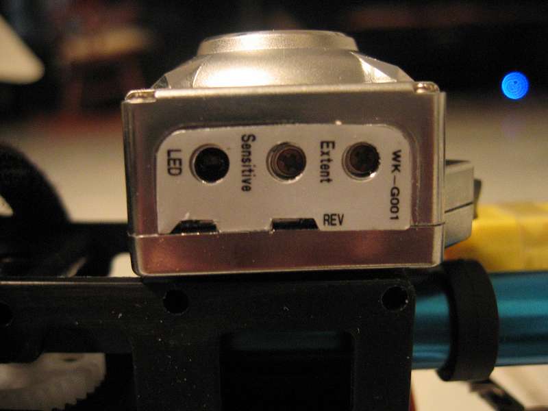

-The tail servo seems to chatter most of the time, although I have read that this is normal?
-As the the Heli gets light on the skids it starts to yaw clockwise. It takes almost full right rudder to correct it. Is this because the tail is not spinning at enough speed to give it authority yet? The gyro apears to be working -ie. The servo responds when I move the heli manually. Maybe I just have to adjust the Sensitivity & Extent settings on the Gyro?

As far as the heli yawing clockwise, it sounds to me like your gyro is backwards. Since the main blades turn clockwise as well, you can rule out the the tail rotor itself. There should be a switch on the gyro that is labeled 'tail-lock'. Use a tiny screwdriver to switch it over and see if it rectifies your problem. Also, make sure you get a better charger for those batteries. I guarentee that you will fry some batteries sooner or later. The Walkera charger is crap. Also, make sure your xmitter batteries are always fresh. Change them after about an hour of flight time. This will save you from some nasty nosedive, kamikazi crashes.

Good pont, I didn't realise that it is actually yawing the same direction as the main rotor so the Gyro must be set the wrong way. I did check the gyro response but must not have noticed it was going the wrong way. Either that or the tail blades are not pitched properly in the neutral position? I'll have to wait until next week before I can try it again. []

Using right rudder to correct the heli turning clockwise is all wrong. Always fly the nose. Right rudder should make the nose of the heli turn right.
ORIGINAL: aurora799
This is what the one on the #36 looks like:
