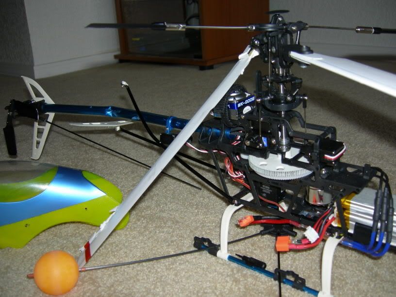

All - I found a net trick to stop those tail boom bashies by the main blades, as if it happens it is always the vertical stabilizer that gets it and then the boom so here's my idea on how to reduce that strike.
Get a new horizontal stabilizer and bend it so that it point down at the corners a little heat from a hot water works, just don't burn your selves. so in effect what you have is two horizontal stabilizers on the tail boom both should be bent to make an unhappy face that way if you come down and the rotors try and hit the boom they are helped over it by the stabilizers. I have found it to work well you just need to make sure you bend them so that the blades get redirected over the boom, not enough bend and they will get stuck underneath and then crash boom, head and blades. nice repair bill for parts. and maybe a few harsh words on this forum from someone who tried it and didn't bend it enough.

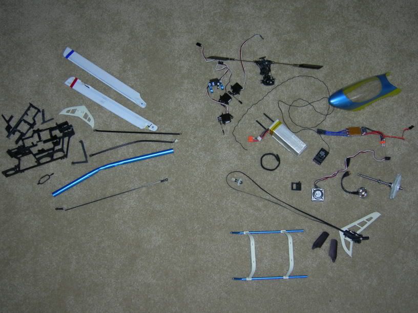

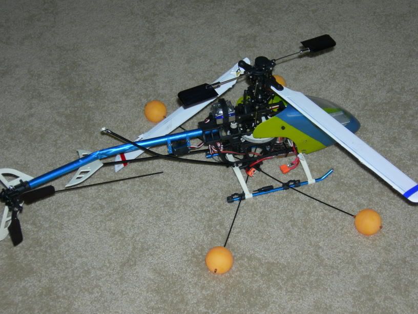

Hi I am new to the forum, also completely new to helicopters. I have been making progress with my 37 until I it trashed itself with its own blades. I was 3 feet off the ground when I make a fast landing to avoid a wall and lawnchairs. When it landed the main blades went into the boom and broke a lot of parts including shattering the frame. My little machine has been reduced to two piles.....SUCKS!
I would say it whacked itself pretty good!
Trash to the left...........................................Sal vage to the right
Parts are on the way from Ehirobo,
I ordered some main blades, tail blades paddles and carbon boom and the metal upgrade rotor and tail for the DF60, I think it head should fit.
I wish I would have found this thread earlier, but have found it very interesting, except for the cheap fungus shoe thing!
I will update when parts arrive.

Better check your bellcranks, yoru z shape holder...that stuff breaks all the time.
Dam... it crashed bad.!! WOw.
ORIGINAL: Allstar W37
One more pic
One more pic
#495
Join Date: Aug 2006
Location: , CA
Posts: 29
Yeah the z shape holder is broke, I just replaced it too. A few other parts in the head also. I didnt order them because i am gettin the metal head for the 60 and trying to stick it on there. Do you know how it will fit? I think I like the flybar above the main blades too but never tried it underneath, by the way W37 Cepeda nice job on the Align parts on you copter. I looked up the part numbers and it was just too much $ for me. Maybe the new head will keep the blades farther from the boom to prevent this as this is the second time this has happened. First time not as bad though.

Ouch! Man those main blades must have been cruising when they hit the boom. I did the same but my frame survived and the boom just had a ding. I replaced it anyway. In my case I think completely cutting the power in a panic mode allowed the mains to his the boom. (0 or maybe negative lift in the main blades) Trust me I am a nubie so that just my opinion. Yes it took out several of the head parts as well as the boom support.
Good to hear from you Army. I'm back from my week long CA coast bike trip of 2600+ mi.
Aside from a few bumps this is a great thread. The input from the pioneers, W37, Sonnebee, Army, Balance, Cheepo, Jon and every other post has been a wealth of information.
By the way, where did you guys get your training gear? Im using wooden sticks and ping pong balls which is marginal at best.
Jim
Jim
