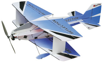

Does anyone know how the wings are reinforced?
Is it carbon webbing (Tensor4D style) or kevlar thread (like the Nikitis Rebel, PopFlyer Pitts) or some new idea?
Join Date: Jan 2005
Location: Columbus,
OH
Posts: 784
RE: Official GP Reflection Build Thread!
I see carbon bracing on the production version. The prototype (Havoc) used kevlar thread.

About the Reflection Build.
I built mine last night. I know why they put this build question thread on here. A beginner will probably have a rough time building it, Its a little tricky. Read the instructions throughly, and dry fit EVERYTHING before gluing in place. THIS IS SUPER IMPORTANT. Although I didnt have any problems, I can see where it would be really easy to glue something in backwards.
Once its built its AWESOME. Its the first foamy biplane Ive seen that actually had a really stiff and rigid fuselage to wing joining. Really good construction. No flex in the joint. A severe problem with most other biplanes Ive built.
The no-tape hinging system is a little complicated, but once built, its FAR superior to tape hinges. Really smooth, and NO slop. The propriatary Z-bend connection system is also no slop. Really smooth travel on the surfaces, and precise.
Awesome plane.
Anyway, heres some pics of mine
