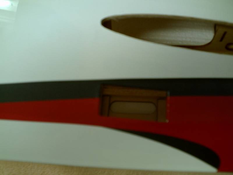

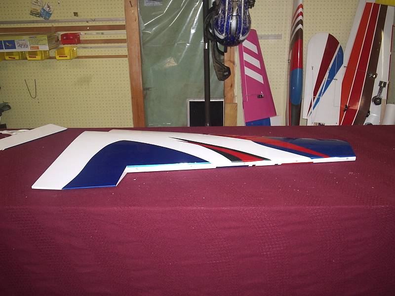

Hi there!!
I am starting the build on my new Great Planes Performance Series Cap 232 and would like to share my progress with you as I go along. If you have any questions please feel free to ask!!!

The first pic is of the wing, it was covered very well and looks great!!! the whole airplane arived packadged very well and there was no damage to speak of. the first thing to do is make the hinge slots slightly larger to alow a better fit and tighter gap for a better smoother hinge job. Its easy to do with a sharp number 11 blade just trim it so the hinge it self sits like in pic #3. when you are done it should look like the hinge job in the last pic.

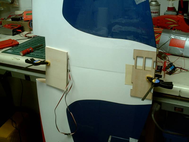

more pics

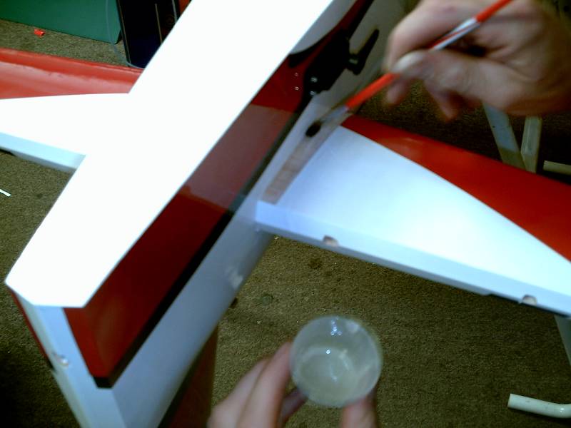

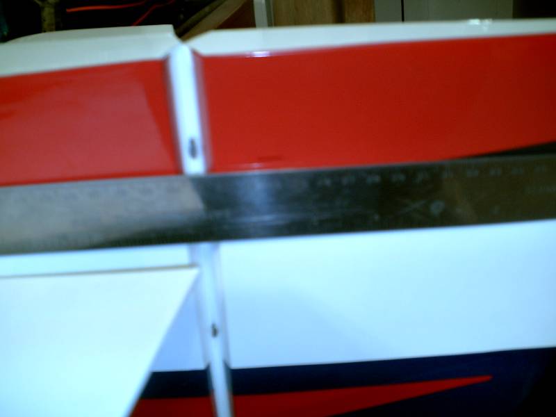

Do yourself a favor man to save time in clean up:
1. Of course get all your hinges setup correctly and the holes the proper size to fit the hinge knuckles:
remember the hinge knuckles should be on the hinge line
2. Tape off your hinge holes on both the mating and actual surface
3. Use whichever glue you want; if you use gorilla glue which is really best - then when it expands it will do so onto the tape leaving you a clean surface on either the mating or control surface.
Simple, cheap, and easy way to save clean up. Works the same for other types of glue but expanding glues are best for hinging. You might put a few drops of 3 in oil in the hinge knuckle and its best to hinge to the mating surface (i.e. wing, stab, or rudder) first for best results.
If I would have done this when I first started building big planes it would have saved me soo much time. Then I finaly read the instruction manuals of an ARF (WH extra) and it became clear.
Looks nice and you will save weight with no wing tube!

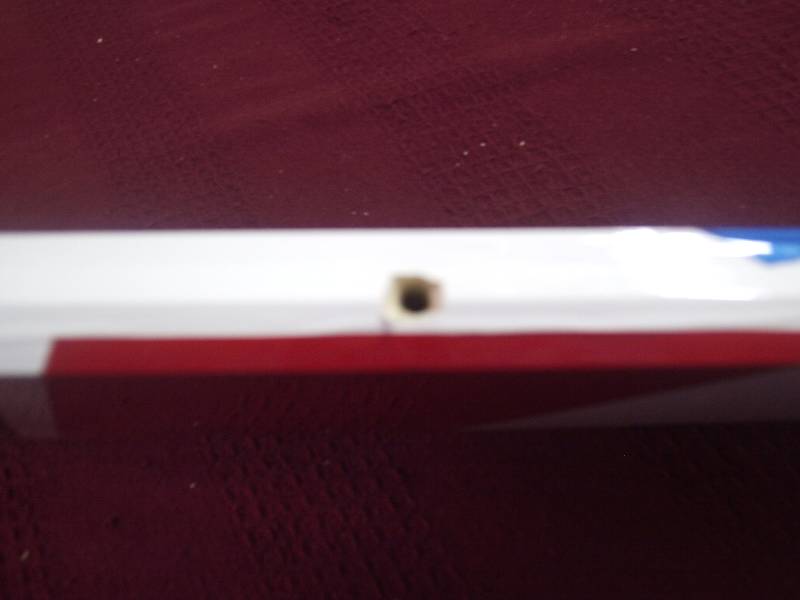

I don’t like to hinge my surfaces until I mount my control horns, I like to set the surface up on a drill press and drill my holes straight and true. For glue I use the pacer hinge glue and love the way it works, but before that I put some Vaseline on the hinge right at the pivot point with a tooth pick. If you work slowly and carefully you should have no clean up on the wing or on your work bench. That’s my humble opinion!. thanks for the nice comments the plane goes togeather very easily and is very light this is defenitly a nice arf.
Clayton Wheaton

No wrong way for a hobby! Yeah jigging the surfaces is best to get everything exact. I never used the hinge glue just always used the expanding glue that is some really strong stuff. Its extra insurance for when you hinge into foam core wings or when you are not certain how much your hinges will stick into.

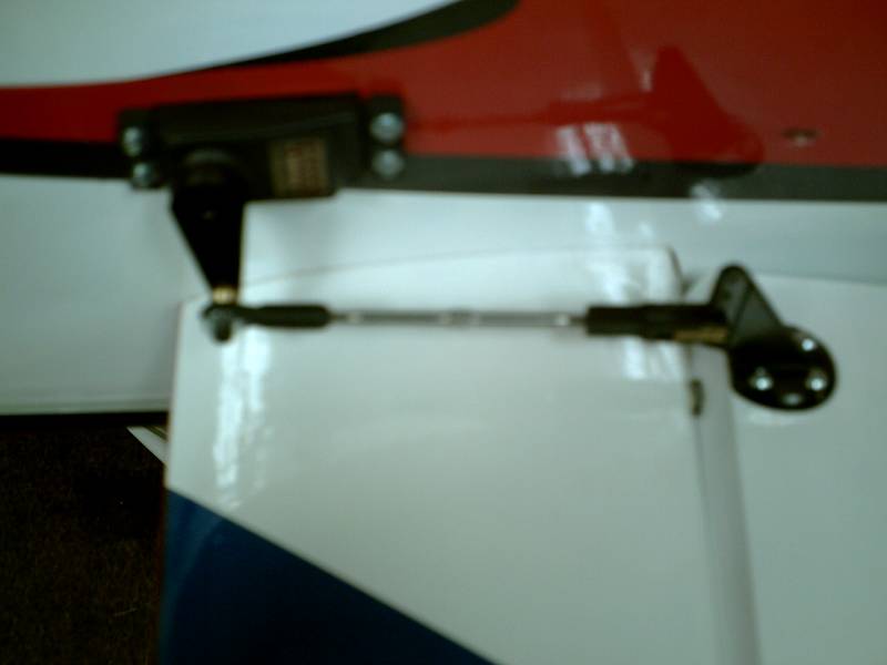

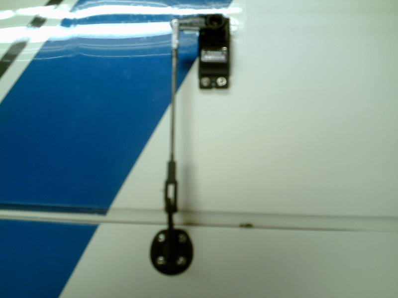

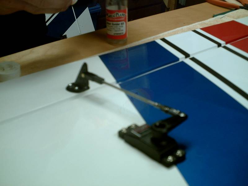

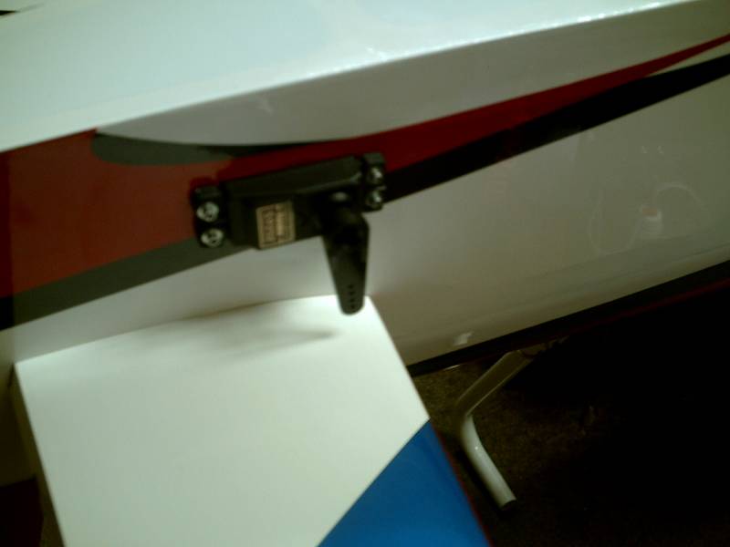

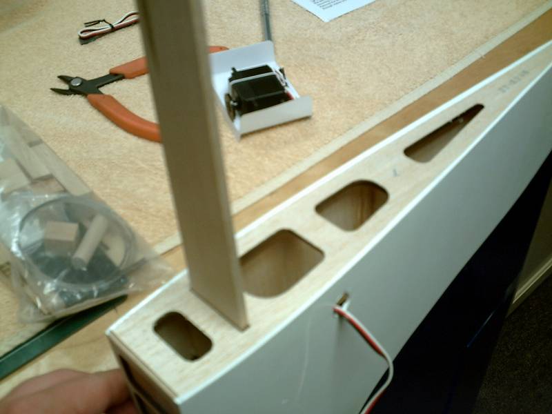

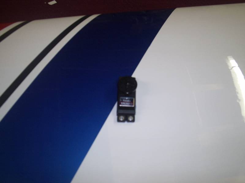

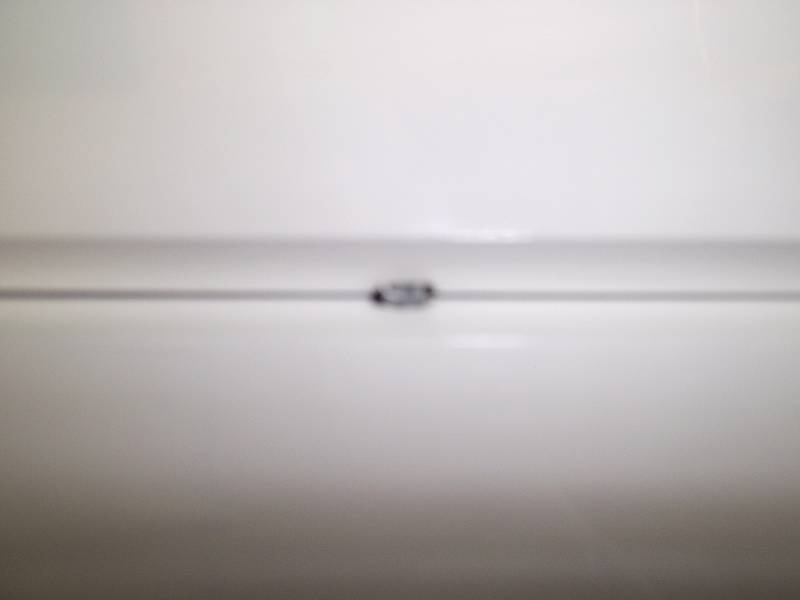

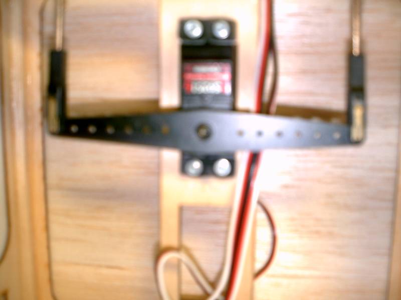

The first pic is of the finished aileron linkage; very simple and straight forward to assemble just remember to have the pivot right on the hinge line. Once you have the servos and linkages set up you can join the wing haves, for this you will need 30 min epoxy, paper towels, film remover, and a wood pecker tool. first run the wood pecker tool to perforate the spot were the epoxy will be to get a better bond then put the 30 min epoxy on the joiner, wing joiner opening and the first wing half then put some 30min on the other half and push them together firmly, wiping the excess of with a film remover covered paper towel and clamp it in place.
On to the fuse!!!! First thing to do is carefully with a sharp blade cut away the monocote that covers the stab and ele. Servo holes. Next install the horizontal stab set it were you want it and cut the covering back and use 30min epoxy to fold it in place. I am not going to explain hingeing as many people have different methods that have worked well for them. At this point you can mount the ele. Servos the same way you mounted the aileron servos. The servo arms I used were new from great planes and are metal and use small adapters to work with almost any servo!! They are very strong and look great. I used them on all surfaces. Mount the rudder servo or servos depending on your personal setup I chose to use a single Futaba 9331 servo that has more than enough torque and speed to get the job done the elevator servos are 9252 Futaba’s with 12 inch futaba extensions held together with heat shrink tube to prevent them from separating. Next assemble the elevator control linkage. I used ball ends and turnbuckles but the supplied hardware is just fine i had some titanium turn buckles left over from a Dirt oval terminator RC car still in the pack so I decided to use them. Next set up the pull pull system on the rudder every won has their own method they prefer so I won’t go into detail, same with the elevator linkages.
