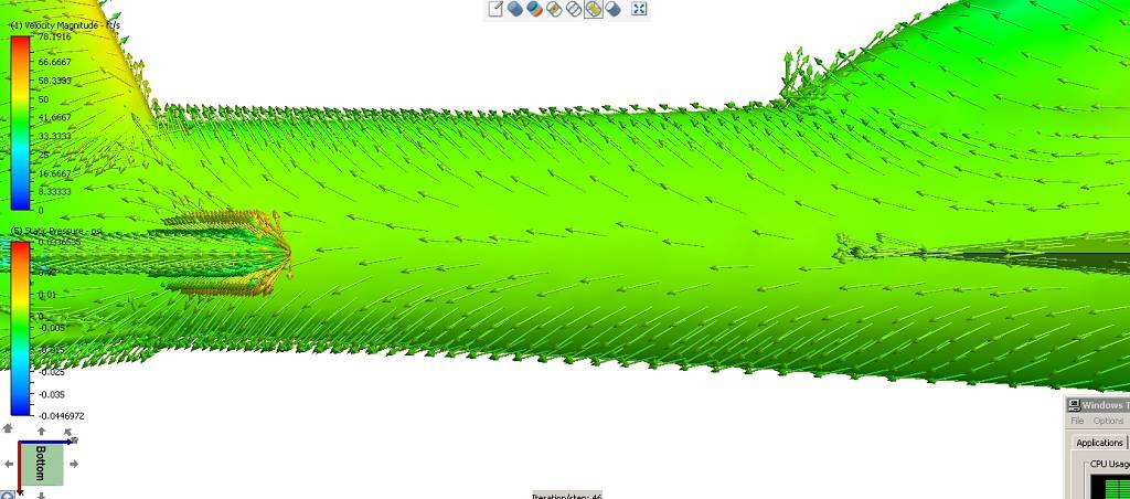

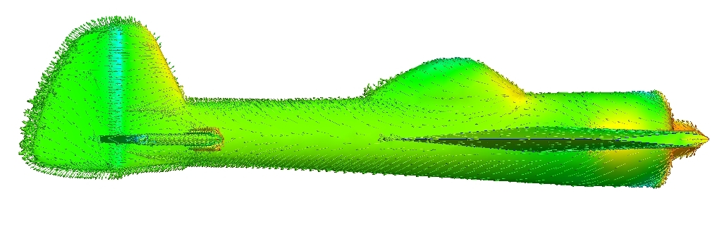

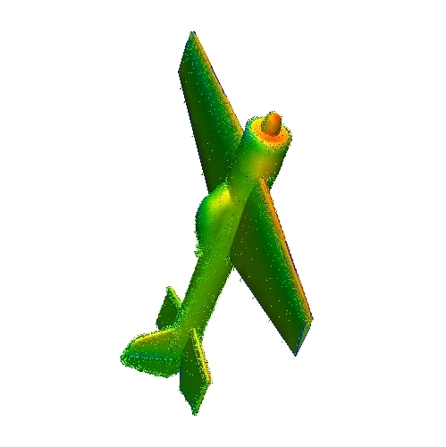

Thanks for reply. Yes, good old GIGO, but the tool I'm using is made by a professional. Though I may use it unaware I trust in it being better than me. It helps me getting aware of new aspects.
In this case, I was after only one point, the side force (tucking) the fuse might produce in knife-edge. I mentioned the cheeks because they enlarge the top-view area and thus this force, not downline drag. I think I understand that you meant the lateral flounder area producing the lift in KE.
I'm just wondering what's going on. Meseems with this thread and looking at the Z-50 I chanced upon a trick, namely positive incidence of wing and stab. When I tried, the model turned out to be still (nearly) neutral upright and inverted (as trimmed before), but now neutral in KE as well - to my big surprise. So it seems to be possible; now it would be interesting to prove it and find any requirements.
Edit: Forgot to mention that I'm talking about the simulator. It renders only the fuelages drag, side force, and vertical force in a simple manner, but no real airflow, and probably it linearizes all phenomena. So it's easy to get all-around neutral behavior - probably unlike in reality.

Yeah, that wing-fuse crossing makes for a nasty diffusor. The fillets may be necessary due to lower aspect ratio than the Zlin trainers have, so bigger AOAs. Might have to do with spinning as well (blanketing).
The Z-50 has symmetrical, good-natured NACA 0018 tapered to 0012, good for a strong wing. Together with the 0.8 planform taper the airfoil taper makes for a total 0.5 taper ratio - good for snaps. Obviously, the 1 degree dihedral is sufficient for the low wing position. Did you notice that both wing and stab have a decent positive incidence angle?
You mean the Z-50 M with the Czech inline engine (called Minor) and the bigger rudder. As far as i know, the stab is the same as on the L (Lycoming) versions. I wonder why you had trouble with the stab, but maybe it was due to the struts. The original is said to have a weak spot where the tail meets the fuse, kind of a structural bottleneck.
Unfortunately, I never flew one, only Z-142, so my knowledge is second-hand.

these images show what I was tryin' to 'splain!
image 1 shows the model in the flow domain...
images 2-5 just show the model itself
image 6 shows a closeup of the flow vectors over the aft region of the tail....
you can easily imagine a line along the fuse side that marks the "Stagnation" point.
If the stab is high, the induced flow creates an AOA that causes the stab to lift up, thus pushing
the nose down....
if the stab is low, the induced flow creates an AOA that causes the stab to lift down, pulling the nose
upward.....
As a test simulation, I placed the stab on the wing CL, cut the model on that plane, and mirrored it on that plane
to verify the simulation resulted in a net zero coupling... it did.
the nose down....
upward.....

The answer is because the stab height matters....
Try a rudder input from inverted with the mix off.... try it on a down line.....
I challenge Dick to take his plane out and do the flight test maneuvers I have suggested....
particularly.... the pull to 45 degree test.....
I challenge him to pull his trimmed plane to a 45 degree line, roll to Knife Edge and let go of the sticks....
(If his plane isn't super-nose-heavy).. it should basically follow a trajectory and pull slightly to the
canopy..... now Dick... repeat and apply rudder.... guess what... it pitches! (Unless you have a model that
happens to have the stab in the correct location)
Repeat this on down lines.... on a vertical downline, most nicely trimmed models will slightly pull to canopy.....
apply rudder.... pitch to gear....
This is fairly typical and I challenge yuh'all to try this and see what happens....
(A model that has significant dihedral or a high wing like a cub may be difficult to observe some of this phenomena as there will be
significant roll coupling to the rudder)
But with a Yak, Edge, Extra, Su etc... this can be seen and repeated....
