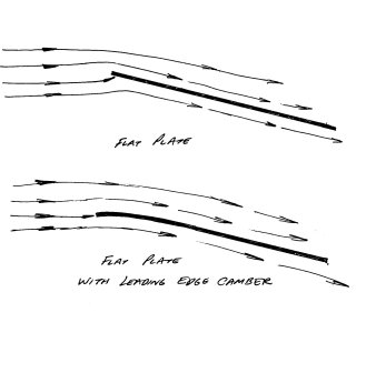

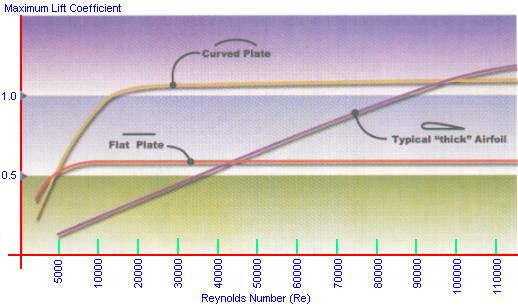

It has been found that at Re <20,000 (like many indoor R/C models and foamies), a thin flat plate actually generated more max lift than a Clark Y airfoil.
However, a properly designed airfoil optimised for that operating condition would probably outperform both of those.
One reason is that the air molecules don't "see" a thin plate airfoil the same way we see it.
Some air approaching the wing goes over the top and some goes underneath.
The point where the air splits near the wing's LE is called the stagnation point.
As the air approaches the LE of a wing with a positive AOA, it starts sensing the high pressure under and the low pressure above and some of the air just below the LE manages to sneak over the top.
This causes the shifting of the stagnation point to a spot somewhat below what we consider the wing's LE. As the air molecules hooks its way back around the LE and over the top, it rounds the shape as it goes, so the upper surface flow gets a long, curved path from the stagnation point to the wing's TE.
The result is that the air molecules "see" a thin plate airfoil with a positive AOA as it was a cambered airfoil.

RE: airfoil thickness
Thats the beauty of the flate plate!
Simple , easy to make and very effective.
The Leading Edge Sneak --is simply caused by slight pressure "bubble" being formed -as you noted .
The easy way out is --over the top
Nature abhores unbalance in pressure -so when in doubt -just look for the easiest path- that's where the air will go .
This relationship between Reynold's number and the 'best' thickness for maximum lift is a pretty fundamental one, and worth understanding. As air flows from the leading edge over a typical airfoil, the pressure goes down, roughly until the thickest point of the airfoil, and then starts going back up, or 'recovering', as the airfoil guys would say. During the pressure recovery part of the flow, the air is flowing from a lower pressure to a higher pressure, which makes it much more likely to separate. The higher the Reynold's number, the more likely the air is to acheive pressure recovery without separating. Thicker airfoils have a bigger variation in pressure over the chord, and so the pressure recovery is more extreme. For this reason, wings operating at lower Reynold's numbers cannot be as thick as wings operating at higher Reynold's numbers without separating. This is why 'good' low Reynold's number airfoils are thinner, and tend to resemble flat plates, and also why flat plates compare more and more favorably to traditional airfoils as the Reynold's number gets small. Having said that, it is the thickness that relates to Reynold's number, not the flatness. For a given thickness, the optimum airfoil shape will not be a plate with constant thickness (i.e. a flat plate), at least in terms of lift and drag. If aerobatic requirements dictate that a wing be stallable on command, then a flat plate may have some favorable characteristics, although those could be acheived by reducing the leading edge radius as well. If, in addition to the ability to stall on command, you want high drag, and don't need high lift, then the flat plate starts to look really good, especially since it is so simple to make. We shouldn't overstate this by saying that flat plates are just as good as traditional airfoils for low Reynold's numbers, even though they are obviously perfectly good choices for lots of planes.
As the Re gets smaller, the required thickness gets smaller, but there are also drawbacks for being too thin e.g., the max thickness point has to move forward and its distribution along the airfoil becomes critical as well.
If you want an airfoil for an extremely low Re that also has a wide speed range, the job gets rather tricky.
I think designing really good airfoils for extremely low Re is one of the most difficult challenges in the model aerodynamics.

I agree, but in case of an extremely low Re along with a rather thin flat plate wing, the air molecules "reshapes" the plate into a cambered airfoil (at a positive AOA).
I understand how the 'reshaping' can happen, but it is not unique to airfoils that are thin or flat, and it is not the entire explanation of the performance characteristics of thin airfoils.
Low Re airfoils are tricky, mostly because the body of knowledge we would like to take advantage of is all aimed at higher Re airfoils, and hence often not applicable. Beyond that, it is tricky to optimize an airfoil for any set of operating conditions, whether it is low Re, high Mach number, etc.
Well, you are very much welcome to provide us with the entire explanation.
