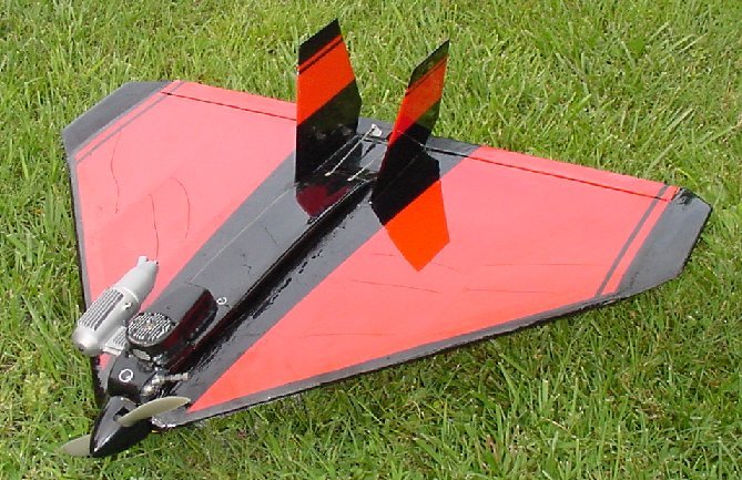

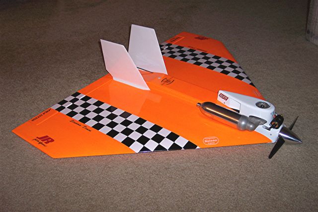

Can somebody show me a good way to cowl up a webra speed 50 on a flying wing such as a diamond dust, holy smoke etc, I looking for the type the control line guys use on there speed planes..................THANKS

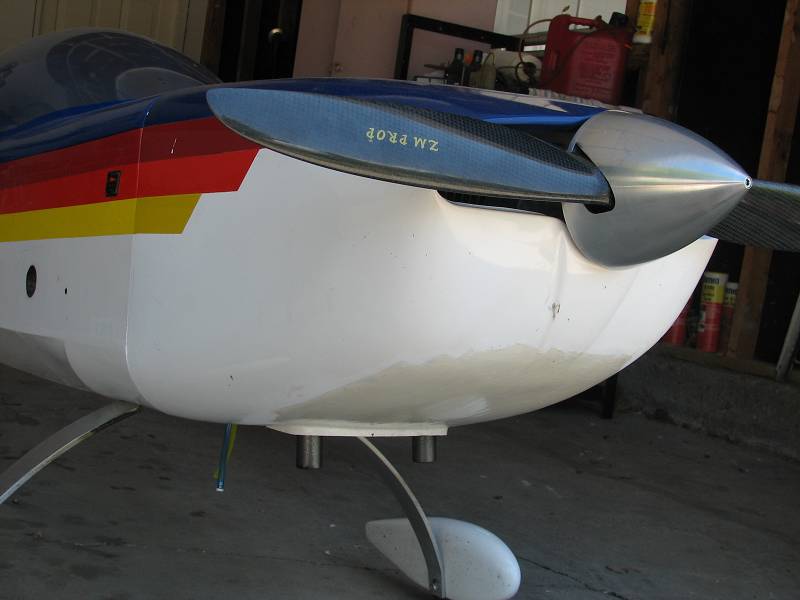

Here are a few pictures of what can be done. The first one is a speed plane at the German Speed Cup. The second one was built by one of my customers and there is some discussion of how in this thread.
http://www.rcuniverse.com/forum/m_6034143/tm.htm
It is a long thread and it is in the second half.

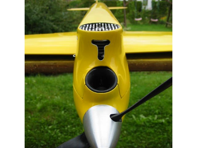

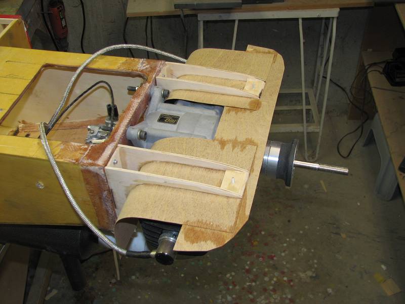

The third one is one I built for a kit I sell. It is made of contest balsa and then glassed with .75 cloth.
I have a chapter in PDF format on model airplane cowl design and building written by a well know person. PM if you are interested in a link.

I have been considering building one of your kits, the delta Im building is my own design also, I may do a build thread but Im going to test the first prototype maybe this weekend, Ive always been a fan of highspeed deltas and decided to do one based on the many Ive had in the past, I noticed yours has a box for radio fuel etc, Ive managed to build mine all inside the airfoil itself and still got a 10 oz hayes inside along with radiogear. Im going to be out of touch but I will show you my design, I think you might like it. It will for sure be the fastest Ive owned even with side exhaust standard muffler Speed 50gt. Next version will be cowled up and piped 55gt webra and a reflexed airfoil at they center section transforms to a very fast glider airfoil at the tips. layout is close to holysmoke wing sweep. may end up calling it a holys**t...........................ED

RE: building a speed cowl
ORIGINAL: SuperViking
I noticed yours has a box for radio fuel etc, Ive managed to build mine all inside the airfoil itself and still got a 10 oz hayes inside along with radiogear. Im going to be out of touch but I will show you my design, .....ED
speed cowls:
the compromise is to get enough exit flow with out adding excessive drag-
ideally you have a cavity which just clears the cylinder
the inlet size and shape must provide flow around the cylinder -all around with no hot spot left at the rear of the cylinder
So---- the streamlining of the "exit becomes the real task
unless pressure is low enough - you get no real flow thru the cowl
The cowl shapes on old models such as th DeBolt Speedwagons - is pretty good.
a rather short cowl with a tall exit.
Box shaped cowls do nothing to accomplish the real task: make the air hug the engine and have a constant flow
On gasoline industrial engines such as leaf blowers weed cutters - same engineering is used by forcing a flow from the inlet thru the fins .

Dick,
The picture of you baffel setup on your twin clearly illustrates the method of keeping the airflow over and around the engine cylinder. Andy Lennon also stressed this consideration in his book about model airplane desing in the section about cowls. Another point he made is one regarding allowing for an area for the heated air to expand before you send it back out of the aircraft, he mentioned the possibility of using this thermal expansion to creat thrust. But as you said is we need to get the exit flow to work without adding excessive drag, wouldn't a exit at the rear of the airframe serve this purpose?
I am concerned that the hot air exit can cause drag over the rest of the airfram by causing a seperation bubble to occur near the cooling exit and increase the drag caused by the airflow seperating from the wing.
Then on top of that is another consideration, with a high speed aircraft the volume of air moving through the cooling system becomes a consideration. I have notice that many of the exotic speed designs have very small inlets, my understanding is that limits the volume of air moving through the cooling system. The reason for that is as I understand it much akin to the "windchill" aspect that we hear often in weather reports, where the speed of the air enhances the cooling effect.
But to go even one step further when designing your cooling system, shouldn't we take the type of airframe into consideration when we are venting the hot air out?
The inlet is a strange thing to analyze -
It appears to be a "ram air " inlet - it isn't.
actually -the air behind the prop - at the base of the prop -is somewhat stagnant (?)
What I mean is that it is swirling and moving outward at that point on the prop--so no air is being rammed into the cowl.
The exit air (lowering of pressure in the cowl) is the controlling factor.
a very small inlet does the job as long as the exit air pressure drop is sufficient
you can theorize about this ----but in real world application - -you have to cut n try
the why is because the engine heat will vary -(obviously ) as power output increases
Higher speed will produce more effective low pressure so that can appear to be a self controlling (closed loop setup) - but it ain't.
You have to sneak up on the setup.
the why is that the power -while increasing -tries to increase engine temp - which is not wanted -- so--you have to have the setup matched for the wortst case (most power) scenario.
On the big twin --lots of guys got this wrong -they figured air rammed into the cowl - which is not so -
Here is another pic of that setup which has a very small inlet and a HUGE low pressure setup. on a .50 glow enginbe --this is all far easier as alky fuels cool much better than gasoline fuels. ( fuel to air ratio) The large bowl shaped cowl has as it's exit a semi circle with a lip on the LE to cause lowered pressure. The engine ran very cool under all conditions
