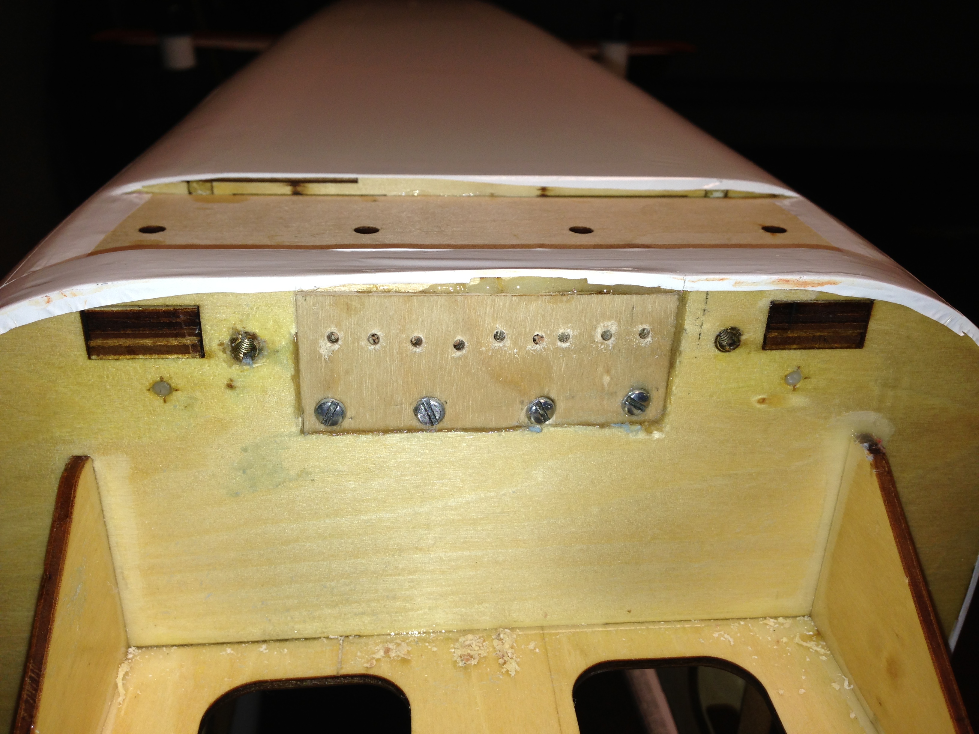

If you are looking for one or two pointers on the build I do have one. the landing gear is the only weak link here. But making it stronger where it is needed is the trick. I always make a splice to tie the two piec landing gear together. also just as important is to tie the leading edge of the landing gear block to the firewall. Not the way GP did, with a triangle stock pinned with wook pins. But with a piece of ply on the front of the firewall. It is critical to pin this ply to the center leading edge of the LG block and tie this to the firewall with glue and wood thooth pics or screws. But with the cowl ring, this will need to be flushed to the firewall. Something like a door hinge is. this will all help reduce the chance of ripping off the LG if hitting a small object in the grass or keep the LG block from being broken in half by a hard landing.
I have had ALL the Revolvers and quickly learned to do this to all of them.
Let me know if you need photo's on the Revolver 50 cc on how I did this.

I've read the different threads, and haven't seen issues reported with the 50cc gear? I have one completed, ready to maiden, and noted that the gear reinforcement seems to include two fore-aft 1/8" CF rods that go through the firewall, then through the ply landing gear plate, and into the bulkhead behind. Seems like that addition would add quite a bit in tension / shear, but of course don't know, 'cause I've not flown it.
Pondering just changing to CF gear from a 50cc Sbach - gets rid of that rearward sweep, which also must reduce the pullout forces exerted?
Looking at the two smaller Revolvers, the LG plate seems to be attached differently, and isn't recessed into the bottom of the fuse, but hard to tell from pics in manuals.
Anyone with specific info about the 50cc version and this issue?

Bob, unless they have recently changed the structure there are no CF rods in the 50cc Revolver. Or you are reffering to another aircraft. I have had 5 of these aircraft, 4 of which I still do have. And early on it has been my experience and the experience of at least 3 others at my club to have had problems with this gear. So my advise to all who want to avoid having the wheel pants punch holes in the bottom of their wings and peal the bottom monocote off, please take this seriously.

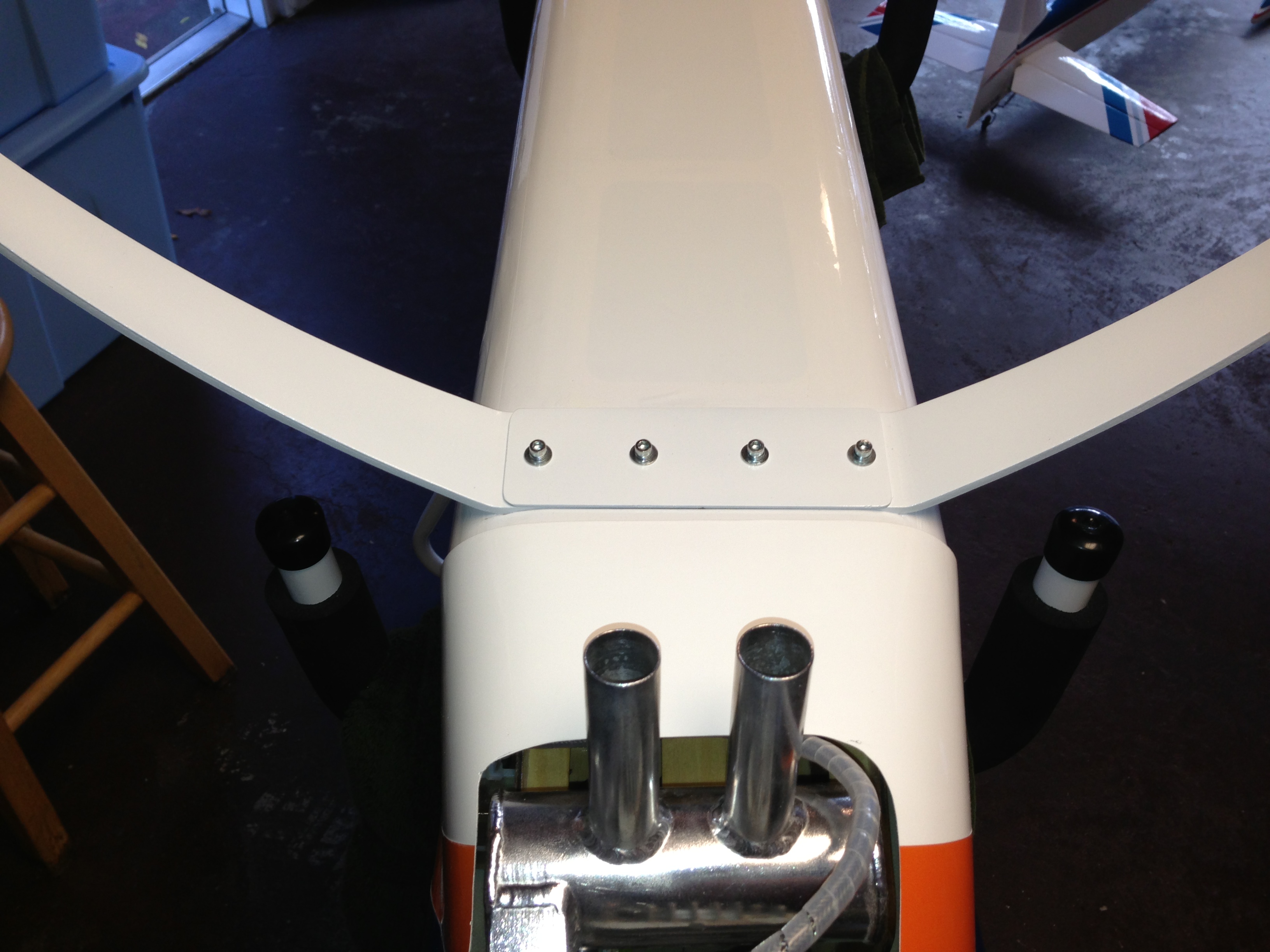

SInce you have the 50cc, would you post a pic or two of your mod, if you don't mind?

As you can see in the photo's, I painted the LG and splice plate. The splice plate aides in preventing the LG block from splitting in half on a hard landing. The ply plate on the firewall ties the LG block to the firewall better. There is just too little meat left at the bottom of the firewall to prevent it from being ripped out from the shearing off of the LG. Now Great Planes did pin the triangle stock to the firewall to try and strengthen this, but it is a weak effort at best. I wrote them about this a few years ago on the first two models. I guess this is their response to this on this newest model the 50cc Revolver.

Thanks. I'm assuming that the plate is just an aluminum plate bent at 90* at the firewall, extending rearward as one piece to the rear of the landing gear block as it exists? Interesting fix, looks like it definitely would be up to the job.
