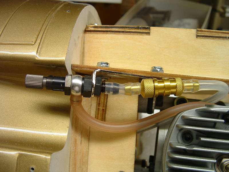

cstevec, attached are the pic's I have promissed on the OS-1.60 FX remote needle install into the right fuselage exhaust opening. Works just fine. What you do not see in the attached pic's is I put a T into the fuel supply line just ahead of the filter and ran it to the bottom of the firewall with a plug in it. To fuel, I remove the plug, insert the fueling line and pinch off the tubing from the needle to the carb thru the right fuselage exhasut opening. You could of course install the 3rd tube to the fuel tank for fueling.

No issues at all with this needle location, I have done this before and since this is a pressurized system, it works very well.

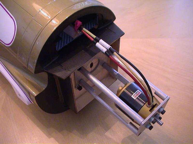

Well, I haven't flown (yet!) but decided to post a few pictures and motor details for anyone interested. Some folks say WHY convert to electric, especially this plane but I think it is a perfect candidate. 1.) The weight is well within the limit for e-power. 2.) The fuse is HUGE inside, making battery mounting a cakewalk. 3.) Of course it is a sweet looking plane too, which makes it even more fun to fly and have folks ask "what engine you got in there?!" only to watch their jaw drop when you tell them it's electric.
Here are some pics of the engine mounting, including a view of the enlarged reciever battery area which has been modified to vent the LiPo packs rather than mount the RX battery.

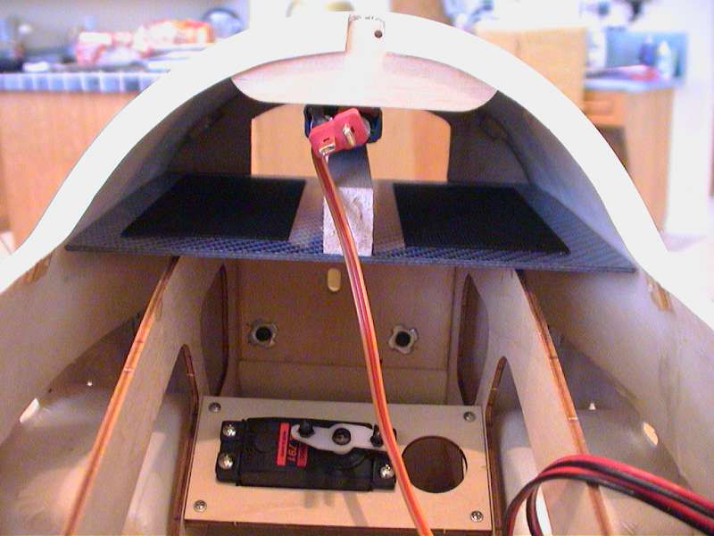

Here is a better view of the battery tray (made with carbon fiber reinforced sheet). This tray worked out great allowing airflow over the LiPo's to help keep them cool.

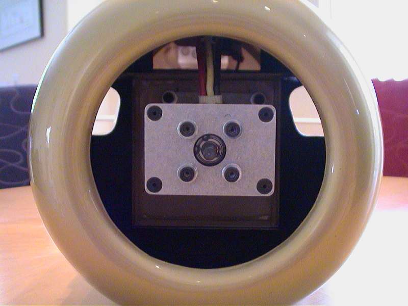

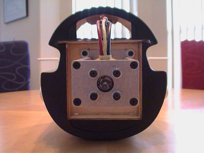

To convert a plane to electric, serious thought needs to be given to changing the batteries. I had a Lexx pattern plane (designed for electric) which had to have the wing removed (4 nylon bolts) each time the battery needed to be changed, not a good design! All the conversions I have done since, have an easy way to change batteries (belly plan works great!) without removing any bolts/screws. Some may wonder whats the difference but when the battery is connected, the motor is "hot", any glitch could cost a finger. Making the bettery tray easy to open makes connecting up very quick right before flight.

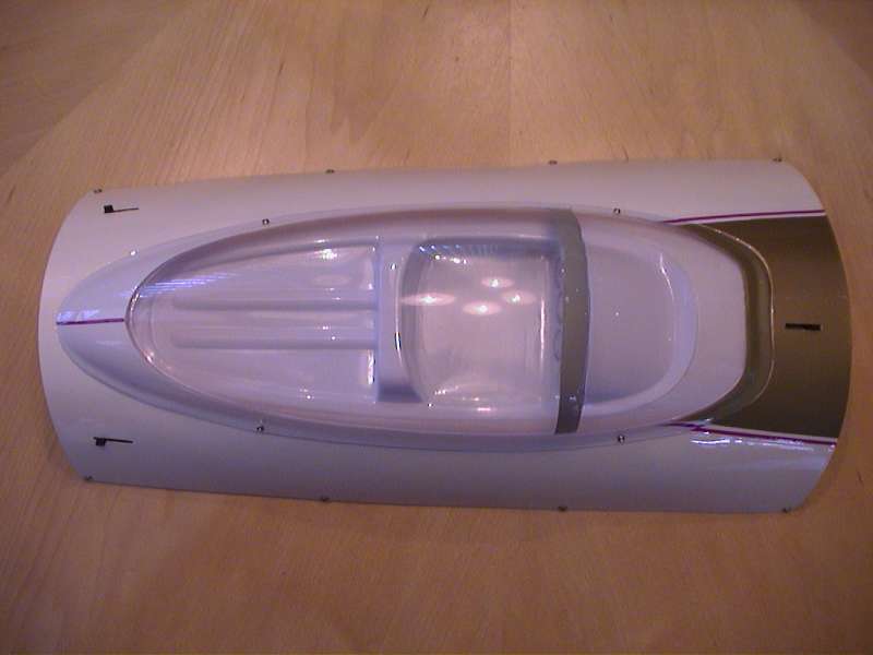

Here is how I handled the Rare Bear. The fuse hatch was modified with a wood frame to exactly fit the opening. 2 pins were added to facilitate lining up the hatch and holding it from shear force while 3 BVM jet latches were added to hold the hatch in place. I added the screws because I thought it looked better, they are simply ground off on the other side giving the appearance of a fastener.

Yes, it is an Axi 4130/16. It is rated for models up to 16 pounds (gliders really, sport planes up to 12 pounds according to closer reading). The mount is from Esprit Models (select the front and rear plate for your motor type then order tubes in whatever length you need, sweet!) and the speed controller is a Jeti Advance 77-3. I plan on using the same battery configuration as I have on my current planes, Thunder Power 6S2P (2 x 3S2P 4,200 mAh G2 packs in series) because I believe performance comes more from less weight than battery overkill. If the flight time is less than 10 - 12 minutes, I will move to 6,000 mAh packs but likely stick with 6 in series.
MotoCalc did a great job with the predictions (they match te actual Amp and Watts within 5%), the folks that wrote that little program have done a great job!

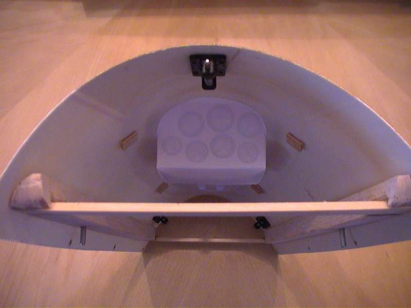

Guys ...
Opened the Bear box today ....Wifey has gone to London......when the cats away the mice will....anyway you get my drift...great quallity, this kit seems to have some beefed up L/G blocking..will try to photo later..just weighing everthing...going to look at moveing all the radio as far forwards as practically possible..... not a great deal of wing on this thing so dont want to add too much dead weight ....the spinner and eng mount weigh 1 Lb between them..[:-]...
