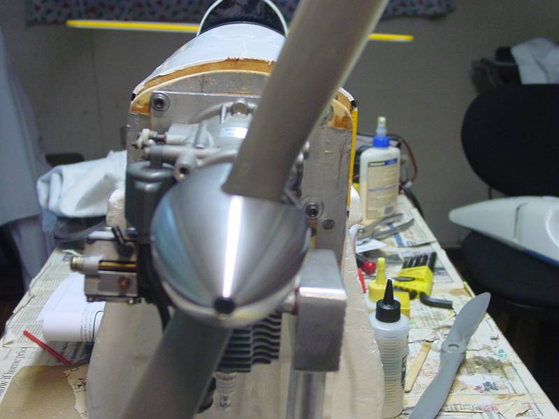

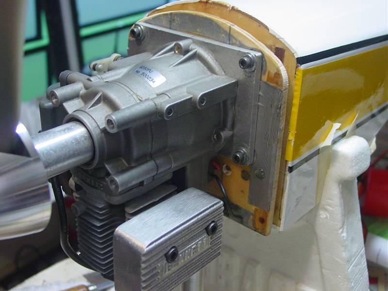

Here's my G23 installation, I used a double firewall to get around the triangle stock the aircraft came with on the firewall.
With a 15x8 APC it flys very well.

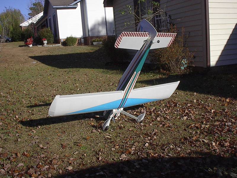

Here is a picture of mine. The canopy was shot off by an evil Nazi on its most recent flight . . .

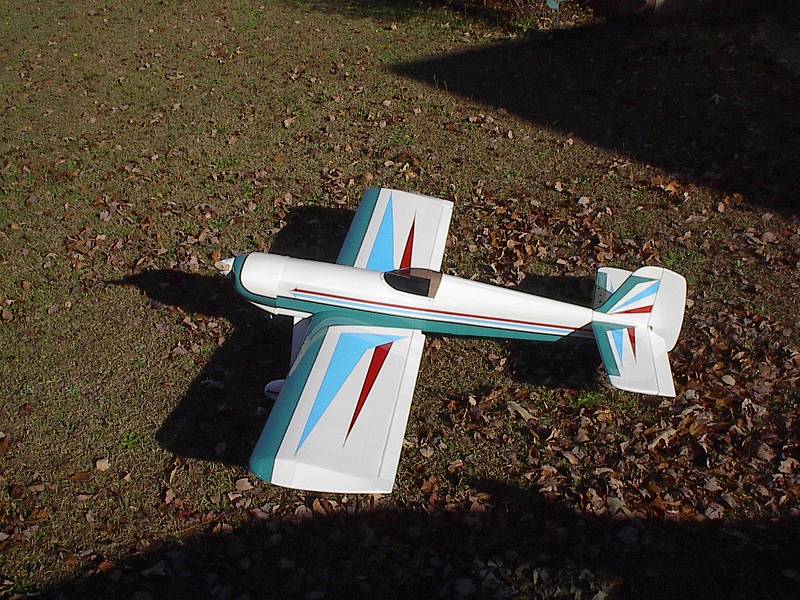

My DL is finally finished. I stripped her down to the basic white and re-trimmed her using Teal, Neon blue, and Red. The cowl was sanded down and re-painted to match. The canopy is from a Pulse 40. All the radio and servos are inside and power is a Super Tiger 90. It needed a little nose weight to balance and is now ready for her maiden flight. I haven't had a chance yet to fly her but I'm looking foreward to the chance. I thin she turned out pretty good. (Proud Papa)

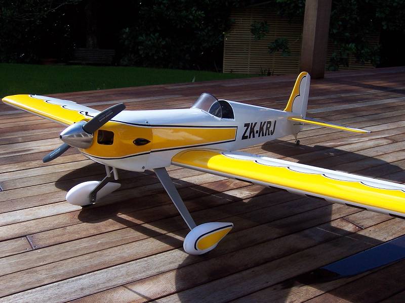

I sold my DragonLady a little while ago - had an ASP 91 in it, it was the nicest plane to fly, so relaxing and enjoyable!!!
Just wanted to say...... enjoy it - Awesome choice of plane!!!!!!
