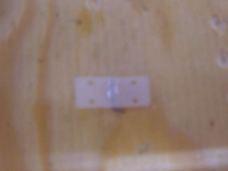

Hi and thanks for the painting link. FYI on the type of hinges supplied.... they have been known to slip out even after they have been glued in. If you glued them already to one side of the control surfaces I recommend drilling a small hole thru the control surface and going thru the middle of the hinge closest to the control horn and CA in the hole a leftover piece of clear pushrod tubing. I just went ahead and used the DUBRO plastic hinges but will still be doing the above recommendation even so. Also take great care when getting the elevator ( if you have'nt already) making sure both of the elevators will seat well and level into the u shaped control rod /hinges. make a few dry fits to get right before gluing. I also am working on a way that will allow me to quickly change out the aileron servos between both wings so I won't have to by another pair. By the way I am using the Hitec HS-55's. I am stuck in the house all weekend here in Atlanta with an ice storm so I will be checking the post for your reply and any other suggestions. And in the words of the owner of Atlanta Hobby.com "Cliff" GOOD WINDS !!!!!!! you guy's ought to check out his online store he is for sure one of the best and honest hobby store owners you would ever do business with.

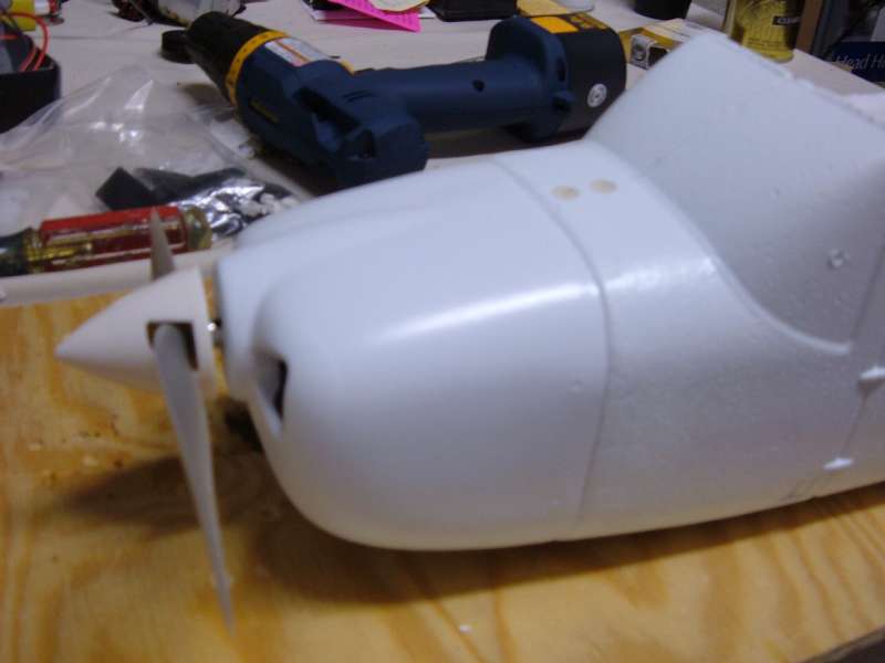

Hey VF, just a quick note on the prop set-up. there are 2 plastic washers included with the APC prop and the instructions do not make mention of them. ( I also used this same prop on my PIGI3D) Anyhow make sure you use the bigger of the 2 and you will have to hand tighten it as it is a little tight so it will screw down like a nut.so in step 15 there is 1. 3x3 screw 2. 12x5 washer 3.spinner base (4. plastic washer) 5. prop ( also be sure to shave off and lightly sand and plastic flashing so the prop sits flush) 6. 12x5 washer etc...by putting the washer in your prop will be much more stable and will not have to reley solely on how tight the M5 nut it for stability. This kinda works out cool that I can add hints to the post as I'm building as my PC and workshop are all in the same room !Later man and hope this helps

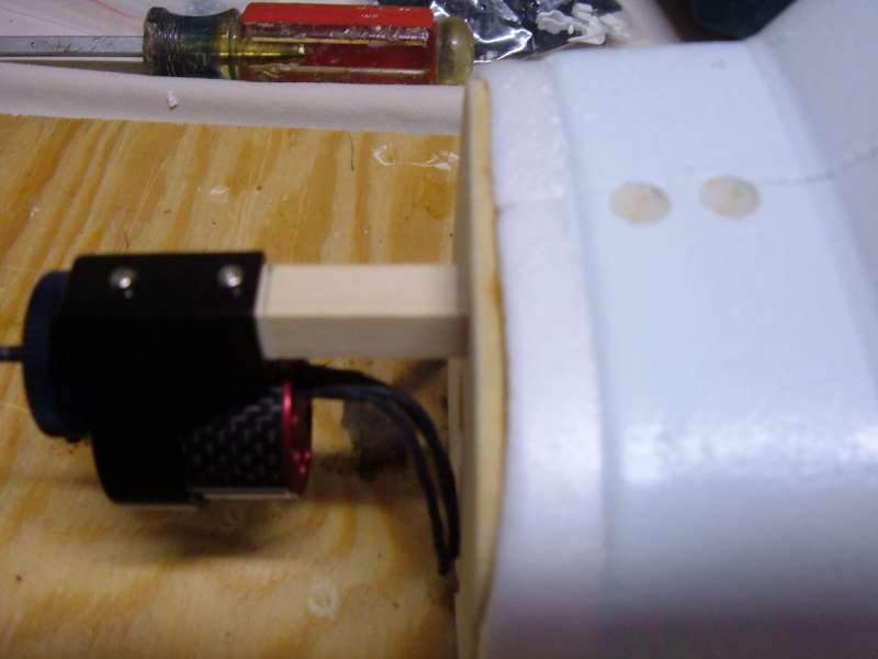

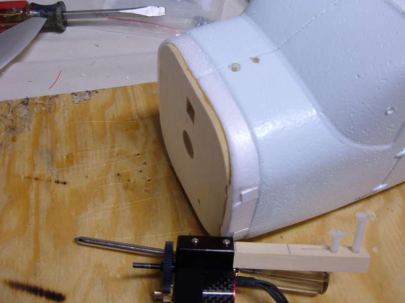

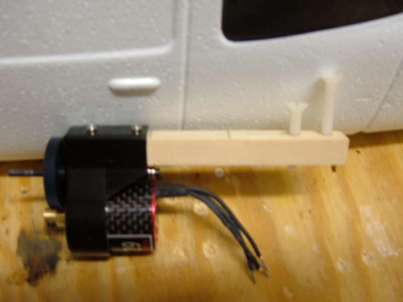

Hey VF, I got the hinges at Atlanta hobby I am going to try and post a few pics plus I have some shots of how I am going to use 2 nylon screws to hold the wooden motor post. note the 2 holes on the top of the fuse in front of the window. I am doing this to make it easier to repair/modify.
Join Date: May 2004
Location: mableton,
GA
Posts: 50
RE: Ultrafly Cessna 182 ARF
pic of the motor post installed. by the way it is a very solid fit and hold and by having it out an 1/8" more I did'nt need to drill an access hole.
