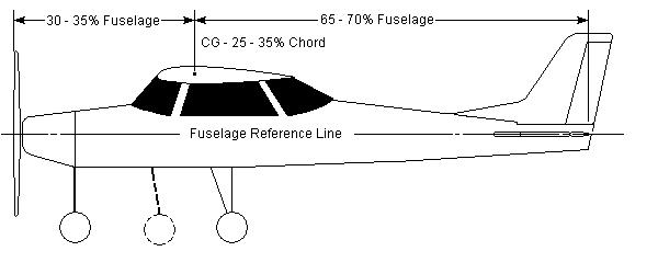

For future reference, the normal CG for a straight winged, constant chord wing is approx 25% - 35% of the chord width from the leading edge.
http://www.uoguelph.ca/~antoon/hobby/pmdesign.htm
