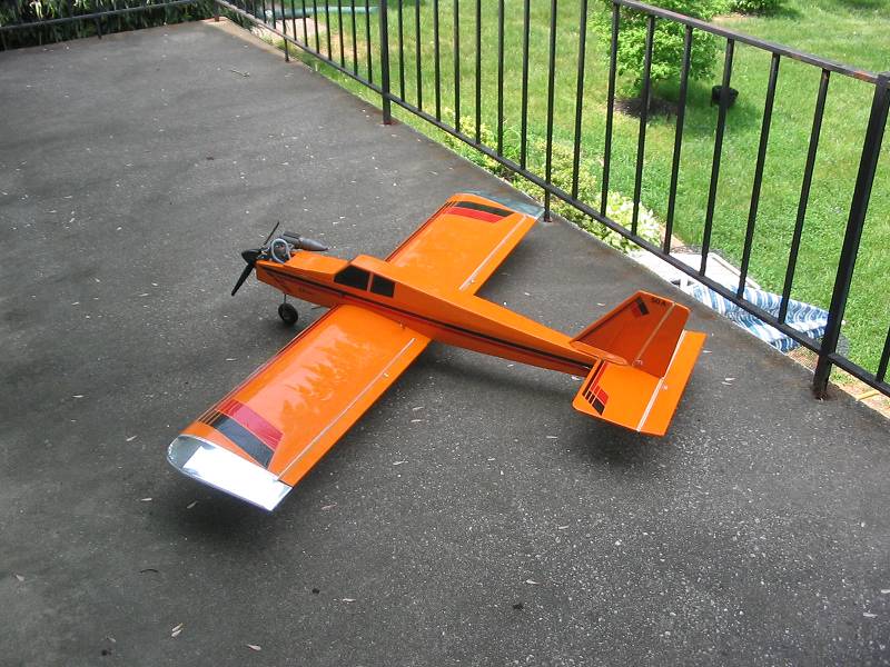

Here are the pictures. The particulars are as follows :
1. wing span 60 in
2. wing cord 11 in
3. length 44 in
4. Weight 5.5 Lbs.
This gives a wing area of 660 sq inches and a loading of 19.2 oz/sq ft.

Still have no idea as to the mfg. sorry.
balance point? OK, Do you see where the leading edge sheeting stops at the wing spar? If you balance it there or JUST barely in front of that it should fly. I would recommend an experienced pilot take it up the first time though. It might be tricky. Once it flies you can adjust the balance to suit you. Just don't go too far aft.
Looks like it will be a fairly good flyer if that helps any.
Can you tell by the construction if it's a kit or ARF? I'm thinking ARF due to the striping.

Thanks for the reply. One of my cardinal rules is to always have an instructor fly my planes for the first time as I have no ego to feed. It is definately a kit and was originally equipped with a single aileron servo. After I do some minor housekeeping I will use the end of the leading edge sheeting as the balance point. Thanks again.

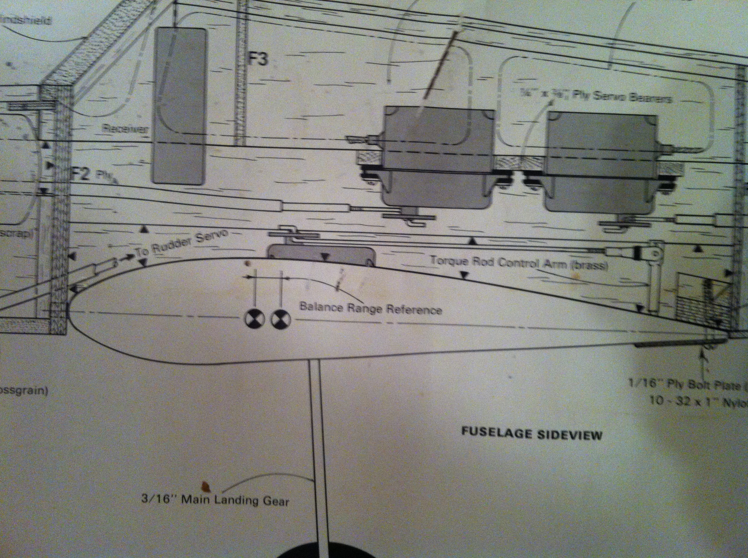

Hey there! That is a Northeast Aerodynamics SPORT AIR 40. Produced by Northeast Aerodynamics, which changed to Northeast Aero, which went out of business about 2 years ago. That was the 2nd plane I ever built back in the 1980s. GREAT second plane, or good first low wing trainer. It can be a little fast for new flyers, and with the semi-symmetrical wing it will NOT float like a flat-bottom top wing trainer. The semi does give you a chance to do some fun aerobatics, though. Start out slowly and carefully with a good instructor and you'll be fine.
The balance point is shown in the attached photo. I still have my blueprints from 30 years ago for this one. See attached.
Good luck! It's a fun plane. Kevin
