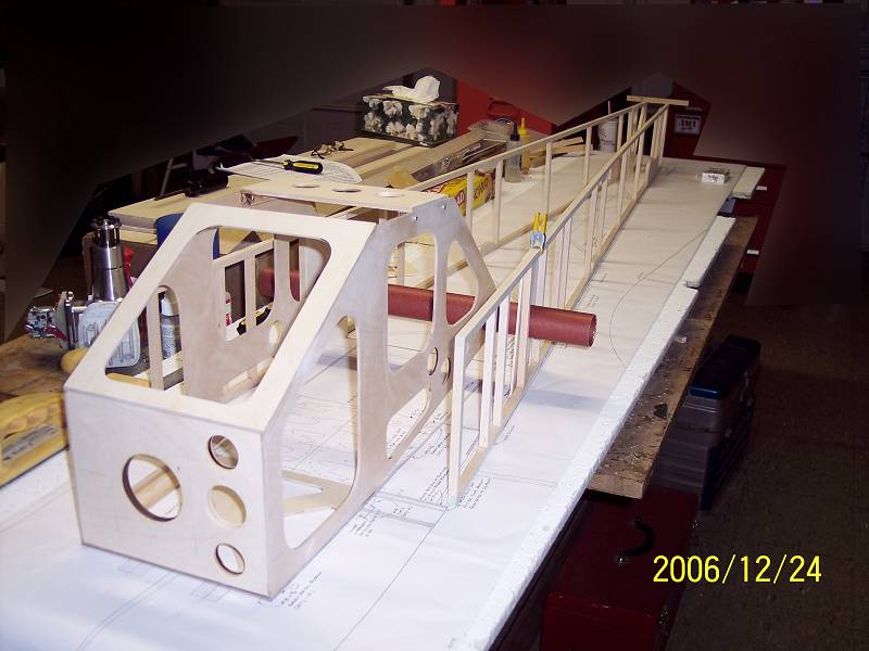

This 40% 260 is expected to weigh 28 lbs, and it WILL fly on a DA 100.............
Stay tuned..........

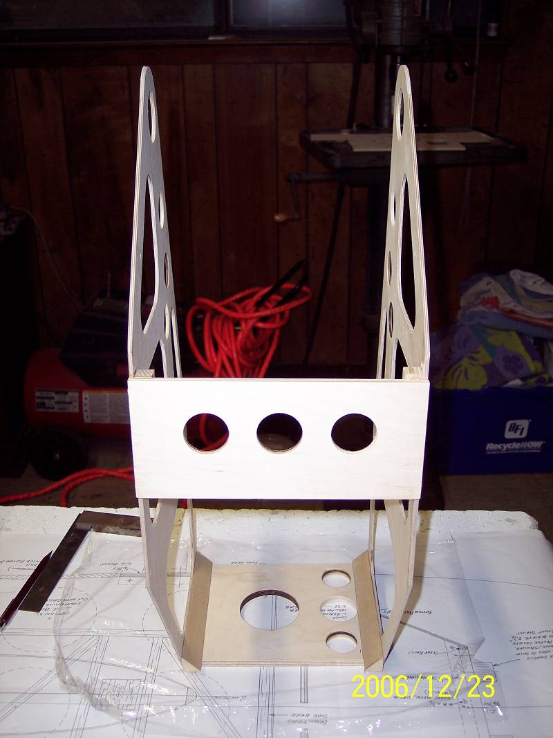

The motor box started out at 3lbs...

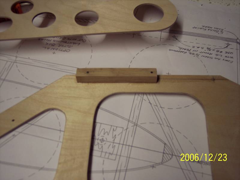

Lots of area to reduce weight

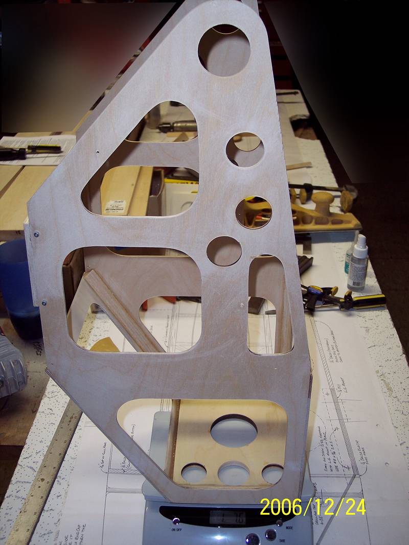

The final weight of the motor box is just over 1 pound 7.6 oz.........

I think you'll be lucky to get it down to 32 pounds with a 100 but more importantly I don't think it will balance with a 100. Good luck with your project.
Albert

you might want to look at the evolution 116 engine from horizon hobby. its about 1 pound heavier than the DA, which will help with balance. also it has more power than the DA, which will help with power and turn a bigger prop (30x10 i think). AND on top of those, its the same price!!

I really enjoy seeing these ambitious projects. I'll also be watching this one as it goes on. For what it's worth, here's a couple of inital thoughts.
If you had to, you could consider moving the wing tube back- maybe as much as an inch. This would help with your balance.
With regards to engines, the DA 100 is an excellent engine- and would (and routinely does) power a 28lb plane nicely. For "killer" power, most any 100cc class engine would probably be at the upper limit at this weight. Also factor in that it's not only the weight of the plane but also the sheer additional size that would need to be yanked around.
I have never actually weighed an engine but, going from the various distributor's websites, you might find this information interesting:
DA100 5.8lbs
Evolution 116 6.86lbs
ZDZ 160 Champion 6.5lbs.
Even at say 30-32lb, a 40% Carden 260 with a 160 would be insane.
Just food for thought.
Dave

I like what you're doing with the motor box. Even with that, you've got quite a lot more weight to take out to get to 28lbs. I hope you make it! At this point, you might want to think of pull-pull rudder AND elevators as you might need to take the elevator servo weight out of the tail to balance something like the BME. Easier to design it now than after you're covered and painted.
Best of luck with your goal...........Mark

I think the motor box top plate goes on after the fuse sides are attachted to the motor box. With the plate on the box is an 1/8 down.[X(]
