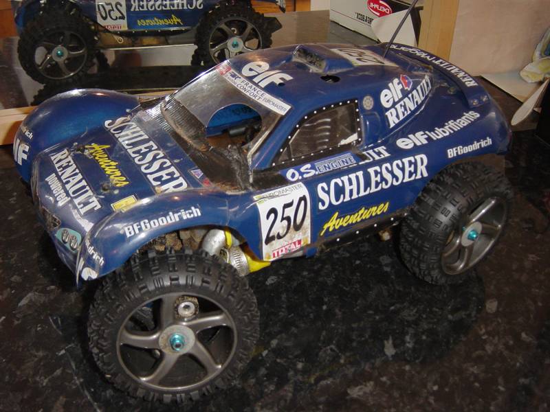

seein as azzman is ignorin me - i got on with the 1/8 buggy wheels that Rolland recommended to me - lol check out this little beasty - im not sure what to make of the look of it - but it looks a lot better than with the truck body on there with these wheels. gonna give it a run today if the weather holds out for me.

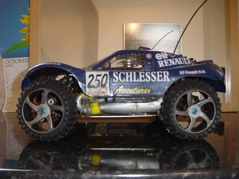

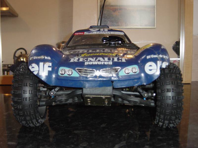

PJ, that thing looks awesome! Those wheels and tyres are perfect with that body. Almost looks 'factory' with the body on it, good work mate.

Rolland is a very wise man!
those wheels make it handle perfectly on the beach. it takes off with one hell of a rooster tail, and builds speed a lot quicker than with the tmaxx wheels n tyres. it was into second gear just about straight away and the handling was just as good at high speed. Finally some good power on steering, makes me question the need for a centre diff really, for my purposes at least. i could roll it if i really went silly with it, but surprised me with just how well it stayed upright, especially in the deep soft stuff.
Trouble is, its that enthusiastic with the power, my 2 speed appears to have blown up somewhat... suspecting a collapsed bearing, its all looking a bit sorry for itself in there. single speed coming up, will use 39t spur and 15t pinion, ie 2nd gear only - it really doesnt need 1st with these lighter wheels.
thanks Rolland, i really didnt expect it to handle quite as well as that!

I was totally blown away by the handling of the 1/8 scale buggy wheels myself. On a high traction surface the differance is even more noticable and with the right suspension setup it will fly around corners almost as well as an onroad car.
Eventually I am going to try the XTM XLB's wheels and tires to see how they handle. They are almost the same size as the MT tires but they are still lighter.
The Schlesser looks real good with that wheel combo I might have to get one myself.

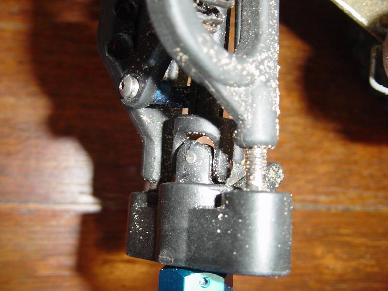

its a bit cheaper to do Rollands buggy shaft mod, u wont have the twisting shaft issues or have to cut up 4 cen cvs to do it his way - have a search or pm him etc, i cant remember which thread it was in

i guess my mod is cheaper - check the posts on what parts u need and issues/probs [link=http://www.rcuniverse.com/forum/m_2748818/anchors_2748818/mpage_1/key_tmaxx%252Chubs/anchor/tm.htm#2748818]here[/link] if you didnt already.
its not as tidy as rollands, but its all held up pretty well.

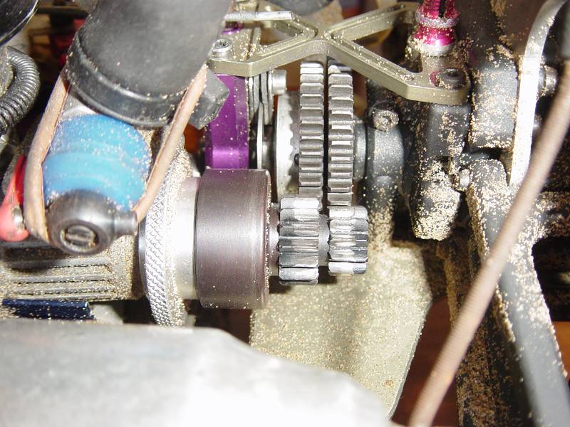

just got in from a little beach bashing session. had some high tides so all the beach was hard, flat and very smooth - ideal for high speed testing then!
still using the 1/8 buggy wheels, new 2 speed works very well, engaging just a little early... very early with all the wheel spin from a standstill. had a wheel fly off, which is always good to see... then something strange happened - i realised id lost 4wd, but hey rwd is funny with this thing, but the brakes came on the front wheels by themselves and it stopped but i still had throttle control and rwd.... as soon as it stopped and idled, it started going backwards! uphill!! lol, i couldnt see anything obviously wrong with it so, very confused, and low on fuel - i called it a day.
turns out the balloon i used on the throttle servo had caught the prop shaft, wound around it tighter and tighter and caused the set screw on the cup to slip. it must have released itself then caught again to act as a front brake only, and then unwound to make it go backwards.
sounds dumb now, looked funny at the time tho - forwards. stop. backwards, stop... again and again.
decided that taller pinions are a good idea. seeing as i could just get away with a 14/18 combo on the tmaxx rims, i dont see them being any problem at all with the buggy wheels, i will see what ofna/hobao have to offer, as the engine is easily *****g out on these ratios.
engine took some retuning today tho, it wanted a load more fuel on the hsn, nearly half a turn... ah whatever keeps it happy suits me. its pretty cold out tho, northerly winds too - not nice, may well be my last beach session for this year. the centre diff chassis might get something done on it in the mean time, see how that performs onroad maybe.

With the colder, denser air nitro engines will need more fuel to run correctly.
You can get some on-road tires for the buggy wheels and do some serious high speed runs providing you could find a lot big enough.

aye - i expected to have to run a bit richer, but not half a turn - the os is nowhere near as picky as that. not a prob tho.
as for onroad tyres... that centre diff needs finishing this winter, and thats going to be my on road toy, either with the centre diff or back to the high ratio 2 speed, got to sort some suspension settings out for it tho - fine on gravel and roughish stuff, but a bit pants on smooth tarmac. i will just use the stock buggy tyres to try out the 28. pinions for that are on order - 13/17 and 15/19 ratios are on order, so they should cover me for any size wheels as i have an 11/15 on it at the mo.
also ordered some proper ofna 17mm hexes for the tmaxx shafts, some proper ofna shock mounts and standoffs and just won some romulins on ebay for £1.99 - ok they are blue... but for 2 quid, who can argue...
gonna try hardening the new pinions a little as even these ofna ones are wearing a bit quickly on the cen spurs, but then the pinions are only small - the spurs still show hardly any sign of wear after a gallon and a half or so!

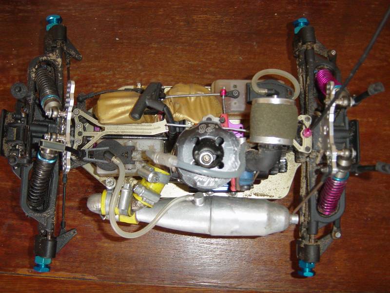

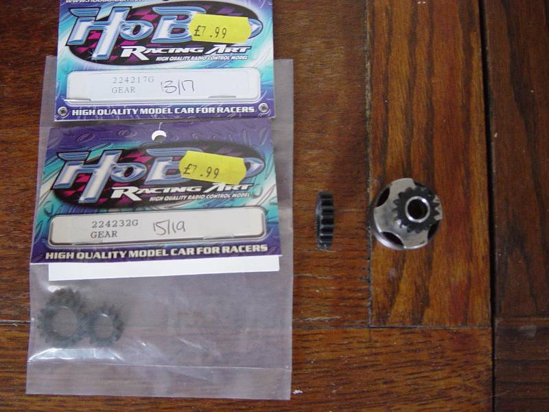

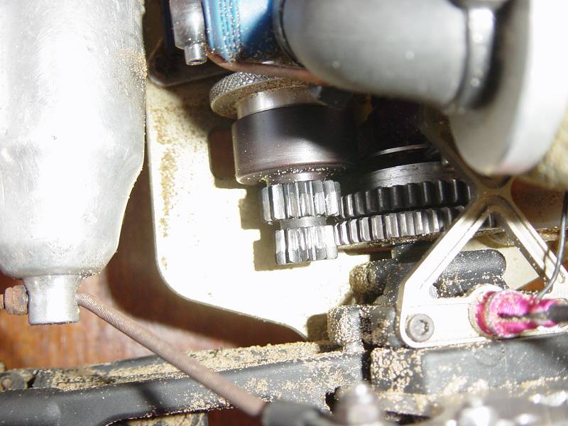

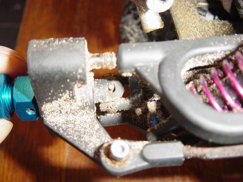

a little photo update for u - wear n tear and new bits
theres the state of my pinions and intact spurs, a bearing failure "trimmed" the pinions, but they still work ok for now. the rear half shafts/cvds/call em what u like, are due replacement - ebay and £3-4... fronts are like new tho. shot of ofna hyper 10 pinions and part numbers, only 1st gear suits the cen bell btw. new 17mm hexes are just the job, as are some proper shock offset thingys.
genesis pinions, associated bell, hyper 10 bell and softer shock springs and fluid are next on my list - it handles very well with the buggy wheels, they dig into the beach unlike the tmaxx wheels which understeer too much... got some new tyres coming with some new wheels too, will see how they work out then try suspension settings again - more pics soon if they ever arrive...
