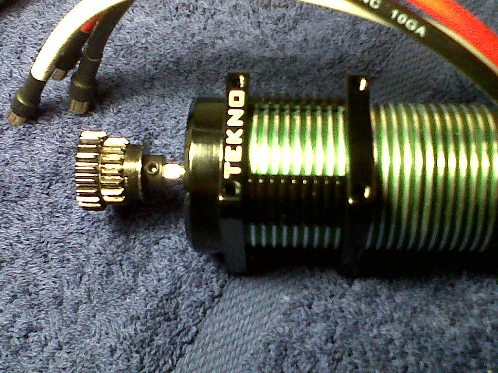

I see RC-Monster have a 2-speed pinion converter for 5mm motor shafts. With that on the brushless motor shaft, no modification is needed besides bolting down a motor-mount like the one from Tekno RC. Did anyone ever try this combo and would a strong (1600kv) brushless motor driving a 2/3-speed gearbox actually work?

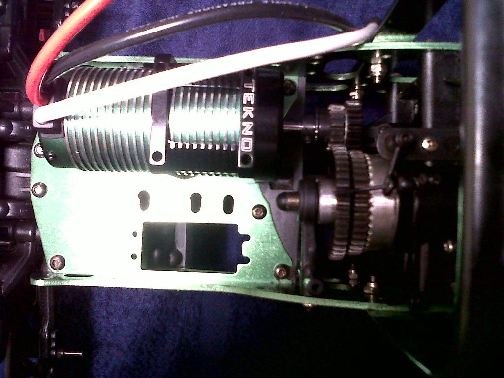

The Tekno Electriclutch is fine, but it only has space for one pinion. If you plan to use the stock 2-speed gearbox, you'll need both (17t/21t) pinions. I just finished mine. The stock pinions fit nicely onto the outer part of the RC-Monster 2-speed pinion adapter. That sorts out the pinion issue. The motor mount is Tekno-RC's motor mount for Castle motors. Now to figure out a way to mount the 2 battery trays...? (Sorry about the picture quality, its cellphone pics...)
Braking will be done with the throttle/brake servo via a Y-splitter cable from the Rx throttle channel. The ESC will be set-up with no braking and no drag-brake, that will be handled by the servo. Haven't done it yet, but that is the theory...

The space next to the motor is just a tad too small for a Mamba Monster ESC. Damn! Anyone know of a good way/place to mount the ESC?
