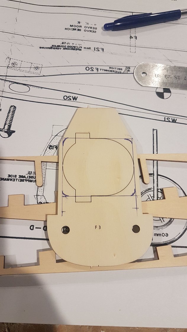

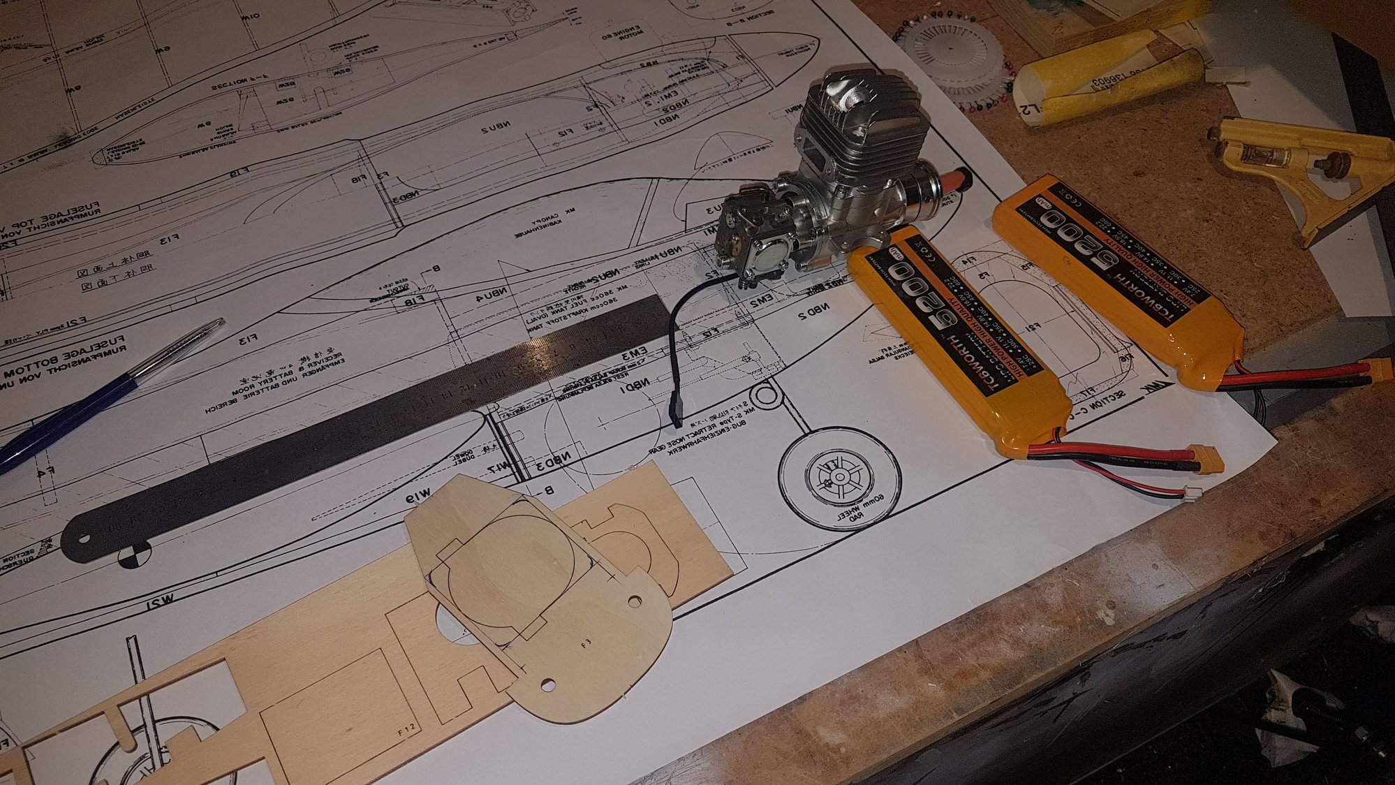

I've been looking at the fuselage plans before i start glueing anything together. Because i will be using a petrol/gas engine it needs a little more planning. It is about an inch too long for the design amd reading 8178s comments around the tendency for the swept wings to make a plane nose heavy, extending the nose isn't an option! I found and ordered a fuel tank with enough capacity but is significantly shorter, but former F3 will need some surgery as seen in the photo. On the plus side, the motor fits perfectly between the hardwood engine bearers. I will also need to move the nose keg forward an inch, for a longer undercarriage to accommodate a slightly larger diameter propeller. Pretty happy i figured this all out now before its too late!

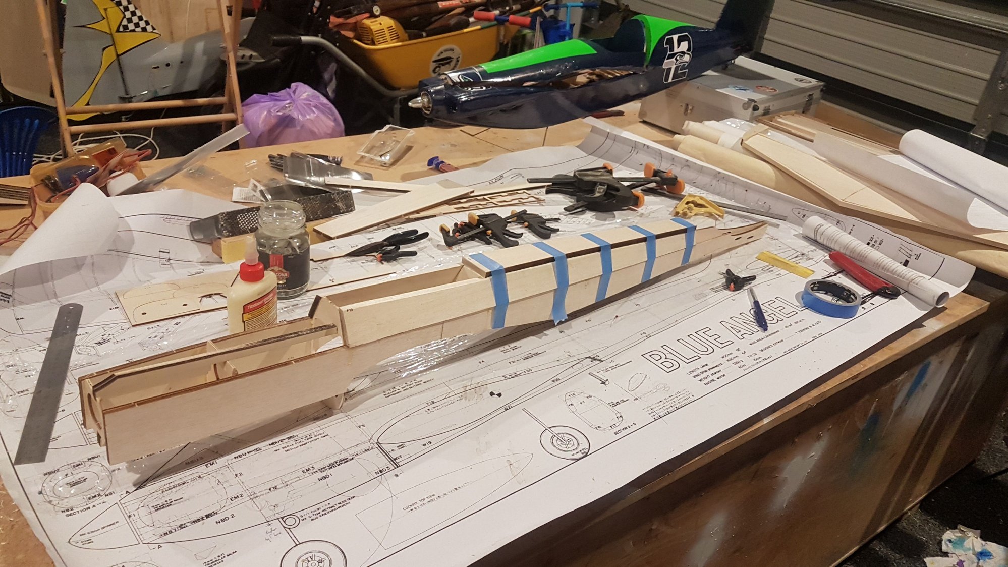

After a bit of a hiatus I'm back on the Blue Angel build. I butt jointed the fuselage sides and added the ply doubler- weighed down with a toolbox to keep it flat. This short kit has ply engine bearers that need laminating together so have done that.
a few rechecks including everything held loosely in place with painter's tape and I'm ready to start glueing. I hope i didn't forget anything!!

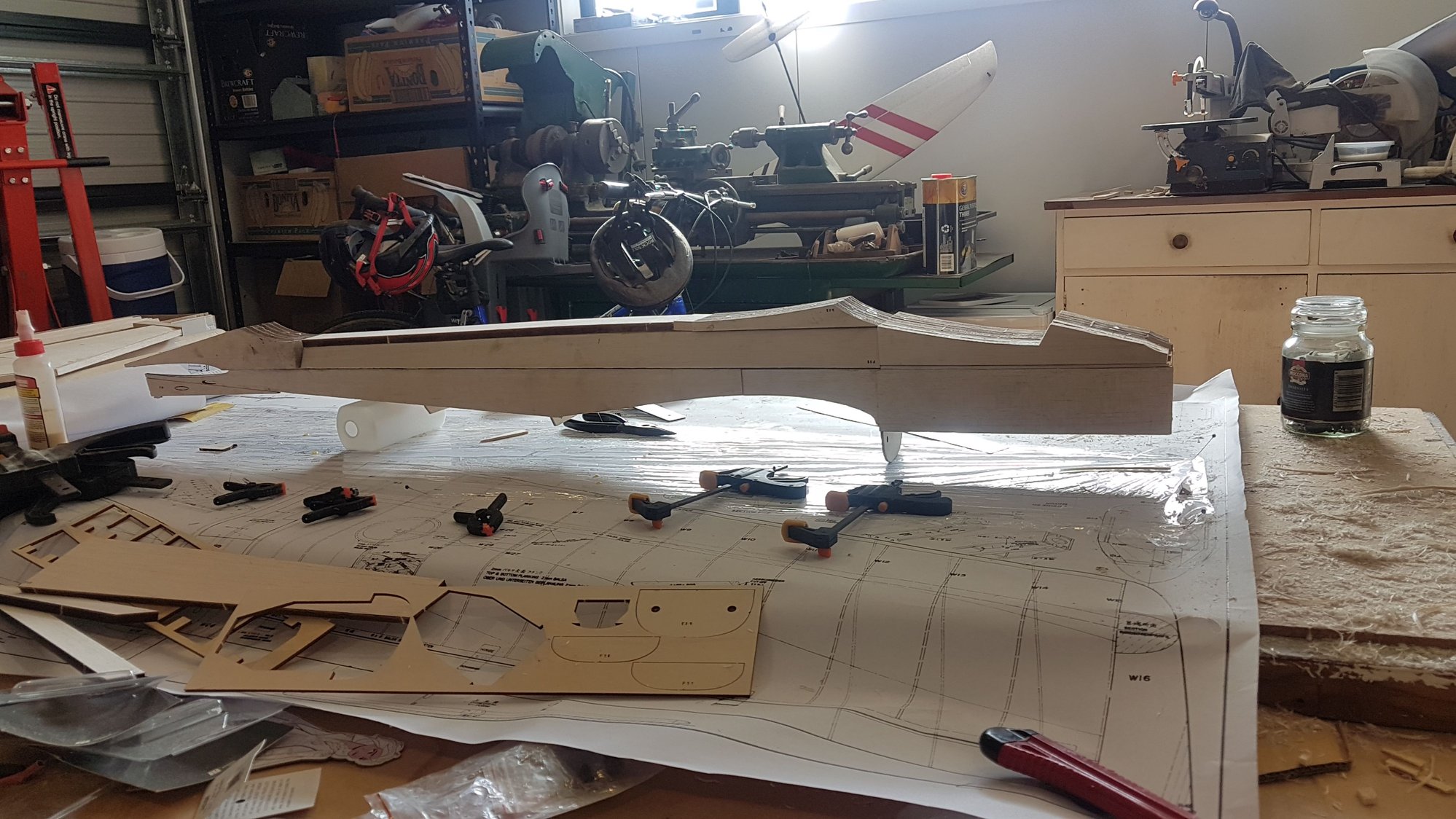

I added the two F15 pieces today. First I had to bevel the bottom edges to match the fuselage sides then clamp the hell out of it. Once the glue has dried, carve the top flat to match the formers ready to glue on F13 and F14
F14 added, so far havent found F13 as a cut part, but there is plenty of spare balsa sheet to make what I need.

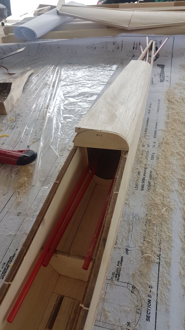

I was just about ready to start planking the bottom of the fuselage when thought that adding the pushrod outers might be a good idea! I placed in a couple of standard size servos to make sure I was ending up in the right place, this was also a timely reminder of how little space there is in a classic pattern model.
Then I couldn't help myself and rested all the big bits togethor.
regards Graham
