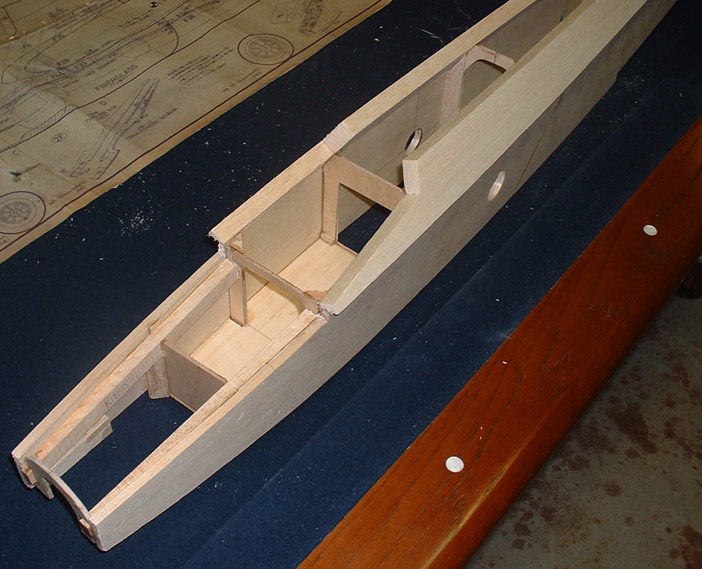

Greetings Aurora lovers,
I'm an ex-FAI pattern flyer whose been out of RC for approx 8 years. The last while I've been following the progress made on the electric power side of things and I've finally decided to take the plunge and build something "old school" (but fun) and go out and bore holes in the sky. Who knows....maybe I'll eventually catch the competitive bug again.
Why the Aurora? I've been a long-time fan of this design although I never had one. PTXMan in Calgary gave me a set of plans about 10+ years ago but I never did get around to building it. I did however build and fly Naruke's predecessor airplane, the Cosmos and really enjoyed it....that thing was a ballistic flying bomb!! Webra Race .61 (with a Perry pump embedded withing the backplate) up front coupled to a Hatori pipe.
My Aurora will be built 99% as per my MK plans (fuse/wing profile, wing area, etc) although I'm going to incorporate a few different things that won't be so obvious at a glance. I'll be going the plug-in wing and stab route vice the standard 1 piece that the original design has. After flying 2 Piorun Eclipses and then 2 of Greg Marsden's Legend IIIs (both designs have plug-in wings/stabs), I simply find it easier to dial-in all flying surfaces (wings and stabs) both during the building/alignment stages and more importantly later during the flight trimming stage. Ref wing airfoil, I'll also be using a slightly thinner NACA airfoil with the high point 35% back. I'll incorporate the normal wing fillets on the fuse which will hide the fact that the wings are plug-in. I'm still undecided about trike or tail-dragger. Trike config is of course prefered from a purist point of view but I'm having trouble locating suitable mechanical trike retracts......can anyone help here?...a set of MKs would be ideal.
I obtained my Aurora cowling and canopy from Singapore Hobbies. Great service from Ronald, their sales rep. The parts arrived in less than 2 weeks! Ron mentioned that my Aurora 60 cowling was their last one and that they will not be receiving any more. I hope he's incorrect on that one.

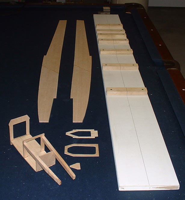

As you can see from the attached photos, I'm well on my way on the project. The toughest part thus far was reproducing the required accurate ply and lite-ply bulkheads. My MK plans have sufficient fuse cross section views but about half of them don't correspond with the position along the fuse where the bulkheads reside. I was left with having to carefully study the plans, extrapolate measurements etc...I'm sure most of you have experienced the same thing scratch building. Another complicating factor was the fact that I had covered the plans in map-tack years ago with some resultant winkles here and there. Again, I was having to take my time. If anyone has a good set of Aurora plans (or a copy) they'd part with, I'll gladly pay for them.
My fuselage jig was simple in design but sufficiently effective. This coupled with my using a pool table as my work bench top ensured a true reference building surface. That same table top will be very handy when I later frame the flying surface to the fuse. I will be using good old fashioned squares and rulers for the alignment process, vice incidence measuring tools/meters which I find difficult to get the same readings from them twice in a row.
Anyway, I won't be nearly as detailed in this thread as 8178's outstanding Blue Angel build (I'm too lazy) but hope you'll enjoy it anyway.

Dave, right now, it's a toss-up between the Hyperion 4045-10 and a Neu "ork" 19XX series. Chronos 333 has a post on the RC Groups newsgroup (Gas-Electric Conversion) where he has also converted an Aurora 60 using the Hyperion. His #s are:
Hyp 4045-10
TMM 5024 ESC
8s Lipo (3700mAh)
APC 14 X 12E (55Amps)
APC 14 X 14 (57A)
http://www.rcgroups.com/forums/showthread.php?t=471610
He likened the performance to fitting a YS 120 to the front minus the weight penalty...lots of power! He seems pleased although the big issue with the setup is poor ground clearance on grass. Those older trike equiped pattern ships were meant for 11 or 12" props.
I'm very pleased with my fuselage thus far. She's perfectly straight with everything nice and square. Ref weight, I'm at 360 grams (.75 lb) as seen in the attached photo. I was hoping for lighter but at least it's very stiff in the wing attachment area. I'll try to shave grams when I carve and hollow the top and bottom blocks.

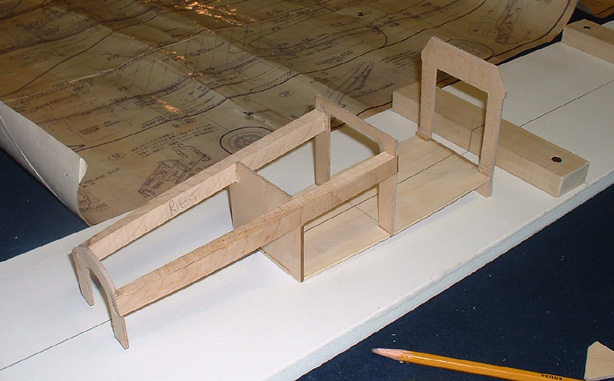

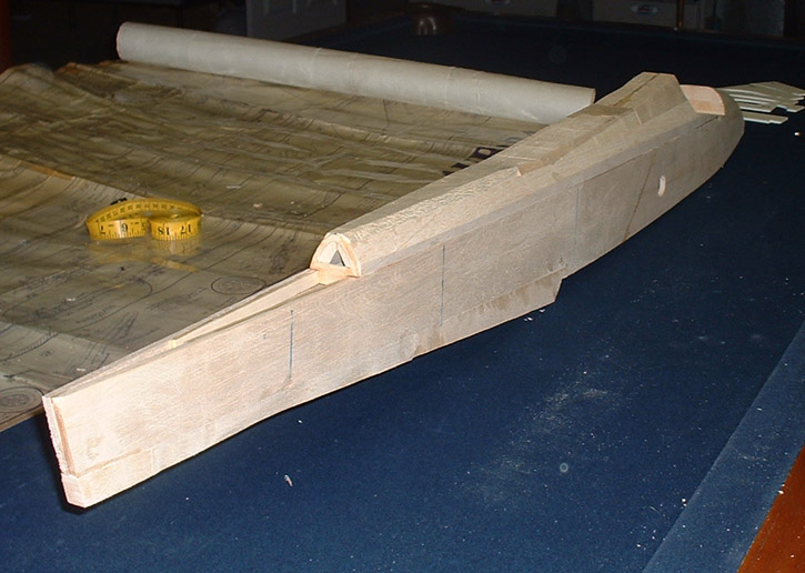

Latest progress as I just finished roughing-out the front-top and rear-bottom blocks which will be "tacked" to the fuselage prior to carving the general fuse shape. Sure wish I had a band saw available.....cutting thick blocks accurately can be tough when all you have available is a small motorized scroll saw! It took a while but the blocks have the proper shape according to the plans. I've included a photo with the bottom cowl in place to depict the rough outline of the bottom of the fuse.
It should be noted that in some areas, I've simplified the construction just a bit. After studying the plans carefully prior to starting the project I came to the conclusion that some areas of the construction were overly elaborate and thus difficult to replicate. Don't get me wrong though, MK kits are first class. And despite the internal mods, my intention is to maintain fidelity with respect to lines and shape.
Next step is to produce the fuse shape templates and start carving/hollowing.

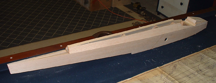

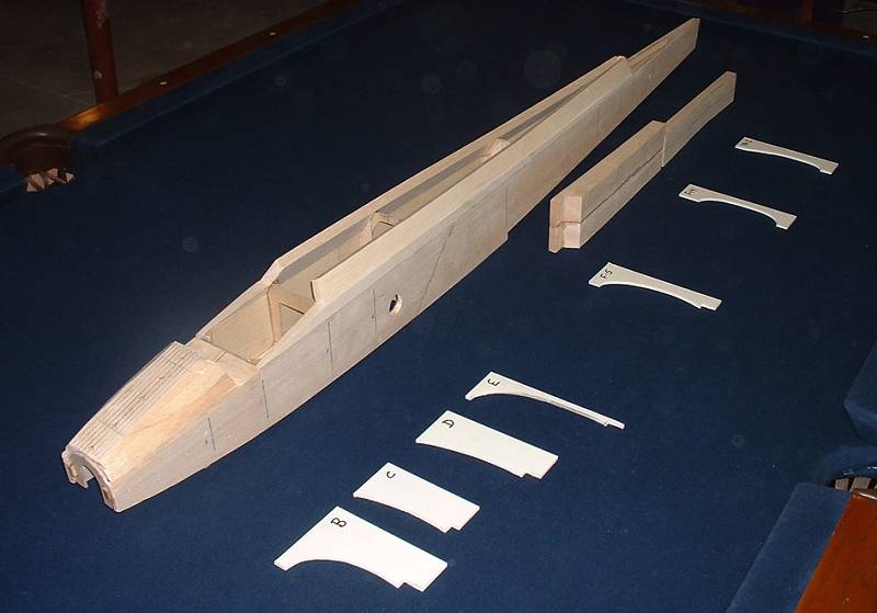

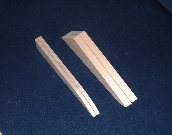

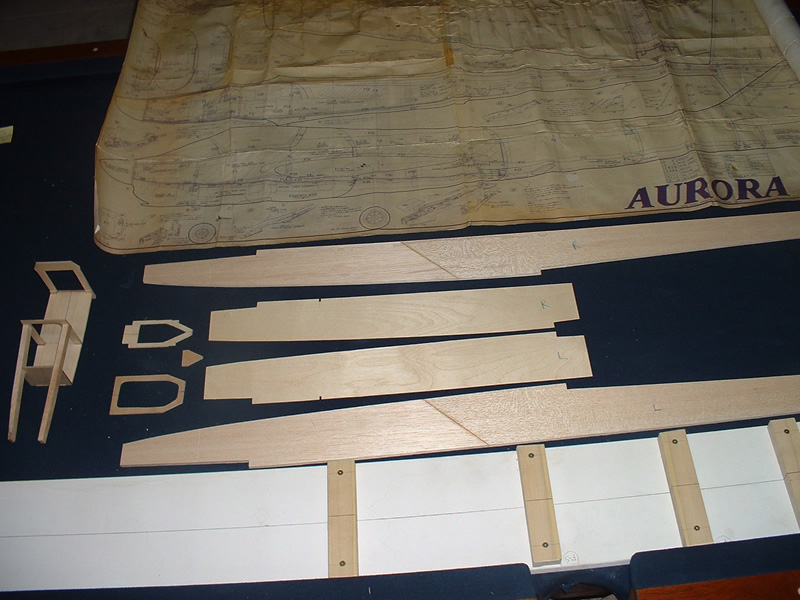

I just finished fabricating and gluing both top side pieces of the fuselage. I used 1/2" thick light balsa (approx 6 lb density) for those 2 pieces as I knew they would be difficult to trim given the required angles and curves and the fact that I would not be able to hollow these from the inside afterward. They turned out as good as can be expected with only a few minor gaps in a few spots. The next step is to trim the tops of those shoulder pieces flush with the tops of the fuse bulkheads and then add the top "cap". The top of the Aurora fuse has a constant curve/slope all the way to the vertical stab which is necessitating my having to take my time and be careful.
I also cut the fuse outline templates from some spare 1/8" acid free picture frame backing board that I had lying around. That stuff has a special foam core that is perfect for the job. It's fairly stiff yet easy to cut and sand to shape.
Well, that's it's for now. I'll soon be making a mess of my work area from balsa shavings and dust!

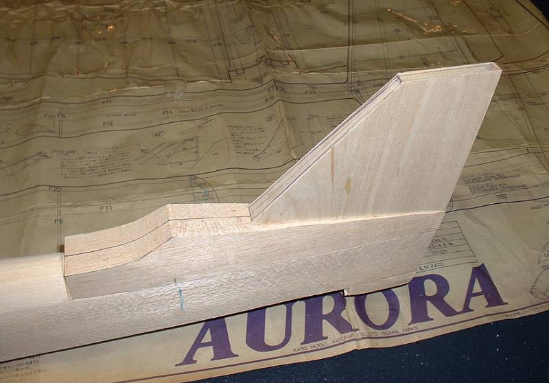

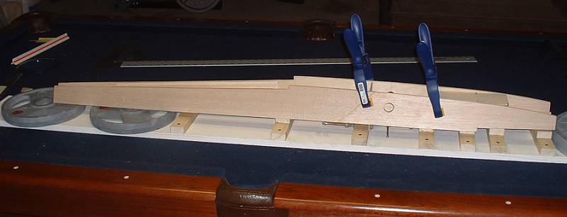

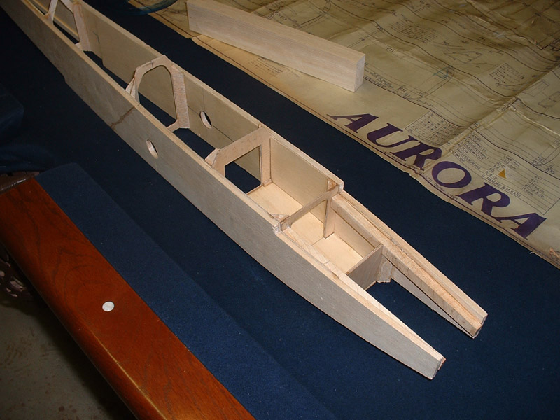

After shaping the proper outlines of the top and bottom fuse blocks, I then tacked them in place using only a few drops of thick CA each. After I'm done carving and rough-finishing the outer fuselage, I'll then pop those blocks off and hollow them from the inside. It's a laborious but rewarding process as the fuselage slowly takes it's familiar shape while maintaining a reasonable weight.
The one photo shows the 5mm thin ply strips embedded in both fuse sides which are nescessary for mounting and holding the lower cowling in place.
Even though I'll be using electric power for this project, I installed a flexi Nyrod throttle cable in case a glow motor should one day make it's way into the nose. That's all for now.

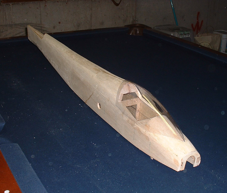

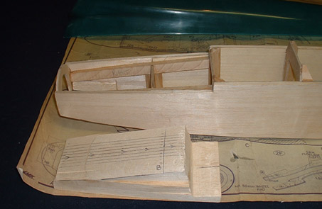

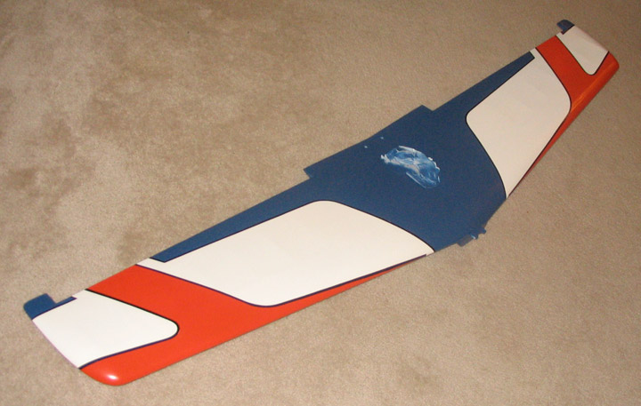

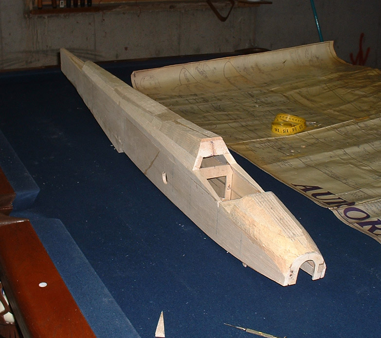

Finished the preliminary carving. Next step is to continue shaving balsa until the final shape is achieved using the earlier mentioned templates as guides. Is she starting to look familiar?
I'd like to get started on the wings and stab shortly but Kevin at Matney models has not returned my correspondence in close to 3 weeks. He had agreed to do the CNC foam cutting for me. Anyone spoken with him the last while?

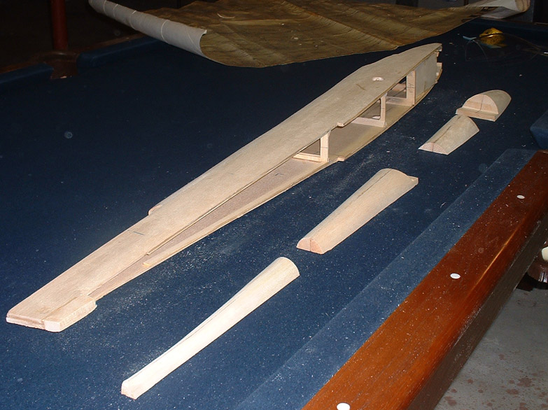

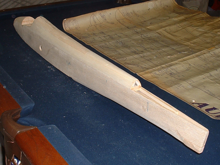

Just finished shaping the fuselage to the point where I can now detach the top and bottom blocks. Next is the tedious job of hollowing those blocks before re-attaching them and applying the finishing touches to the fuse.
A few things yet to do include the installation of the internal antenna guide, the cable guides for the pull-pull rudder, and finishing the cowling so I can properly mount it to the fuse bottom which is the only way to truly determine to what point I can trim the lower fuselage edge where it mates with the cowling edge.
As well, given that no more Aurora 60 cowlings are available (supposedly), I might rip a quick mold from the original just in case I need a spare in the future. All it takes is 1 belly landing in the rough to wreck the fragile cowl.

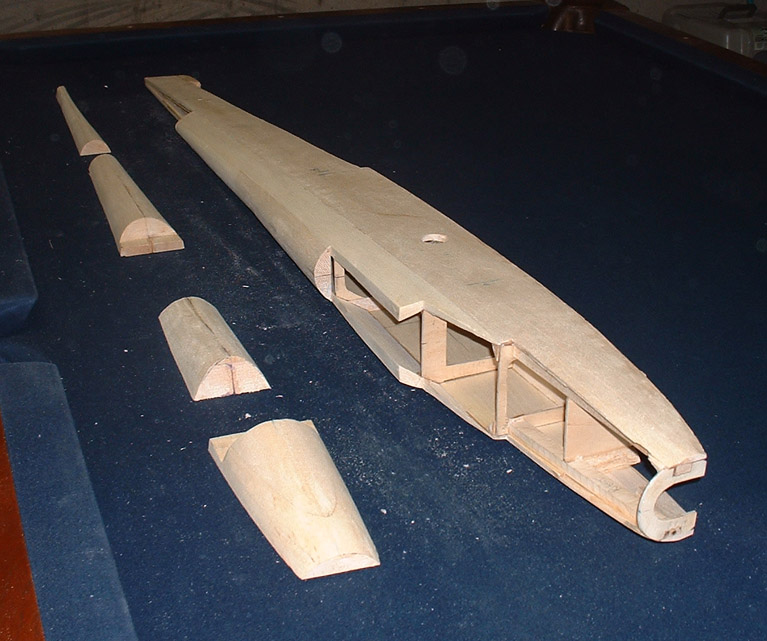

Rough hollowing-out of the blocks. A little more sanding and they're ready to glue back on. If you look closely, you can see where some small bits of the balsa of the main fuselage stuck to a few balsa blocks when I pulled them off. No big deal as I'll have to apply micro balloons anyway during the final finishing stages. The key of course is to keep the filler to a minimum.
I still have a few items to complete before I permanently glue the top and bottom blocks back on. I called Central Hobbies yesterday and ordered their new carbon rod Dual Elevator Pushrod System and a Gator Adj Stab Kit which I want to install first. Central's all out of Gator Plug-In Wing Adjusters and Gator Wing Tubes though. TNT Landing Gear shows as having wing tubes/sockets available but does anyone know where I can get wing adjusters for the wing panel pins??
8178, I hear ref a plug but I don't think my fuse is the best for such an endeavor. I believe that a glass kit of the Aurora should be engineered around the standard 1 piece wing and not plug-in wings. I'm betting the "pattern classic" fans out there will agree. Did I read somewhere that Dan at Carolina Custom A/C had the Aurora 60 on his list of kits to produce? Having said all that, I think a mold from my original untouched cowling is a must given that they're no longer available. I can do it myself (limited mold making experience) but anyone out there comfortable with the process is welcome to take it on. Canopies are still available from Singapore Hobbies. Great service from them but the shipping is a bit steep for small parts....understandable I guess given the location.
Jeff L
Jeff L

My build continues with the fabrication and mounting of the vertical fin. I have the rudder left to build but I'll soon be ready to tack the pieces together, temporarily hinge and mount the fin/rudder, rough shape the outside and then break the whole unit loose again until I complete installation of the elevator pushrod system inside the fuse. At a glance, things line up fairly well although I'm going to take my time to ensure the fin is absolute square to the fuse and aligned with the fuse's longitudinal axis. Any errors here make it difficult to accurately trim the airplane later. I'm going to use a pull-pull system for the rudder.
Ref the wings/stab, I'm at a stand still on that aspect of the project. Kevin Matney (Matney Models) still has not got back to me. As a result, on Saturday I sent the required info to flyingfoam.com looking for a quote. Hopefully I hear from them soon. Back-up plan is for PTX-Man to plot the built-up wing and stab for me using the Profili program. We'll see.
Jeff L
Jeff L
