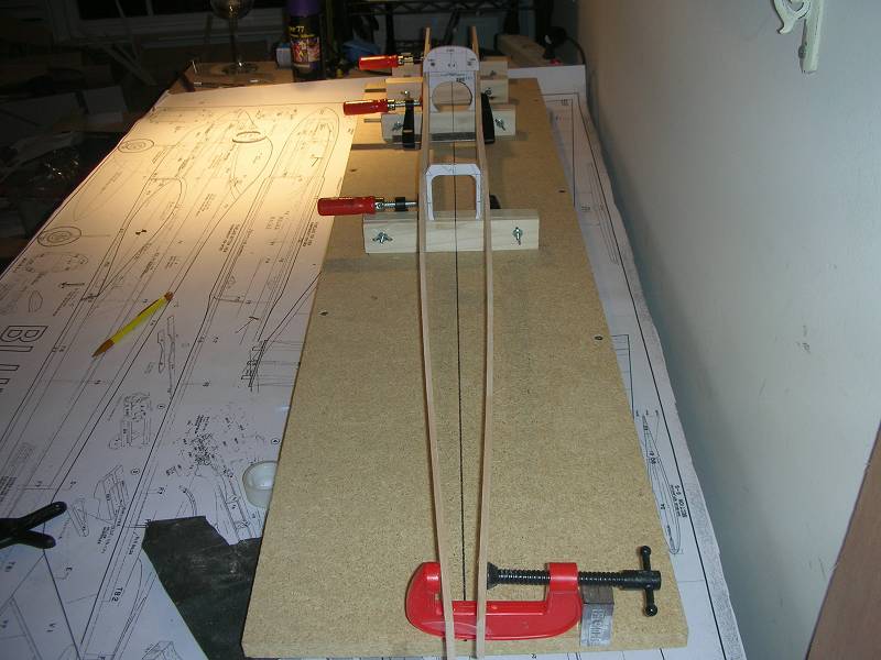

Bought another chip for the camera, so i''m able to get a few photos uploaded. it looks like i got this project started just in time to abandon it for flying season. hopefully that won''t be the case.

Looking great! Your fuselage jig looks perfect. I wonder how people put the kits together without one.

i think i enjoy building more than flying.
i purchased a precut piece of chip board as shown in the photos (12" x 48"?). i also purchased high quality 1 x 2 x 8' and a 1/4 x 2 x 4' strips of lumber as well as the bolts, washer and wingnuts shown in the photo. i cut 8" strips of 1 x 2 and back screwed them from underneath the chip board at fuselage former locations. of course i squared and clamped everything before screwing everything down. i used a countersink bit to predrill and flush all of the screws. i then clamped the 1/4 x 2 even with the 1 x 2's and drilled bolt holes. with the left over 1 x 2 i installed runners underneath the chip board to prevent warping. also, i put a center line on everything as i assembled the jig.
i hope thats a clear enough explanation.

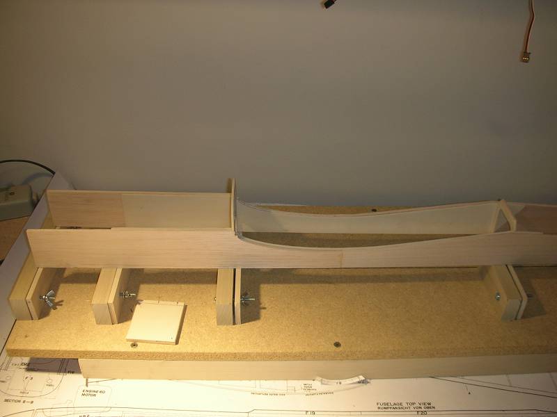

generating shapes for the formers not available on the plans has proven to be a challenge. a width and or height can be found but the top or bottom shape of the formers has to learned. by using formers in front or behind the missing formers and by referring to other similar builds i hope i have cut formers close enough to tack to the fuse sides. i then hope to lay planks over a span of formers and check as to whether i have the correct shape. what fun!

for some reason the flash didn't pop on a couple of those photoss.

Nice, simple and functional jig. I'm a big fan of homemade tools, especially ones that are designed for a specific job. Looking great so far.
