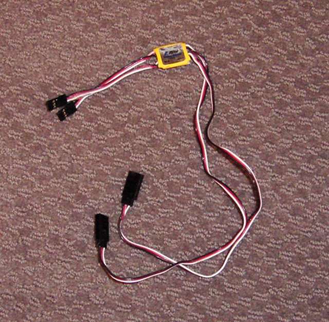

BEC, battery elimination circuit, is a generic term that applies to all circuits or
devices, whether in an ESC or as a separate device, that step the
voltage to the desired level. You could also call them voltage regulators.
They take the power from a battery pack and reduce the voltage to the level
desired. For example, an 11.1 V 3S lipo pack gets stepped down to 5V to run
your receiver and servos. Most are fixed but some can be set for the desired
output voltage.
There are two types of BEC in common use, linear and switching.
Whether you do it with a switching or a linear BEC the effect is about the
same. I am not aware of any reason to believe that one is more reliable than
the other or that an external BEC is in any way better than one integrated
into your ESC. The critical issue is the sizing of the BEC to meet the
amperage and voltage needs of your equipment.
It is worth noting that linear BECs are more commonly used with lower
voltage battery packs. That is because the linear BEC uses a resistance
process to drop voltage from, say 11V to 5 V and this generates heat.
Nothing to be concerned about but that is how it works. So once you get past
a 4S lipo or a 12S NiXX pack the step down becomes enough that most
manufacturers go to the switching BEC design. This uses the same type of
switch on/off process that your ESC uses to regulate the speed of your
