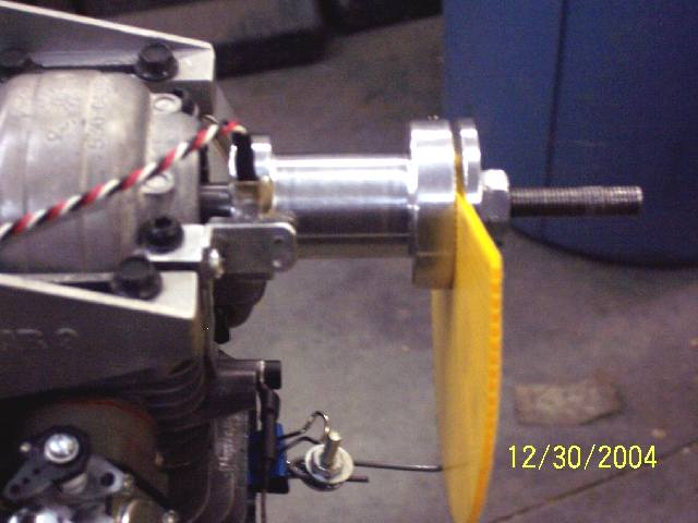

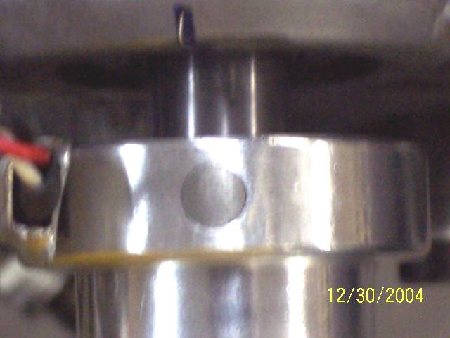

You can put your magnet in the prop hub. The hub in the pics is my poulan 46cc motor.

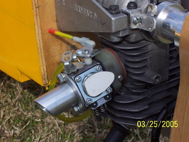

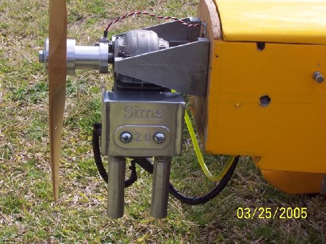

What are you using for an engine mount on that 46cc? Is it home built? Could you post some pictures of the mount?

The mount is a hanger 9 mount. I got it from a friend,i think it's the largest mount you can get. I made the muffler,the prop hub and the carb mount.
