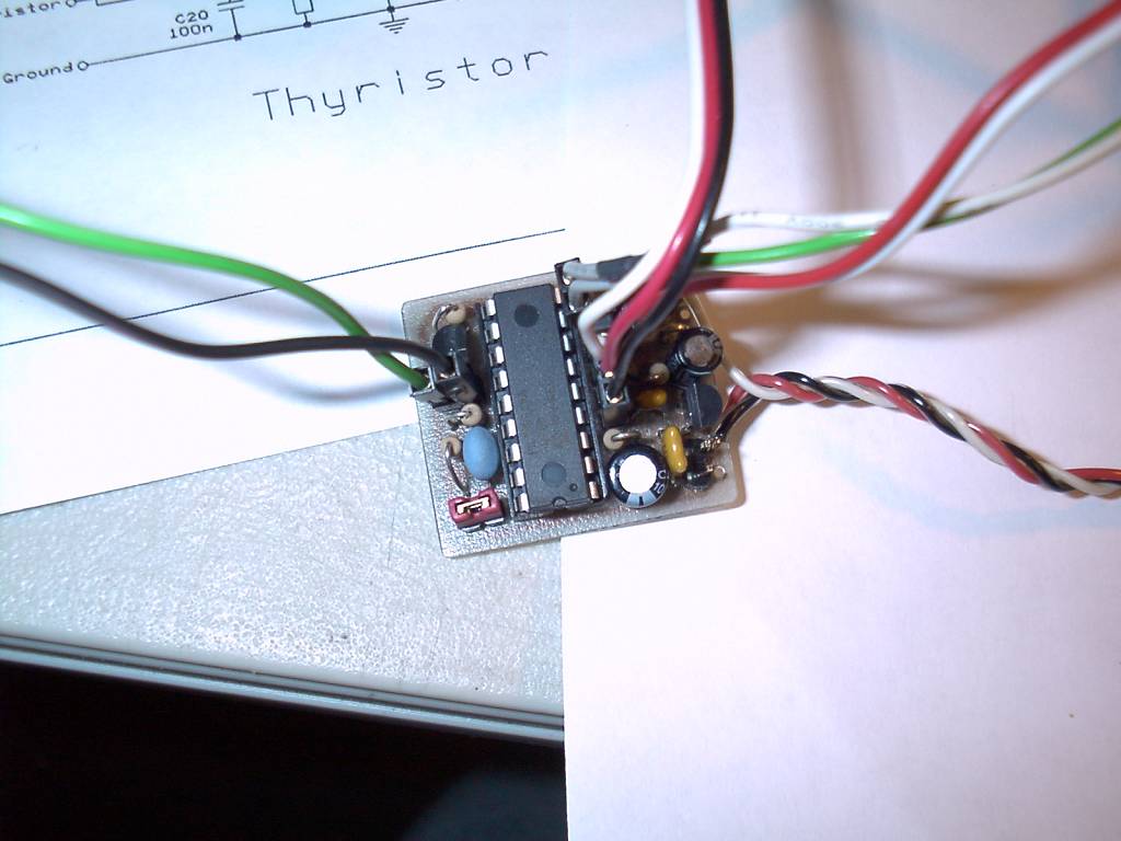

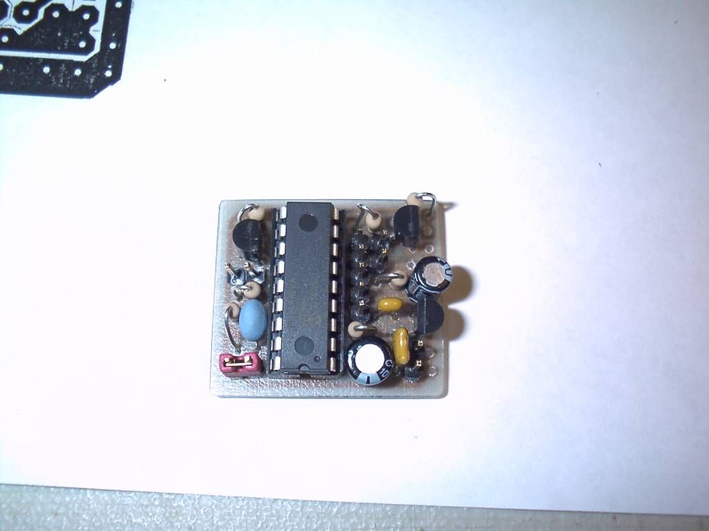

Here's my first completed timer board ready for wiring. I have a few questions though..is R7a actually R8? and do I need to replace that with a jumper if using the thyristor output to my CDI board's input? Or do I replace R7 with a jumper and use the 1k resistor on R8? confused..
John

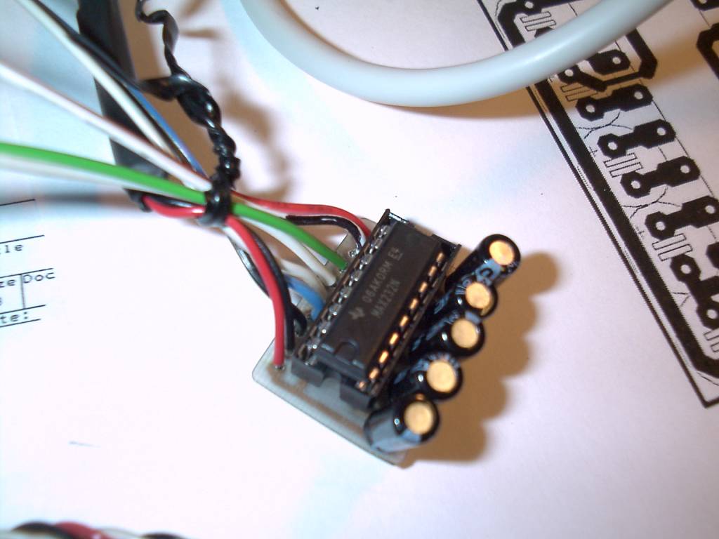

First , before I get into my repairs, I've got some problems. When I was building the RS232 com-powered interface, I noticed the LED is placed backwards on the parts layout. Mine wasn't lighting up, making me think I wasn't getting power to the board. I reversed the LED and all is well with that part. When I installed the board into my com-1 port and checked voltages, I only get 2.6 volts..not enough to power anything. I guess I'll have to build the USB powered board after all.
The next thing was, after running the setup file for the monitor and CDI table control of the timer board, I noticed it doesn't access my com port 1. It never lights up the LED. I get no green messages or red messages for anything but the table loaded from disk message.
I have other software that accesses the port and that software does light up the LED on the board when I run it so I know the board works. Have you had this problem? I remember you asked Rob about that problem somewhere on here. Did he give you a resolution to the problem? I do have Net Framework installed so that isn't the problem. I didn't see the OPEN PORT section anywhere except for the pull down menu choice for the com-port, but there was only one choice there...com-port-1.

The com port will not power the pic. thats what the usb is for. The link the the USB to Rs2332 will solve this. It will provide comms and power to the pic. Anyway what version of ignition software do you have? I am running 1.0.0.1.3.6. with it you can select the com port you want to use. I am still having issues. I am testing everything in a development board. My issue is I have to toggle PortB.1 before PortB.0 will work as input. after that I can see rpm and timing curve. I can upload and download just fine. I am making a timer board to use with my USB to RS232 cable. almost finished. I will let you know how it turns out.
Charlie

Ok..I am running the 16 mhz resonator on the timer board. The board is functioning and able to send the data to the PC. It's just not able to recieve from the program. Do you think maybe the MAX 232 chip is bad? Everything else checks out good..The port is being pulled low.. I checked all the solder joints, nothing there. So I am thinking maybe the 232 chip has a faulty recieve section. Also, I switched back to the comport board and powered it with USB 5 volts and it gave me the same results..can track the timer but not upload to the pic. I only got one MAX232 chip when I bought my parts..maybe the problem is following the bad chip when I swap it back and forth between the two boards. I'm not sure..I'll look at Rat Shack for another chip.
John

from the pic of your timing board it looks as though you have a resonator instead of a xtal. does it have 3 pins? if so then the middle pin needs to be grounded. They work,but are not as accurate as a xtal.
