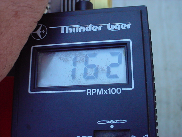

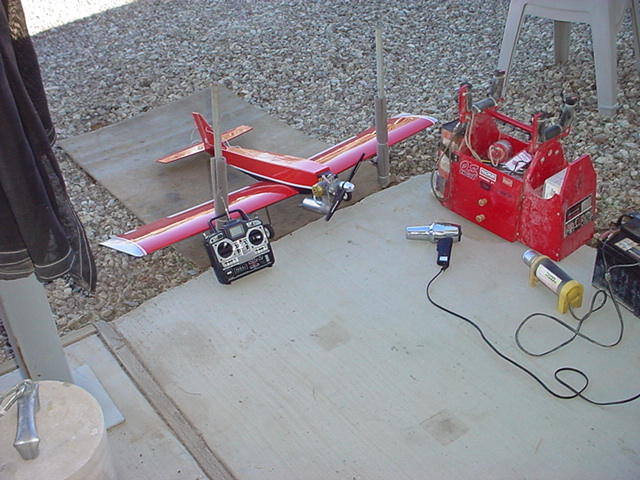

Rcpilet....you're a Man after our hearts out here in the speed crowd.
I ran-in this plane in the same day as well....a little OS .40 FX in a Q-500,
A 9-6 MAS toothpick prop....over 16,000 as well. Both engines rated at
16K.....I wanna see 16K on the tach.
