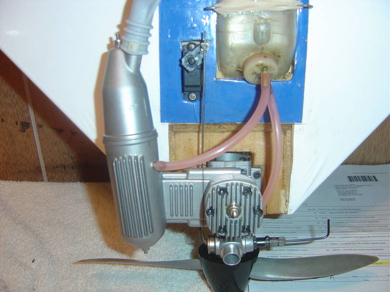

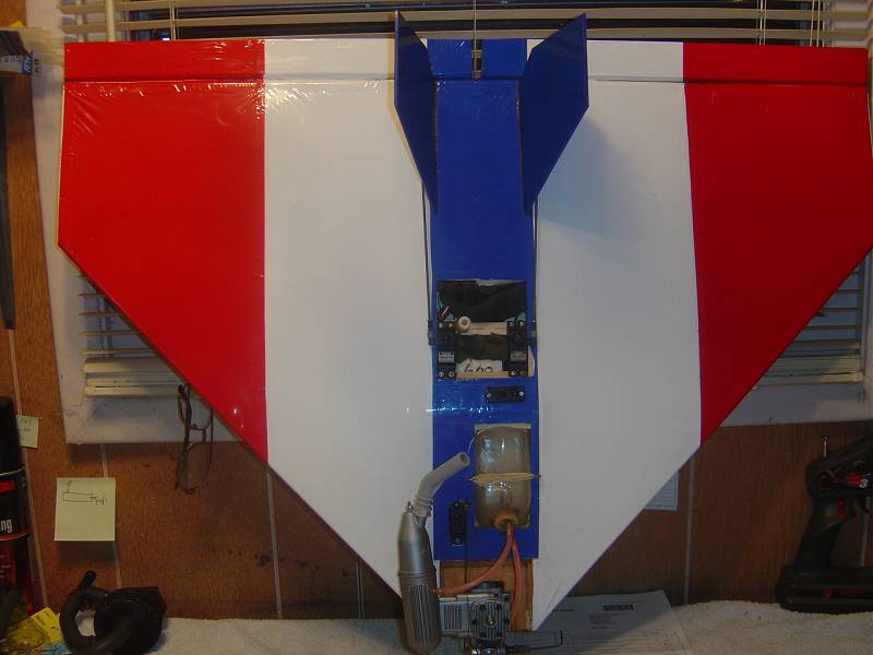

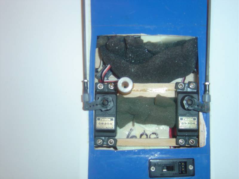

I picked up a DD recently w/o engine. I have a new Rossi 45 with pipe, but I'm using a Thunder Tiger Pro 46 for openers. Servos are Futaba S9304, not sure what's on the throttle.
What is the CG and do I measure from the trailing edge? What throws and expo's? The battery cycled fine and is a 600ma that looks like it came with a Futaba flight pack, it is in front of the servos. The rx is a Futaba 127 and is behind the servos.
The pics show the servos and the battery. I wrote (600) on the battery.
I use the 9C and prefer dual rates with expo on practically everything I own.Also, I've read about guys hand launching themselves, what is the technique for this?

I've got mine balanced on the 'fattest' part of the wing, where it humps up. i personally don't use dual rate or expo but my flying buddy doesn't have as steady a fingers as I've got so i have the duel rates set to 100% deflection but he has it on 60% expo.
for hand launch i hold it between the fins in my left hand, holding the TX in my right with my fingers pinching the ele/ail stick (i don't fly dumb thumb) with the right wing tip about 6" lower then the left i shove it WOT with my mouth and as soon as it stages on the pipe i let it loose, no toss required. the wings torque level as soon as it leaves my hand.
i don't think you'll have your hands overly full with the engine you mention, i use a Jett FIRE 60LX on mine and 160 mph is all it'll do, the people claiming 200+ are only fooling themselves. don't sweat the deflections much, just give yourself enough you know it'll fly (3/8" up/down), they fly great at very slow speeds and aren't nearly as agressive as they are at WOT so keep in mind you don't have to fly with an on/off throttle

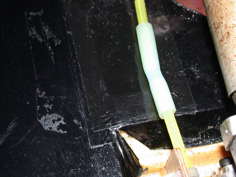

Oh yeah, almost forgot, on the throttle servo when you get to flying with an engine/prop combo that turns up some massive RPM (i turn an 8.8x8.75 @ 21K static and about 26K unloaded in the air) you'll have to isolate the servo pushrod or vibration will destroy the servo insides. i use a piece of Ny-rod with a length of fuel tubing glued to it with a 1/4" spacing between the Ny-rod for vibration dampening.
kc
EDIT: pic now included

Thanks KC... When you say your CG is on the "hump" are you talking about the most forward spar? Roughly 14 inches from the wing TE ( not including the aieleron). If so, mine is nose heavy.

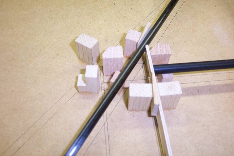

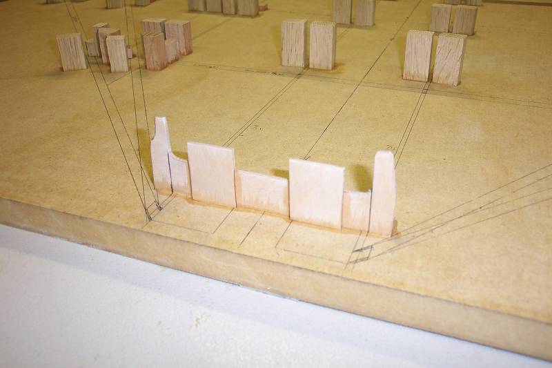

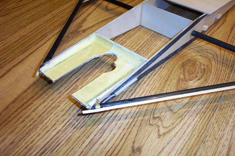

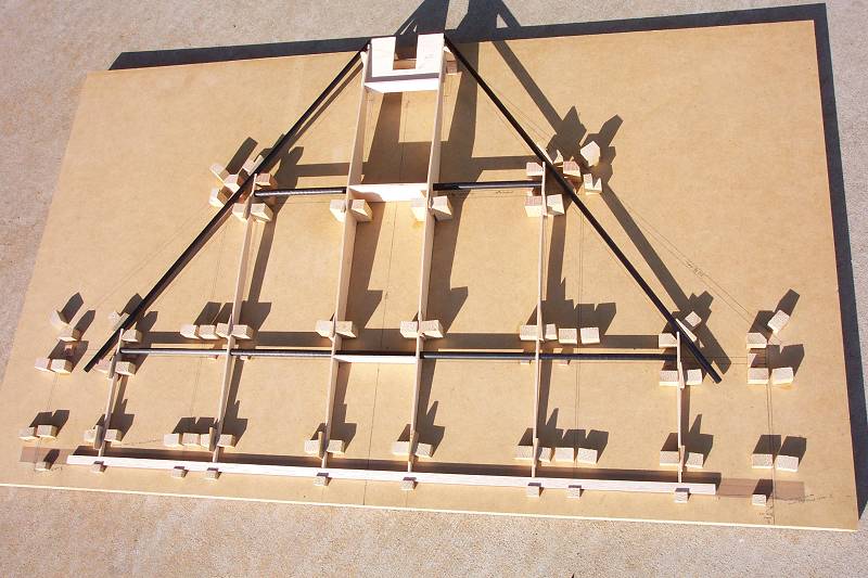

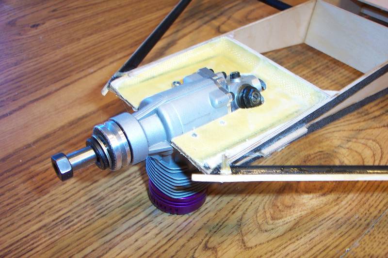

If you have a DD kit in box, now may be a good time to use the ribs as a template to make more for your self. Who knows if/when new kits will come out or the quality. I will not use the original parts in a plane, only copies. The ribs are 3/32" thick and the engine mount and the little rectangles that fit into the spar ends are 1/8" thick aircraft ply. A Sears 10" band saw (table saw) model #119 214000 about $100 works fantastic to cut things up.
The jig is up...sorry I couldn't help myself. I made a fixture/jig to hold everything strait, square and spaced. This will keep the wing neutral, no wash in/out. At each hold point there are two blocks glued to the base plate (3/4" hard, strait particle board). One of these blocks is positioned to the inside line of an accurate layout drawn on the base plate, the opposite block is angled so a small wedge can be inserted between it and the rib. These wedges have surprising holding power; if you forget one and pull you will break something! Blocks are cut to hold up the spar at the proper height for the outer ribs. I used some adhesive backed Teflon tape under the 1/4 X 3/8 trailing edge so the CA won't stick the wing to the fixture or you can use some wax paper each time. The only parts that should be resting on the base plate are the rear 2/3rds of the main ribs and the trailing edge. Loading the fixture and gluing up a wing takes about 10 minutes. The fixture works with standard or clipped wing (clipped wing is loaded). This jig be made in a few hours, it's not worth it if you are making only a few deltas.

Nice photos, nice jig!
If all 3 corners are made strong, there shouldn't be any problems with the framework twisting. I use more like 3/16"-1/4" thick ribs, plus I like to use 1/32" ply rib doublers in the engine bay.
Control of these planes can be real smooth and precise if you use the inner servo arm hole and pivot the flaps about 1 1/8" up on a tall control horn.
RE: First Diamond Dust-Help
That looks good man. It sure is amazing how well that carbon takes to CA glue. I remember 15-20 years ago reading the C/L combat columns in the magazines and how they talked about the stuff like it was cutting edge rocket science. Too bad all this space age material has to be hazardous to work with. Imagine working at one of those plants.....might as well smoke and eat doughnuts 24/7 if I had to work at a C/F plant
