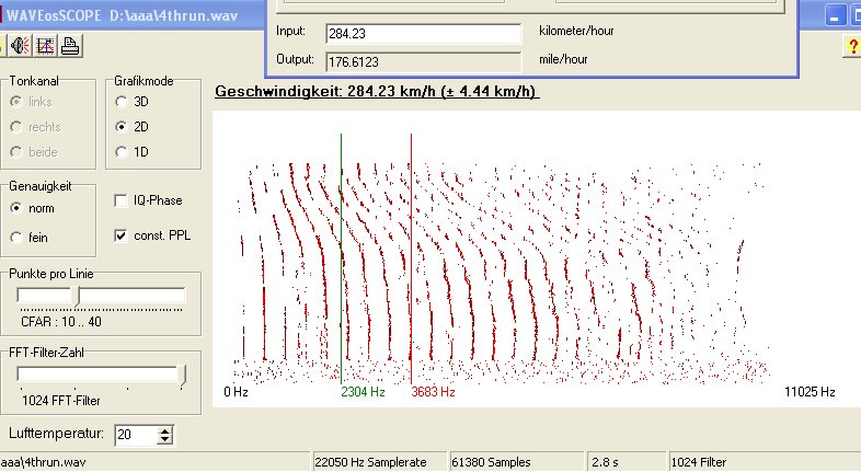

Mike contacted me through PM and asked for my help with Doppler readings on his plane. Regardless of results, he was willing to share the outcome with me and others. he sent me four short video clips that I analyzed. Unfortunately Murphy was at the field and got in the way before things could be tweaked for maximum speed. I think this shows this plane is quick and on a good day may actually be close to what the GPS said.
Attached is the Doppler reading and a couple of pics he sent me yesterday.

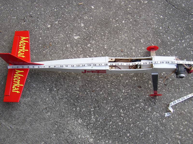

I'm trying to capture the plans in TurboCAD for Ron right now. I'm doing it at work in my free moments, so it might take a week or two. Once I get it captured and Ron gives me the OK I'll post them at the PB website and here if he'll let me.
Here are some dimensions:
WS 42"
Chord 9"
Fuse L 28.75"
Fuse W 2.25"
Fuse H 2.75"
H stab W 14"
Ele W 12"
Ele cord 1"
V stab H 5"

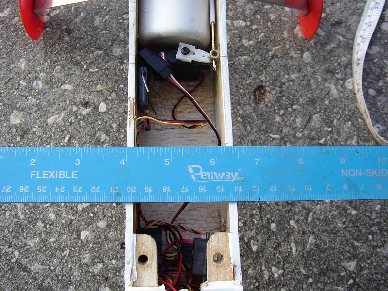

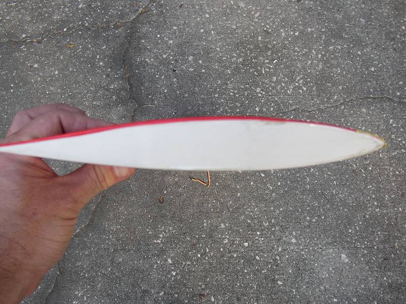

Here are some pics. Chris' dimensions are pretty close so I will leave it there, especially if he is putting it to plans. I also included a pic of root of wing. You will see where the thickess part of wing is. The wing is foam core and then fully sheeted and glassed in middle. The thickess part of wing is 1". The hatch right behind wing saddle is where two standard size servos rest, then pushrod to back for rudd and elevator. The battery is as far back in fuse as possible for balance. The plane as it is is a touch nose heavy but landings are not bad. However the best landing I have had to date was yesterday when the muffler got sheared off and the balance was perfect, it floated forever . The front house's a 6oz bubble less tank which is important for consistent runs, especially if you plan to push the plane to the max at high rpms. My GPS sits between the throttle servo and rear of wing, barely! Let me know if you have any more questions.

Only an 18 oz wing loading! An even smaller airframe is still reasonable.[X(]

In flight RPM can be obtained from Doppler. Supercoolprops website shows the procedure using an oscilloscope but I am confused on what #'s to use in WaveosScope. The WaveosScope website does not discuss RPM. Would one of the # crunchers please step forward and help?

I have had easier videos to work with. I finally ended up using short sound clips of just before and after the the camera pass to get fairly clean lines. Speed ranged from 150+ mph through the 176+ mph posted on four passes. I understand the day of the GPS flight there were winds of around 10 mph so that should be considered. The winds during the Doppler flight were light.

My problem is the Fgoing and Fcoming #'s I am using come up with a RPM that could not be close. Plus the "F" #'s have different values depending on where I sample the speed in WaveosScope.
Here are the Doppler equations.
To get the RPM in the air, we have
f = 2 / (1 / Fgoing + 1 / Fcoming)
RPM = f * 60
The question is can I get the Fgoing and Fcoming from the charts below. They are the same chart using a different area to come up with a similar speed

Sorry Mike, I didn't realize that you were asking about the formula.
It's fairly basic in what it is saying. 1/Frequency gives the period in time between cycles. So the time interval of the signals coming and going are being added together, then converted back to the frequency (divided by 2). Then the conversion back to rpm.
A plane doing around 170 will have a doppler shift of about 23%, throw in the unload on top of that, and you will have a pretty big number when the airplane is flying toward you.
Old 02-04-2008, 01:24 AM
HighPlains
Join Date: Mar 2003
Location: Over da rainbow, KS
Posts: 5,087
Received 5 Likes on 5 Posts
Default RE: Meerkat dopplered....177mph
Ok, a quick example.
Say that the oncoming rpm is measured at 26,000 and the going away is 16,000. So one might think that the actual rpm would be the average of the two or (26,000 + 16,0000)/2 = 21,000. But this is not correct.
The actual rpm by the formula would be 19,810.
Another formula is 2x((R1xR2)/(R1+R2)) with R1 the approach rpm, and R2 the away rpm.
