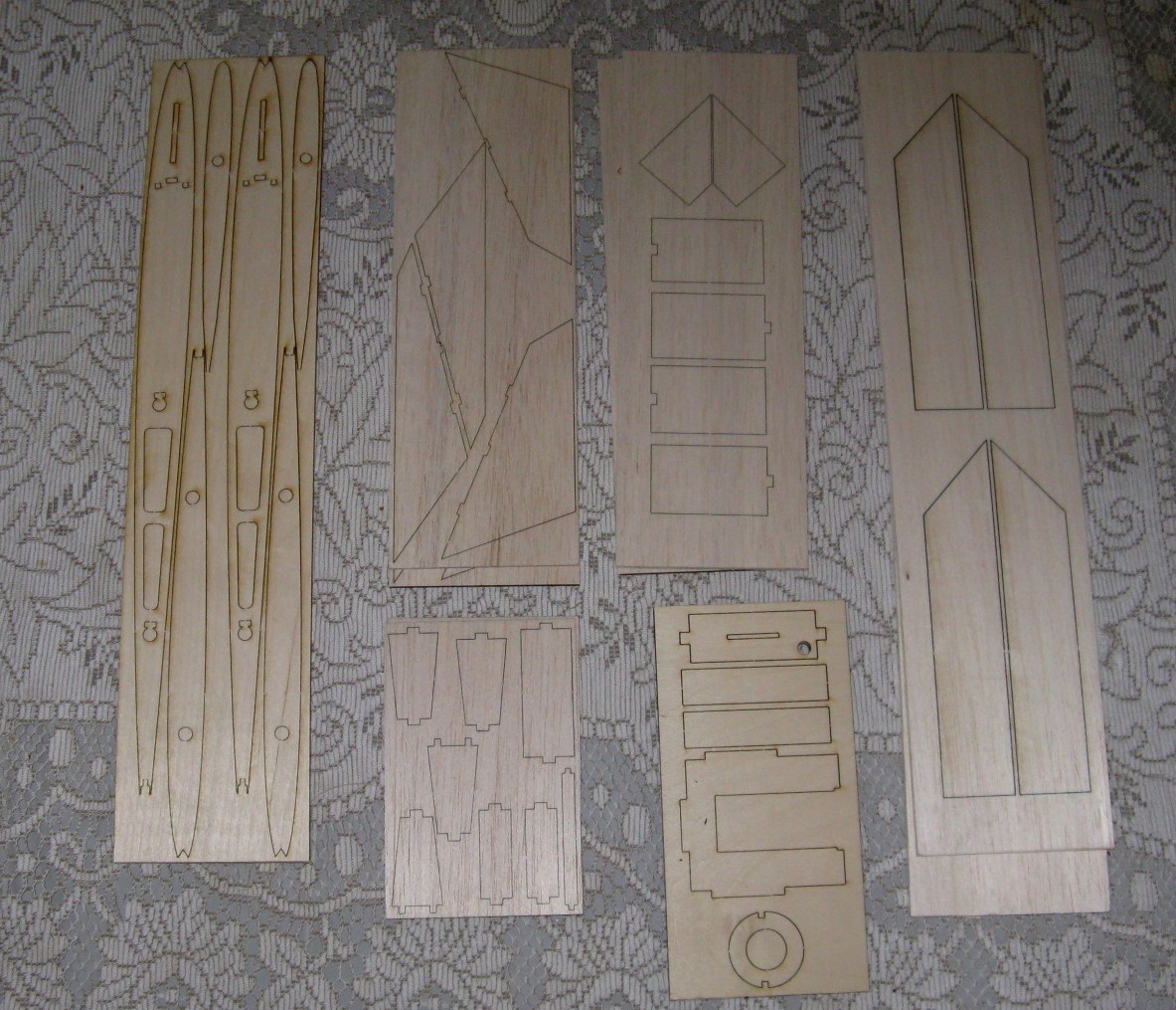

Nyuk nyuk, just fishtailed and skidded back from the armpit of Ontario with the first two sets of bits for the 26" span Demon prototypes.
I've been calling it a .25 size, but it is well proportioned for a .15 too, and I will test it on a venerable old FP .15 first to represent the performance someone would see with their favorite old sport .15. Then the OPS Speed .15. Then.. we'll see. There's already a .25 VF-DF version waiting to fly so that's covered. Need a Jett .35 now. Mommy?
26" span, 336 square inches, projected weight 1.5 - 1.8 pounds with a .15 (projected is a synonym for a wild-assed guess, note the wide range), subtle differences in internal structure to open up the tank compartment a bit.
I'll build a second for the motor system out of my Simple 400. It will be a useful comparison with apples-to-apples in the engine bay.

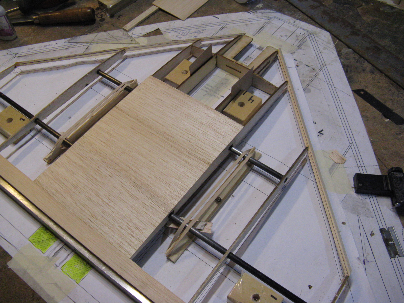

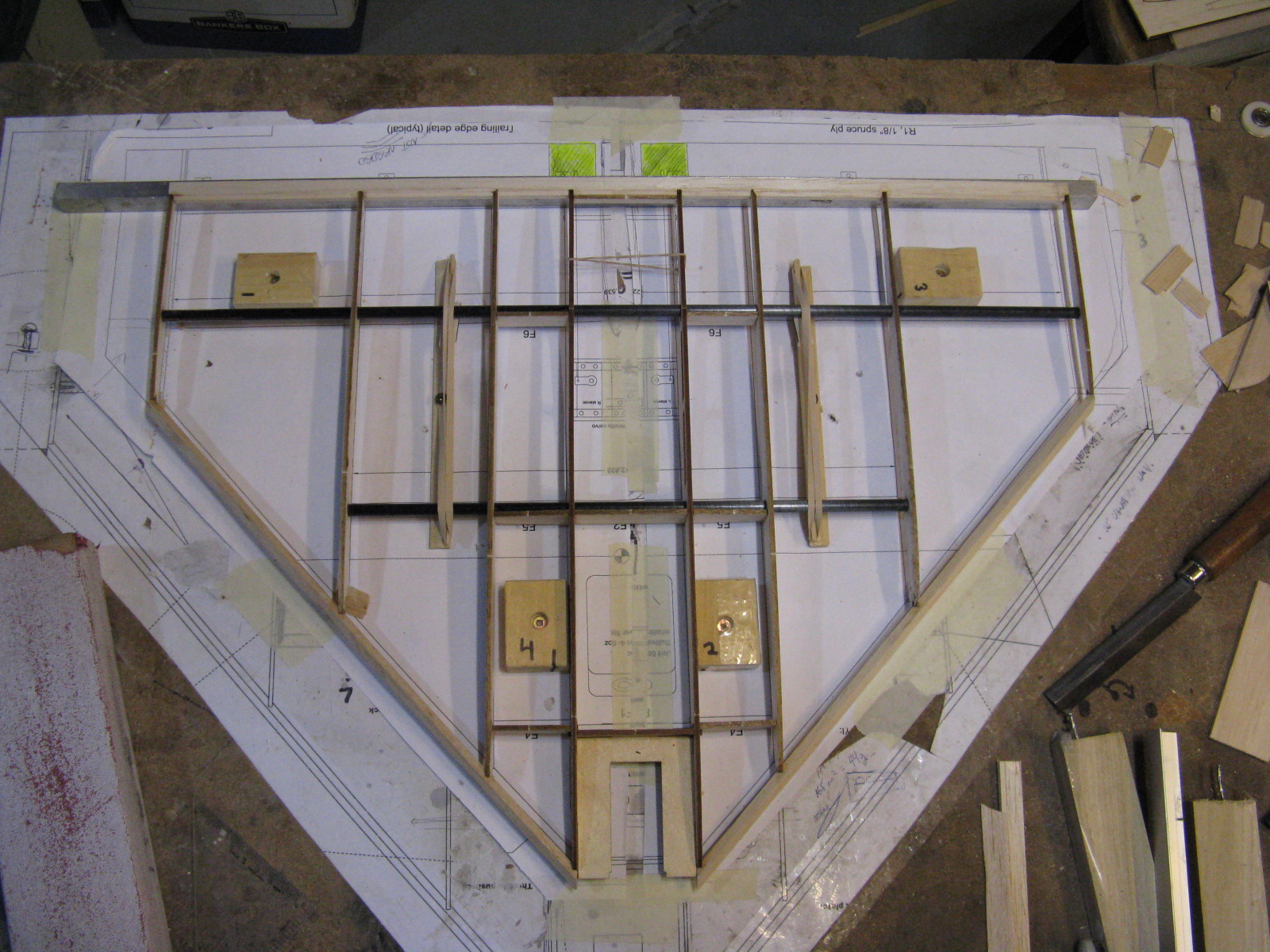

Framing 'er up.
The trick with these as I have learned is not to piddle around but simply set yourself to fixturing them from the start. Two rails for the CF spars, and something to hold the TE level at the right height. I use rubber bands to hold the spars as you can see, by crudely Dremeling a notch in the end of two scraps of scrap corner cove stuff I had shoved in the rafters. A few shims to deal with discerpancies in height too, as in here where after applying the TE sheeting the rear spar is off the rails. No sweat, equal thickness shims on each side and off we go again with everything parallel to the board again. I now take a couple of minutes on each model, and tack in some 1/8" square balsa along the LE to support the sheeting from getting bowed downwards. I draw a for reference as you can see, then quick CA a few scraps in place.
These steps sound like extra work, but the net effect is less work and a straight airframe. She'll be flying within the week I bet. Maybe I'll just drop the OPS in it for now and the FP later..

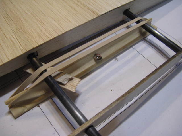

So far just over 3 oz with bottom center and LE sheeting in. I like the weight so far, and this is going to be one rigid little airframe.
I hate LE sheeting.
I hate LE sheeting.
I hate LE sheeting.
I hate LE sheeting.
That's four times, for the four pieces it needs. I have to change that, it is such a total PITA! I have a crafty idea that started festering lately regarding the regular Demon. But the stock method is the one sore point with me about building these. And I'm supposed to like everything about them, right?
