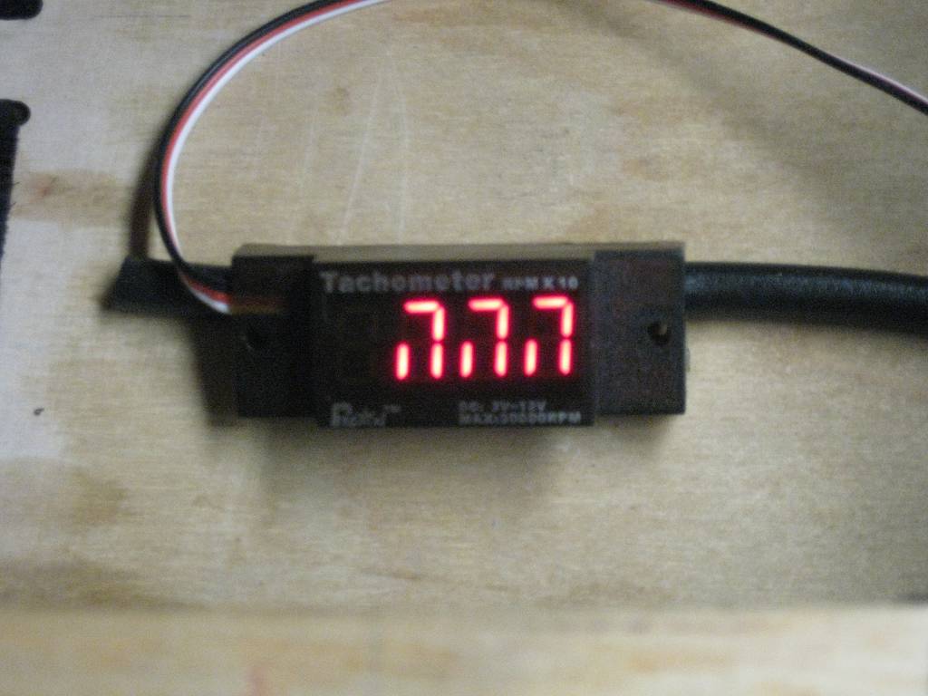

I tried two, neither worked, gave up. The first one is shown below, returned for replacement, the second one read 3 -7's if memory serves me correctly.
