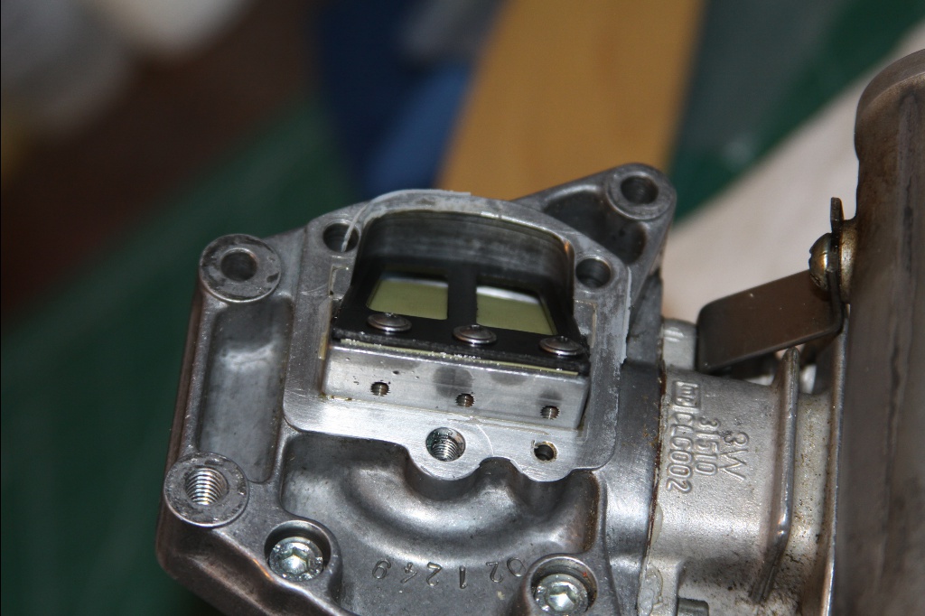

I've had a heck of a time getting my 3W50cc to run....well some 'magic' and it now runs, but spits out a lot of fuel thru the carb when running at full throttle....any recommendations on what I have to do to keep the fuel going in the right direction? Thanks,

Reed valve not seating?

The reed valve blockshould be located under the carb in where that black spacer is located between the engine and the carburetor. Of course it could have a rear rotary valve, but I see no reference to it anywhere so I assume it is a reed valve. I do remember seeing pics of it having a intake stack on the engines before too. The intake stack would reduce the carb spitting a lot by helping to keep the fuel inside more.

I took off the carb again, and pulled off the reed section and I see a reed that is maybe 1/16" above the foam and is very stiff - see pic......is this normal or should the reed be flexible?

the reed should lay flat on the reed block.you could try to flip it over,look for anything on the reed and block that could keep it from laying flat.that is the reason it is hard starting and spitting fuel.

Here is the reed removed from the carb......notice the gap. I tried flipping the reed over, but the mounting holes do not line up - perhaps I should drill some new ones?

I flipped the reed over and it fit perfectly in the carrier, but when mounted, I got that 1/16" gap between the carrier and the reed

Ok the white color thingies are the reeds. The black carrier is used to prevent the reeds from moving up too high. The reeds should lay flat against the reed block that they screw onto. So you need to look closely at the block to see if the reeds are laying flat against it or not.

earlwb, they aren't...so I guess the engine will have to go back....

years ago we would have problems with the reeds in our old johnson outboard motors reeds and just removed them and very carefully bent them until they layed flat on the block. the motors ran fine ,,,later the reed broke and it had to be replaced but it worked for a whole summer.

You don't need to send the engine back, just buy the reed cage and reeds and fit them yourself.
If you don't have the velocity stack order that at the came time.
