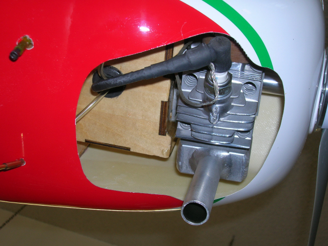

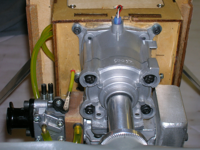

I got the 26cc today and got it mounted. This engine is quite a bit smaller than the 25cc in size so the bolt pattern was off and I had to redrill new holes. The spark plug on the 26cc comes out of the head at an angle unlike the 25cc which is in the center sticking straight down so I had to recut the cowl also. There is only one fin on the head that sticks down out of the opening in the cowl that I cut for cooling and I'm going to leave it that way and fly the plane and see how it works as far as cooling. I have to be at the funeral home tomorrow with my better half so don't know how much I'll get done and if I get to fly it this Sunday. The 26cc looks really small compared to the 25cc ..... sure hope it pack a good punch .

The firewall doesn't seem like regular ply to me, it's very soft when you drill through it. I am also a little concerned about all the vibration and how it will hold up. Scott sent me some "Brillelli" decals along with the 26cc engine and they will be on for the next flight .

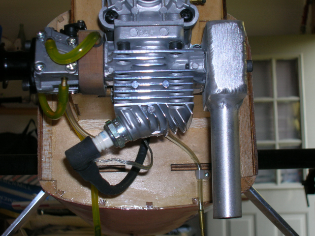

I got up early this morning so I could test run the new 26cc engine on the Giles 202. There were a lot of changes to be made to get eveything back in running order but nothing the average flyer couldn't handle. I checked the settings where Scott had it and got ready to fire it up. 30 min. later it finally started. Not sure what the deal was, it would pop a lot but wouldn't start. It had a good idle at around 2200-2500 rpm and with the APC 17X6 prop and I tached it at 8300 rpm on the top end. I shut it off to lean the high end about a 1/16 to see if I could gain a few more rpms but never got it started again. I worked on it for an hour trying different things but no luck. It would pop from time to time but it wouldn't start. I'll have to wait a few days until I have the time to play with it again. I was going to try and fly it late today but looks like thats out. Scott, what is different about the 26cc over the 25cc in starting??? The 25cc was easy to start but I haven't figured this one out. I know it's not the engine, it ran good when it was running. It's just me again [:@]. Scott sent me some of the "Brillelli decals and they really look good on the plane.

I couldn't stand it not knowing why I couldn't get the little 26cc engine fired up so when the wife left to go to the store I went back out to the garage and tried again. I opened the throttle, stuck my finger in the valosity stack and ran the prop over just three times and on the first flip it popped. I took about 10 more flip and it started. Looks like this engine is very easy to flood. I just wanted to post this so people didn't get the wrong idea. These little engines are power houses for their size and very high quality. Looks like I need to fine tune my starting skills for this engine.

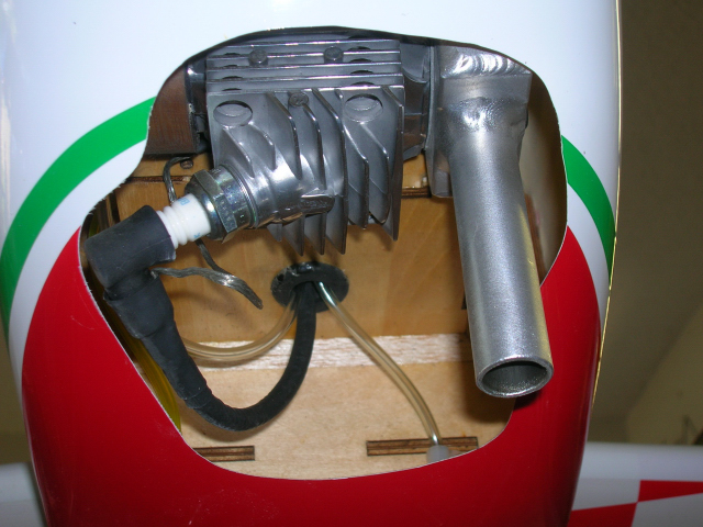

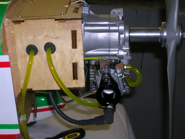

I'm using Hitec HS635's everywhere but Rudder - I have a Digital HS5625MG there - but I have noticed it has a little play when centered, allows the rudder to move enough to see 1/8th inch deflection at the front of the V-stab. I'm thinking I need to replace it before flying, and send the servo back to Hitec for a checkup. Probably just get a 645 from my LHS.
Zippi - am I correct in understanding you had the 25GT on that plane, and now have moved to the 26? It doesn't look like you used any standoffs on the 26. The 26 is a shorter motor - did you just slide your cowling farther back on the fuse? My measurements say I need like a 7/8ths inch standoff to get the prop hub where the CMP instructions say it should be.

RE: Brillelli Boyz
adrenalnjunky,
Yes, I had the 25cc GT on this plane and have swithched to the 26cc SS. I bolted the 25cc GT right to the engine box and ran bolts from inside the engine box through the threaded mount. The 26cc engine was a little smaller and had a plate bolted to the back side and the distance from the engine box to the back of the back plate on the spinner was the same. Just mount your cowl so you have a 1/16 gap between the cowl and the spinner back plate. Mounting the engine this way the CG came out to the print which is correct. You might run a few tanks through it before you fly. They gain power with more run time on the engine.

Here is the Brillelli 26cc SS engine installed on the GSP Giles 202. Someone had ask about stand offs and any mods. There were no stand offs used as you can see. The distance from the engine box to the back of the spinner back plate is 4 13/16" and that gives you about 1" of the cowl to slip over the fuse. With all the mods I made with the CapX gear, no stand offs, Hitec HS-645MG in the rear and HS-635 on the ailerons the CG came out right on the money to the print. The cowl will slip right past the Velocity stack on the carb. These little 26cc SS/EI engines are packed full of power and will turn an APC 17X6 prop around 8700 rpm right out of the box. Tunning the engine was a little tricky for me but with a little hard work I think I've got it along with the fine support from Scott at Brillelli engines. Nothing like having someone to talk to when you need help with an engine and the boyz at Brillelli are top of the line when it comes to customer service. Not able to upload pics at this time because of the server at RC Universe but I will later.
