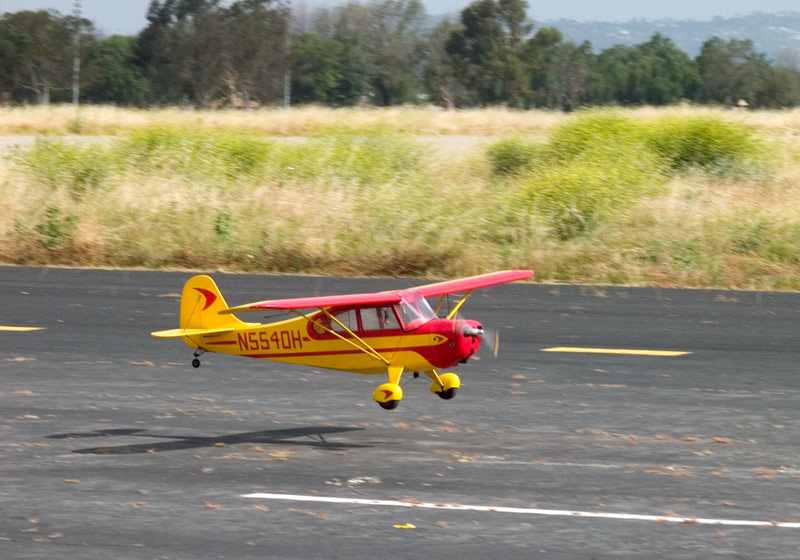

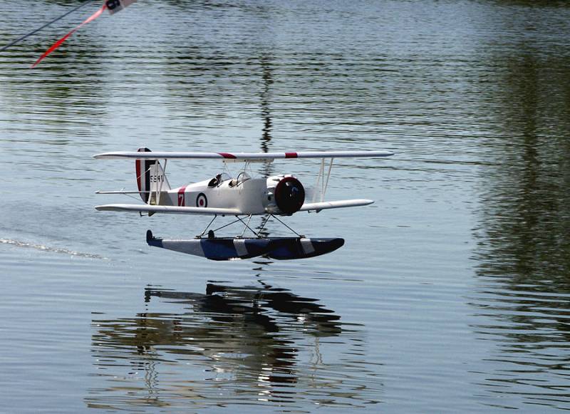

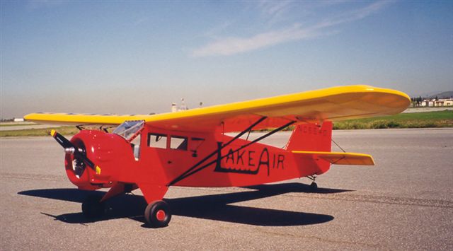

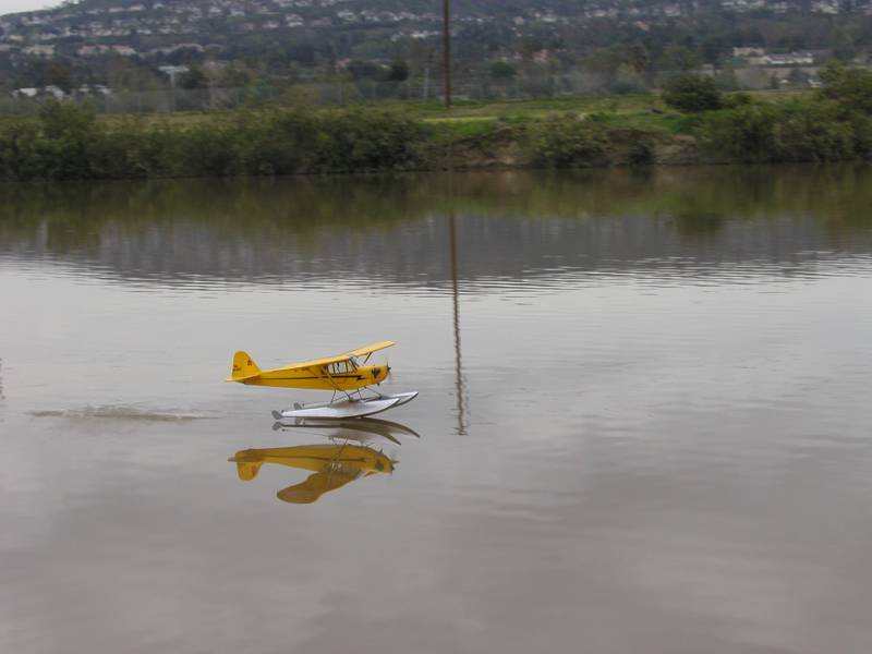

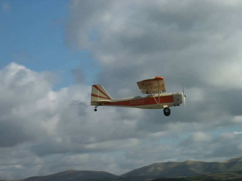

2Slow, If you keep the weight around 13 lbs. the plane will fly just fine, no 3D but good solid loops, rolls, etc. In my group there are many Zenoah G23/26's flying planes that range from 11 to 16 lbs. The only thing we change on the engine is use a very free flowing muffler. These engines respond well to a good muffler. All of the planes pictured have an 80+ wingspan.

Thanks for the post and pics, I love those water shots! It shouldn't be a problem to keep it under 13 lbs.
I will definitely have to change the muffler eventually. Maybe to a bisson. Right now it has the stock muffler. I take it that muffler is too restrictive?
