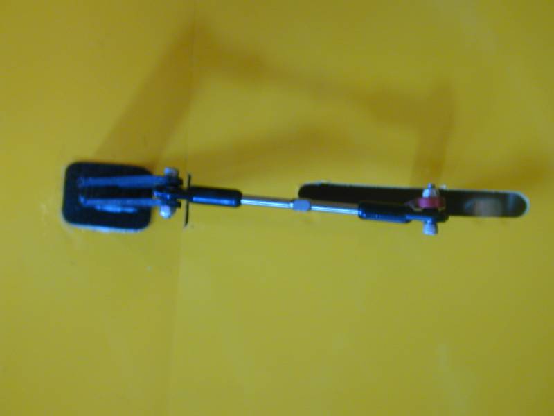

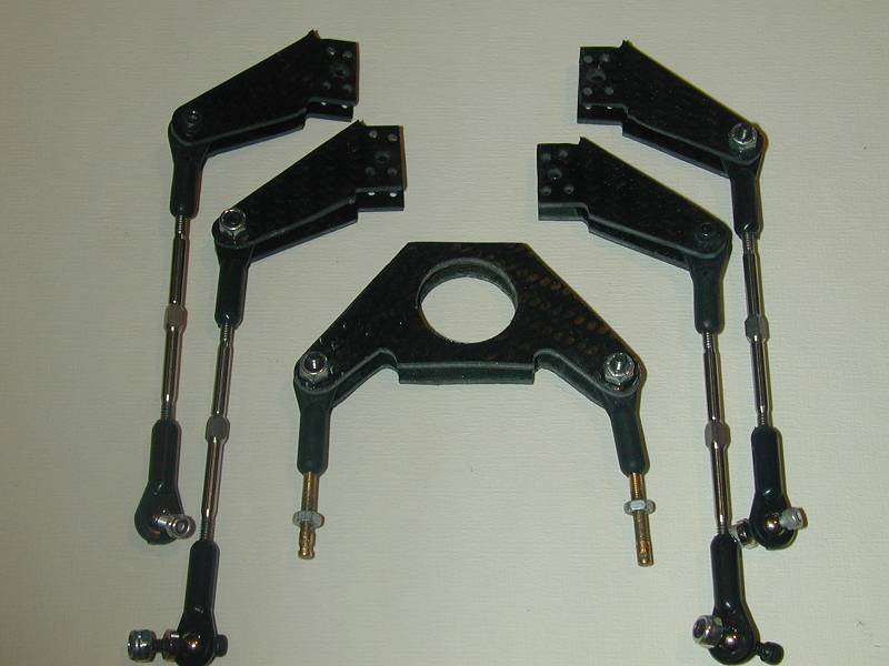

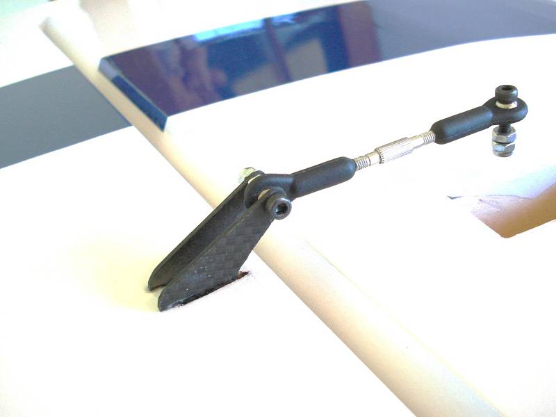

I have been asked on a few occations where I obtained my dual carbon horns, well I made them myself and I thought if there was any interest I would do a make thread (cant call it build thread now can I)

As there is intrest I will just to give you a taster, there is nothing fancy about these, no CNC machines just basic modeling equipment, and some power tools to make it easier for me, this can all be done with hand tools if needed, due to the time difference between the UK and US its 2445 at the moment and I am going off line, will post more tomorrow, perhaps get the whole process done in one swoop and a couple of posts, but only if the power is on, had a 14hr power cut here today, big anti cyclone in the UK causing lots of problems.

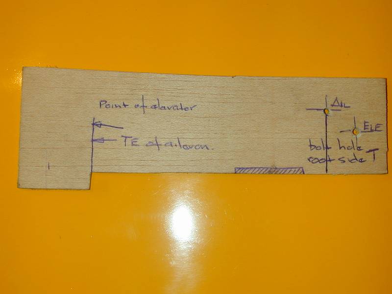

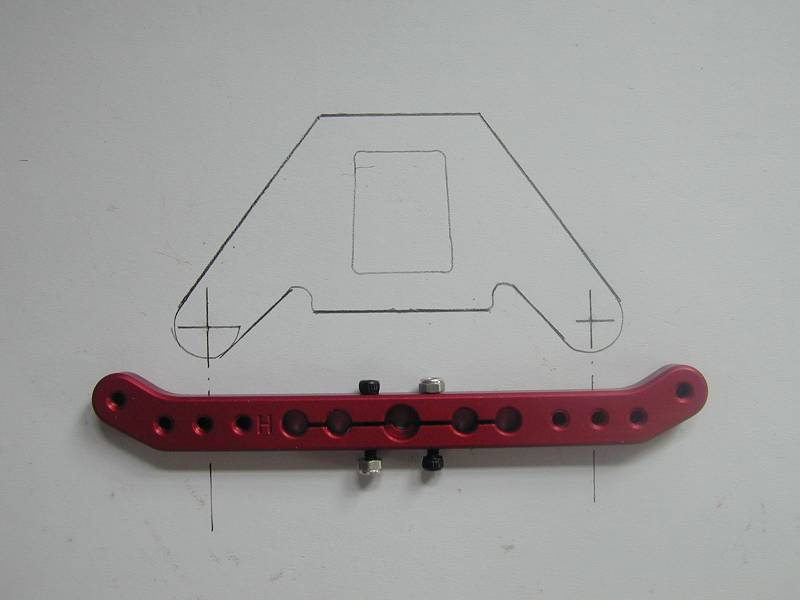

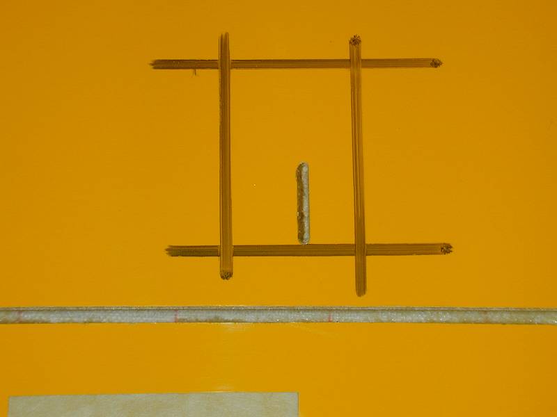

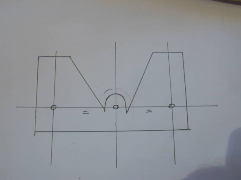

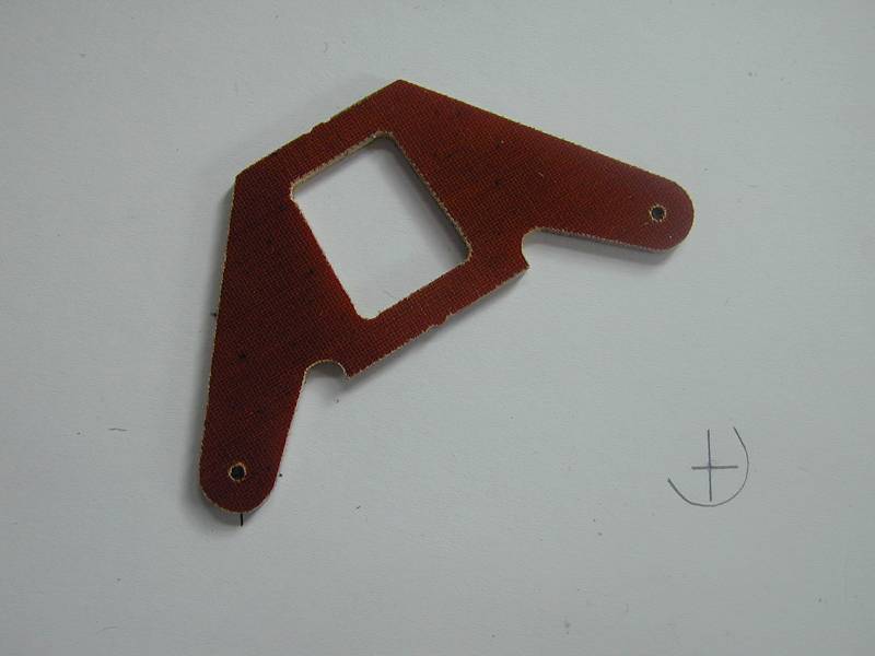

The first thing to do is dertermine if your wing/tail/rudder structure can take the extra width of two horns within the original horn mounting block, if you shine a bright light behind the moving surface you should be able to see the horn fixing block through the wing surface, lightly mark this with a soft pencil or water based marker, from this you should be able to make up your own mind if the fixing block is big enough, if not there are various ways to increase the area, which I will go into later.
Next is to determine the position of the dual horns on the surface, for this you need to have your servo horns sorted and preferably the servo in its final position, you will aslo need to know if you are going to use ball joints or clevis to connect to your servo's this will determine the line of the push rod and the positioning of the dual horns on the surface, although a ball joint will accomadate some misalignement, this error is so small I consider it worth ignoring for the convenience of using the original slot for fixing the horn in a composite surface.
Mike

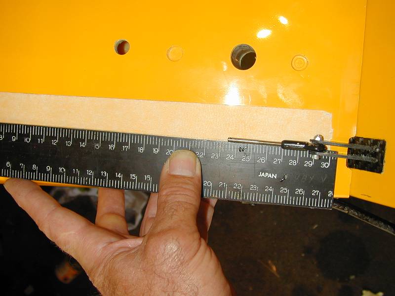

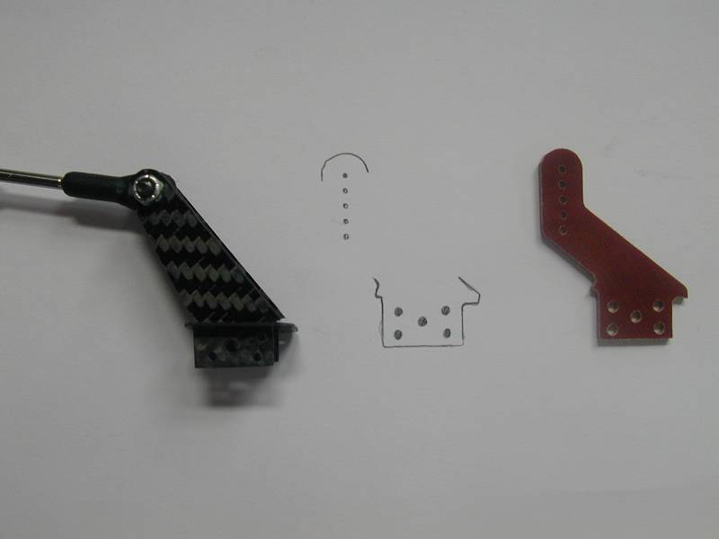

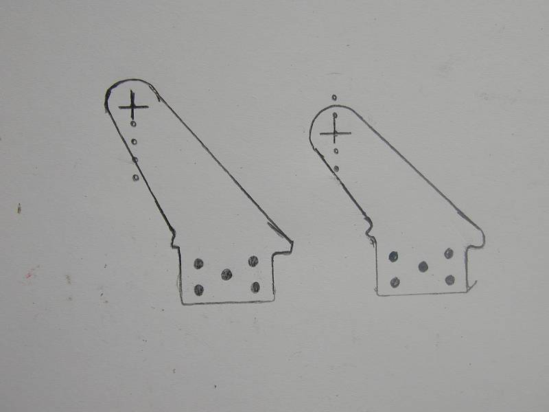

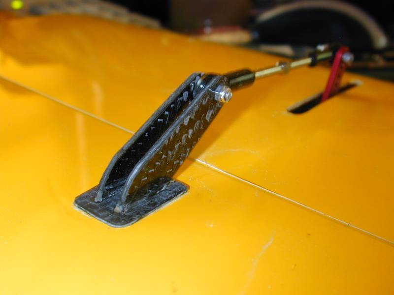

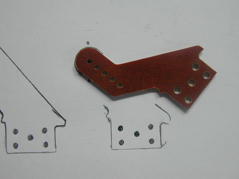

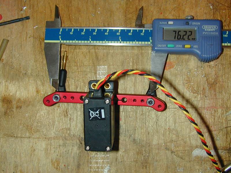

It may not be out of place to explain why I do this. Most Composite planes are supplied with what is incorrectly called Phenolic Horns, I say incorrectly as Phenolic is a process and not a material, therefore it is impossible to determine what the original horns are made out of, the first plane I did this on was an Xtreme Composite Edge 2x2, I just did not like the lack of stiffness of them, the next one was a Composite ARF, these horns where in my opinion diabolical, they even came with a warning not to use ball links as the surface would flutter and the horn would break????????? Having now applied a stress test to both of these manufacturers product (give them a good bend in your fingers) the Xtreme Composite will take twice as much abbuse than the Composite ARF, they are also darker in colour and much stiffer and may be able to take a ball link in standard form, although I would not trust them on one of my planes.
Onward:
Next in the line is to source your materials, the way I make mine is with a cover plate too the slots to tidy up the area where you normally see a glue line, this in turn means an extra sheet of material, I use 2mm (0.077") and 0.75 (0.030") carbon sheet obtained from Carbon Copy in the UK, this is a very high quality carbon glass composite sheet, I will find a link and post it latter.
Next how much movement do you need on each surface, you need to know so you can determine the length of your servo arm and horn length, if you are doing this on a 3D machine you will have a long servo arm and possibly a short horn, to get the maximum resolution from your servo's do have the shortest servo arm you can use, even cranking up the ATV too maximum to allow the shortest arm possible, once you have decided on your horn length mark this on a piece of paper from the bottom surface to the hole in the horn using the original horn as a guide, draw around the top and bottom of the oringinal horn to give a rough outline join up the areas and you have your template for the first horn.

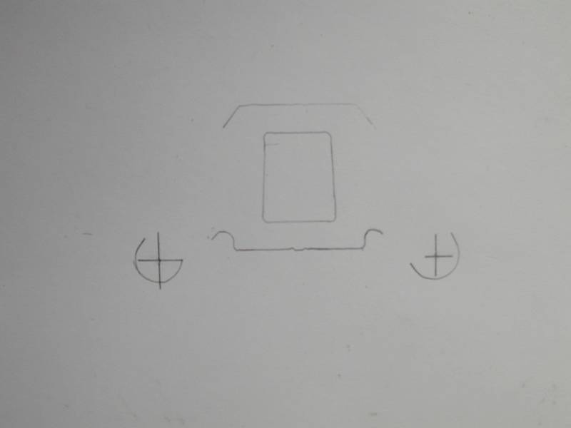

We now have to do the same procedure for the rudder, I have found that on the ones I have done the servo arm supplied does not match the rudder horn supplied, so you will need to make the rudder horn to match the servo arm you wish to use. Using a similar method to the horns already done make a template for your rudder horn, thats the easy bit done, now on to the cutting.

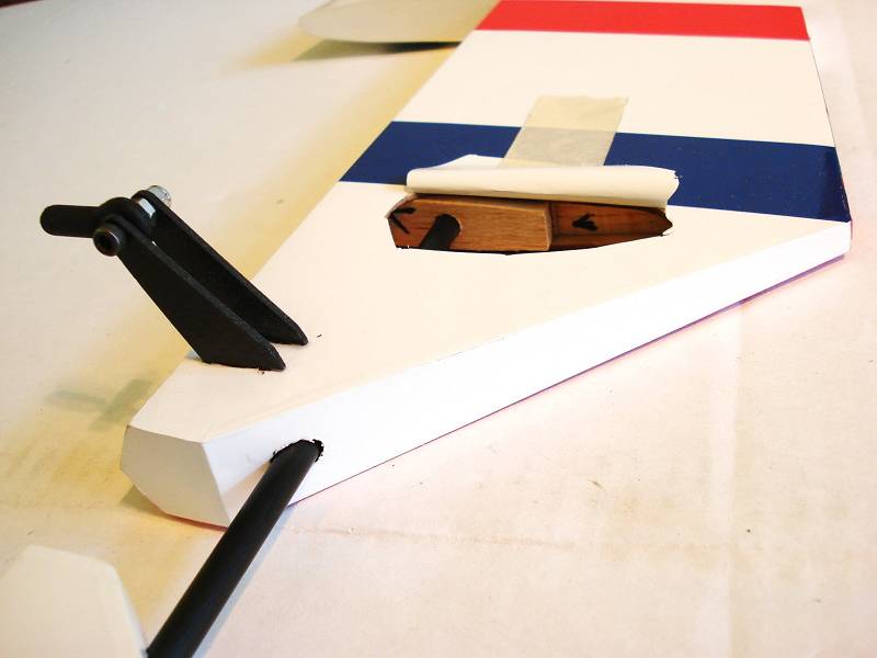

I like your horns. I usually do the same where ever I see a need for it. I just recently replaced the G10 horns on my Yak with my own, home made CF horns. I have not installed the backing plates, yet. I don't even know, if I really need them. The footing of the horns are so deep into the control surfaces I think it is almost redundant to put some over the horns. I use a special CF sheet we use in our company to manufacture roll scrapers from. It comes in long strips is about 4" wide and approx. 1.4mm thick. Super strong stuff. I use a small abrasive cutting wheel in my Dremel, cut out the rough shape and finish it on my belt sander. Then they are bundled together and drilled in a block at once. That way all holes are in the same position. Fairly easy and quick way and they look really cool[sm=shades_smile.gif]

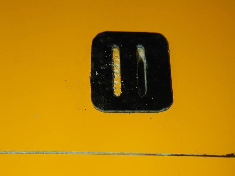

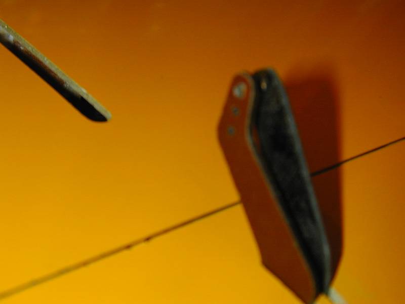

Nice to see someone else's, the cover plates are there just to hide the ugly glue line you get with a different colour surface, on a white surface like you have the epoxy microballoons will not show up so much, I suppose you could add some food colouring to the mix, but I don't know what that would do to the resin.
First a warning:
Carbon dust is carsonagenic it can and will cause Cancer growths so only cut this stuff in a well ventilated area (outside) and use a particle mask sutiable for carbon dust, being an old full size glider pilot I still have my oxygen mask and bottle, may seem like overkill, but if they are available why not.
I use a band saw to rough cut out four blanks, one of these blanks then has the template stuck to it, the first thing to do is to drill the holes into the blank at the position marked on your template, this blank is then more accuratly cut to line on a scroll saw, using this as a drill jig, drill three other blanks in a pillar drill to get accurate aligniment, ensure the drill used is an interferance fit for the bolts you will use to attach the ball link in this way you can bolt all four blanks together without using a nut on the underside which would stop the block of horns being laid flat on the scroll saw bed when you cut the bolted unit too a more accurate line. Then using a belt sander as theviginian or a bench grinder as I use sand or grind the whole unit to the outline of the original template. Obviously when doing the rudder you only need to make two. The reason for doing four at a time is to ensure the wing or elevator horns are all the same shape. Whilst you have all these bolted together drill a few more holes in the bottom of the horn where it will be inserted into the moving surface, this is to provide a mechanical link through the horn with the microballoon mix to the fixing block.
Next temporaraly put one of the horns into the moving surface and check its positon and if you can get full throw, if your cutting is not that accurate you may need to elongate the slot to provide clearance from the wiper part of the seal.
Bolt two of the horns together with a ball link between to establish the size of the cover plate if you are going to install them, this will also allow you to determine the space needed between the two slots, lay the bolted horns on the surface and mark the second slot position, alternatively use the cover plate. I use a Permagrit pointed file to mark and make the second slot, digging out the bits of the original block with the file, be carefull not to go through the top surface of the wing or tail.

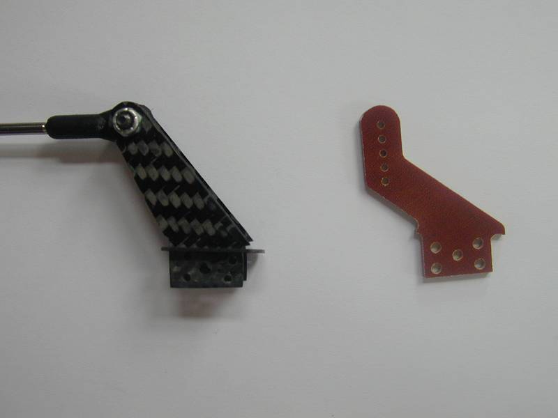

Make up template to align your horn at a right angle with the hinge line of the surface, this is to ensure perfect alignement of both sides, with a top hinged surface this is fairly involved, but non the less needs to be done accuratly.
Once your second slot is cut you can put one of the original horns into place against one of your new horns to check the alignement, thats assuming the original slot is in the correct place. If satisfied with the positioning, tape the cover plate into position and cut around the ouside line to remove the plate, this allows you to roughen the area where the cover plate will be glued and to load the slots with microballoon mix without covering the rest of the plane wing or tail with glue.
Mike

Mike,
Can you provide more detail on the installation of the rudder horn? I think I know what you are saying regarding "what I have done is to open up the area between the two rudder horns completly to make a big slot and inserted a balsa former above the top horn"
However, I want to ensure that I have this right... I am planning on making a set of these for a Xtreme Composites 2.6m edge and I want to ensure that I get it right...
Thanks!
CCDave is offline
Old 04-01-2008, 04:25 PM
BaldEagel
BaldEagel's Avatar
Join Date: Oct 2005
Location: Kent, UNITED KINGDOM
Posts: 9,651
Gallery
My Gallery
Models
My Models
Ratings
My Feedback
Default RE: Dual Carbon Horns
CCDave
Once I had cut out the second slot there was no balsa block above the top horn to glue the horn too, so I cut a piece of balsa the shape of a section through the rudder and inserted this into the rudder above the slot to support the horn, this was glued in with microballoons, I then turned the rudder upside down and glued the top horn to the inserted piece of balsa, this was easily accomplished by inserting the glue into the centre hole of the horn, leveling the glue to the horn, I then glued another piece of balsa the thickness of the gap between the two horns into the rudder, once this had all gone off I glued on the second horn onto the new piece of balsa and the original balsa block below that, it sounds more difficult than it is, its a bit messy so have some cotton buds and lighter fluid to clean up the mess with hanndy.
The templeate was easy to make as well, by putting three holes in it, one for the rudder hinge wire to go through and two others in line the horn width apart for the bolts to go into, this keeps it all in line whilst the glue sets, draw it out first and then cut slots in it to allow it to fit inside the rudder hinge point, I think the pic helps to see what I mean.
Hope that helps.
Mike
EDIT: to add drawing of template
